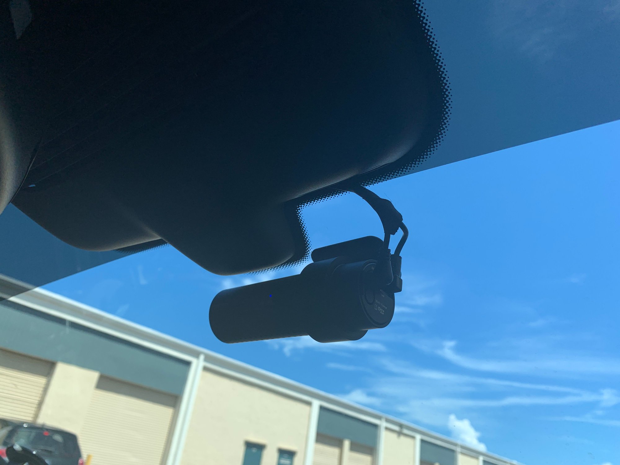

I have attached some pictures, (descrptions are under neath each picture)
One thing I wanted to point out, as I have seen others do this (which is stupid IMO) you DO NOT NEED to cut your window tint !!!
My rear view camera is mounted on my window / tint , and you can see the view from the camera is fine , even at night with the night vision enabled.
(for the love of god, do not cut a hole in your tint , or allow anyone to say you need it)
Outside View (I have LIMO TINT) on all my windows, so its hard as hell to see it unless you are looking for it.
Close up, of harness and placement.
Front Camera from Passenger seat (close view)
Rear View Camera (you really cant see it from driving)
Rear view camera from looking up at it in back seat
Video snapshot out FRONT WINDOW
Video snapshot out REAR WINDOW and LIMO TINT

Looks clean. BTW, regarding the tint, I wouldn't poke a hole in it either for the camera to see through, but how does the camera mount hold up on the tint (i.e. since it's not attaching to the glass anymore)? No issues there at all?

No issue with sticking to rear tint (rear camera is light)
front camera is the heavy one

On the front camera, it would NOT be mounted on the tint strip, as it should NOT be that high up. If you mount it directly under the rearview mirror console (on windshield) it is perfect.

its sticky 3m tape on it.. you just line it up, and peel and stick... I lightly stuck it on the window (enough that it wouldnt fall) then went outside the car and looked at it straight on, to make sure it was in line with the middle of the hood, then push it on real good.
