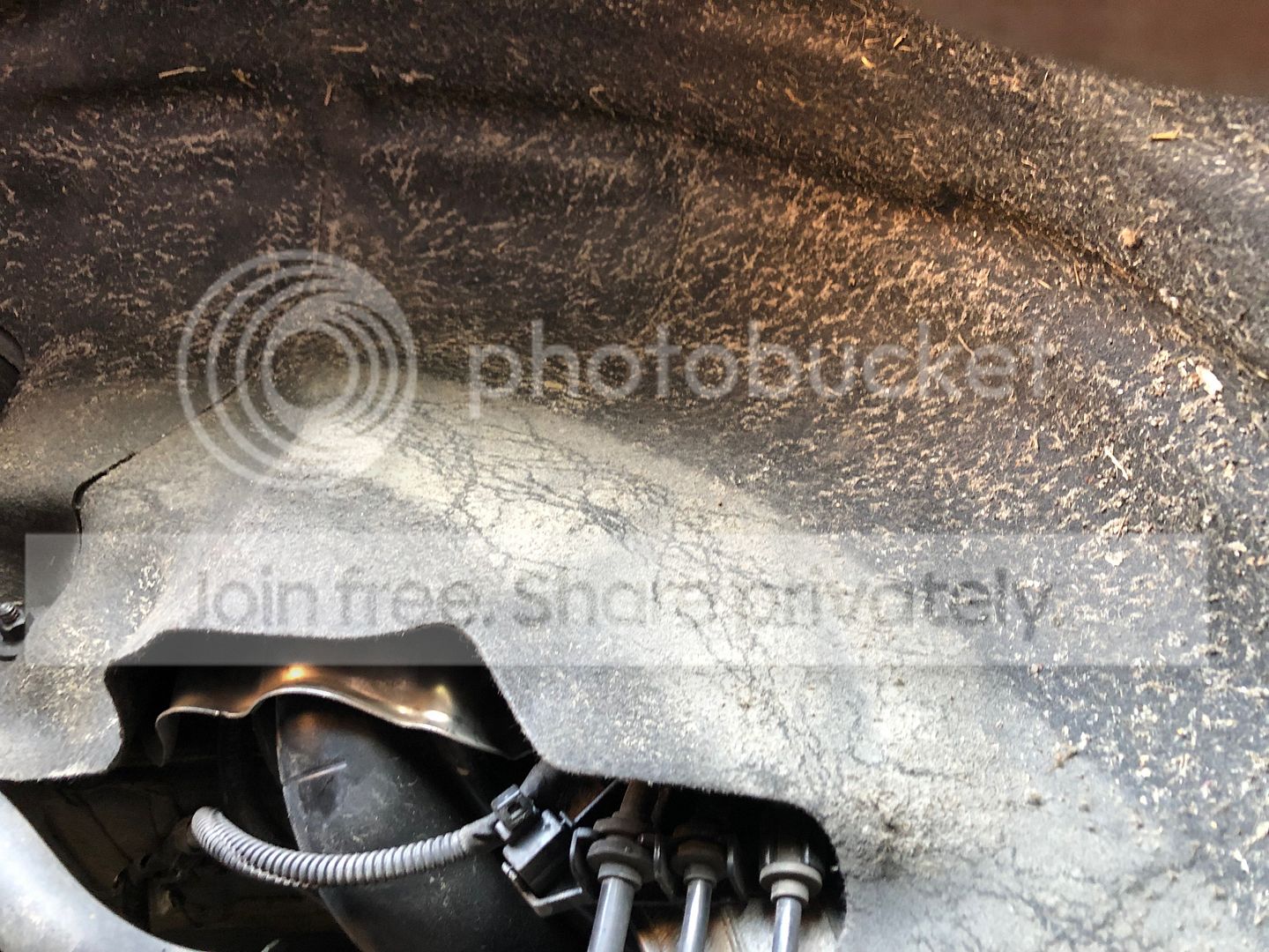

I have some photos , how close the 265 35 19 tires.

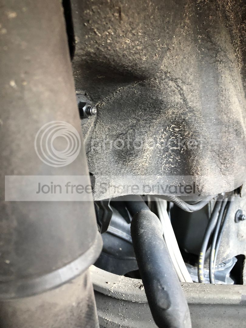

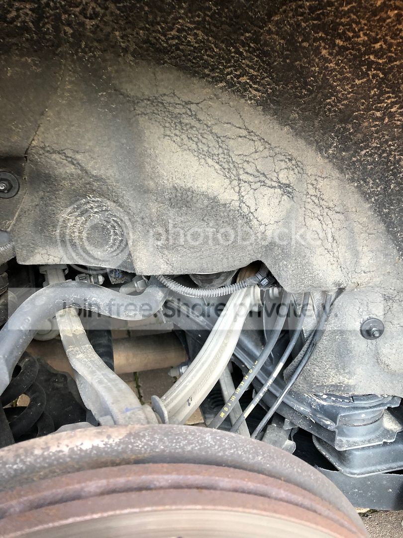

This close only on one point. Looks like the fuel feed hose cover is 3-5cm out from the surface.
I attached photo without wheel.

Is anybody has photo without wheel from the right hand side arch?
