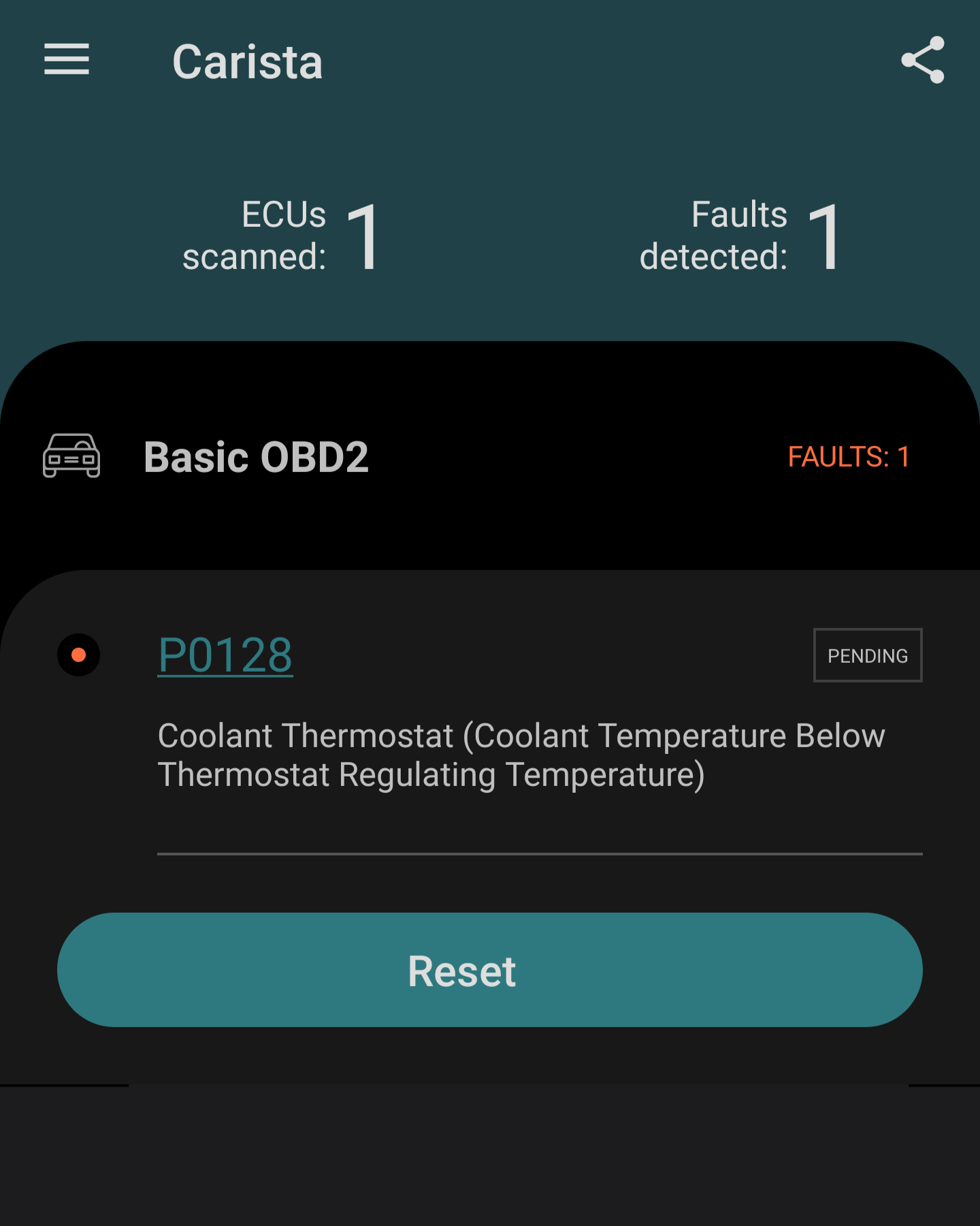

Did you sort this out? I get this exact error code every time I lift the car a bit ie. on a hoist or jack 😆
I clear it and it doesn't come on again or cause any issues that I know of.
What did you end up doing about yours?
UPDATE: Spoke to tuner who confirmed this is purposely set on tunes to keep the car cooler. So if your tuned, ignore it.
