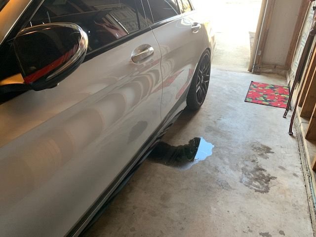

Oil Leak
I am having a oil leak in my car and noticed it is getting worse. I don't have lifts to check it out myself. Dropping the car in the am tomorrow.
No check engine lights or warnings. A service is due in 4200 miles. When parking my car I have noticed a burning smell from the engine. I recently had a local shop fix an ATF leak and had them flush and replace gasket.
The color of the oil is green but could also be turquoise depending on how you look at it (I know that ATF fluid is blue).
I attached two pictures to give you an idea of how it looks. Any thoughts? I am lowered on HR VTF so I could have banged into something on the road.

By the description of the color, I think it might be your rear differential or the driveshaft. If it were your tranny again, it would be more redish in color.

You can’t notice in pics, but when I looked under the car it seemed to be coming from the front right of the car closer to the passenger side.

It could be a leak from the reservoirs.

Looks like coolant?

Taste it or smell it. Really. Is it oil or coolant? Oil smells like oil. Antifreeze is the same way. Any idiot lights showing on dash?

Where is the windshield fluid tank?

Close to the firewall, left hand side. That's a good guess. I had two windshield wash tank fitting fail on my previous 09 BMW 650. It happens.

It was the ATF. The first mechanic I went to did not replace the bolts holding the pan so it leaked again.

Just an update, oil has not leaked since. If any of you have to replace gasket, ask your mechanic to also change the bolts.
