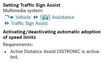

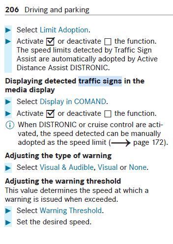

Yes, it recognizes the speed limit signs and automatically adopts that as the speed for DISTRONIC. It's a feature, but it can be disabled under the vehicle assistance settings. I have it disabled as I find it unhelpful here in the USA. It was really helpful to avoid speeding tickets in Europe during my ED trip, though.

You are welcome. BTW, even if you disable it, you can at any point press Resume to manually adopt the current speed limit. I find this useful to initially set DISTRONIC to the current speed limit and then increase it from there to the typical 10-20 mph over, but it's also a quick way to reduce it back down to the speed limit when the radar detector goes off .
