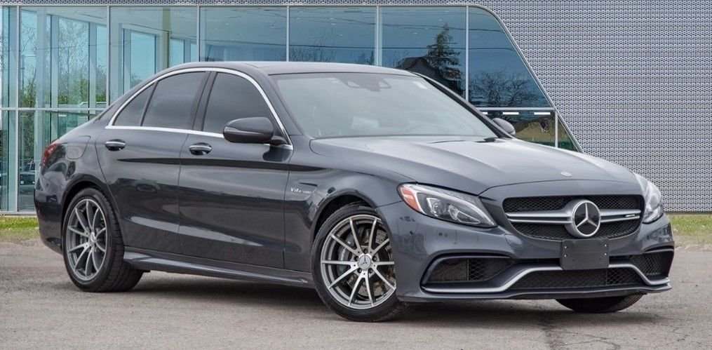

I'm new to the forum and Mercedes in general. I will be picking up a 2016 C63 (non S) sedan on Monday, pic below. It has the OEM 18" rims, and the previous owner put winter tires on them. Since I'm from Toronto (Canada), and we get snow/cold temps, I'm going to retain the 18" as my winter wheels.

Honestly, that car looks like it has been lowered.
See if you can pick up a set of OEM forged cross spoke wheels, They look sweet and they’re fairly light.

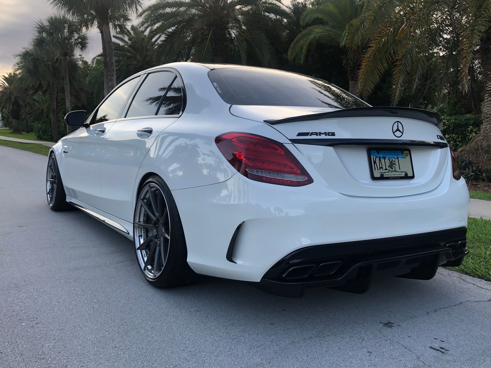

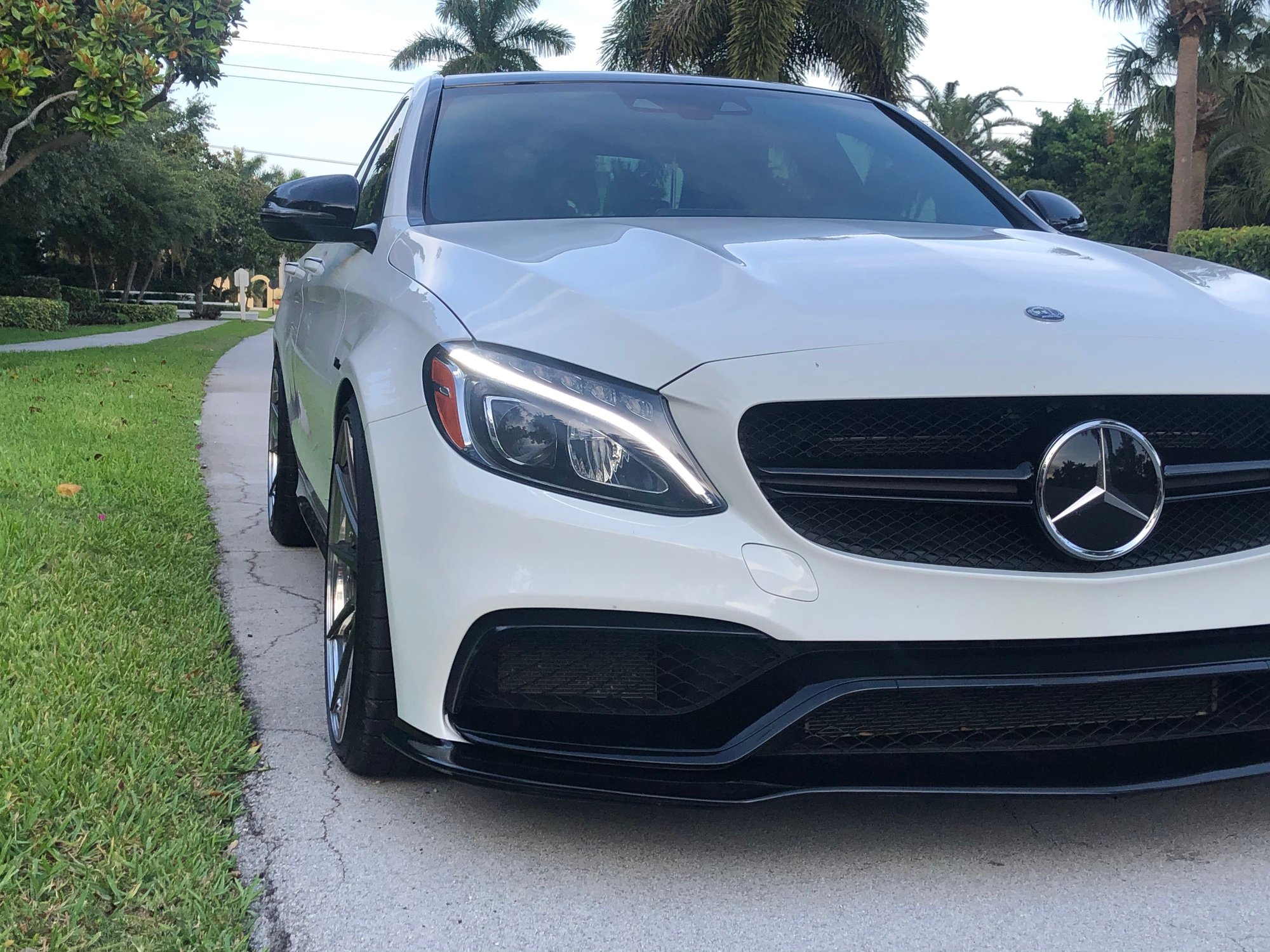

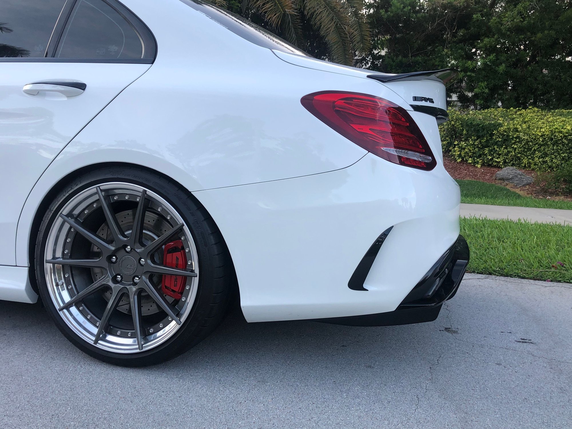

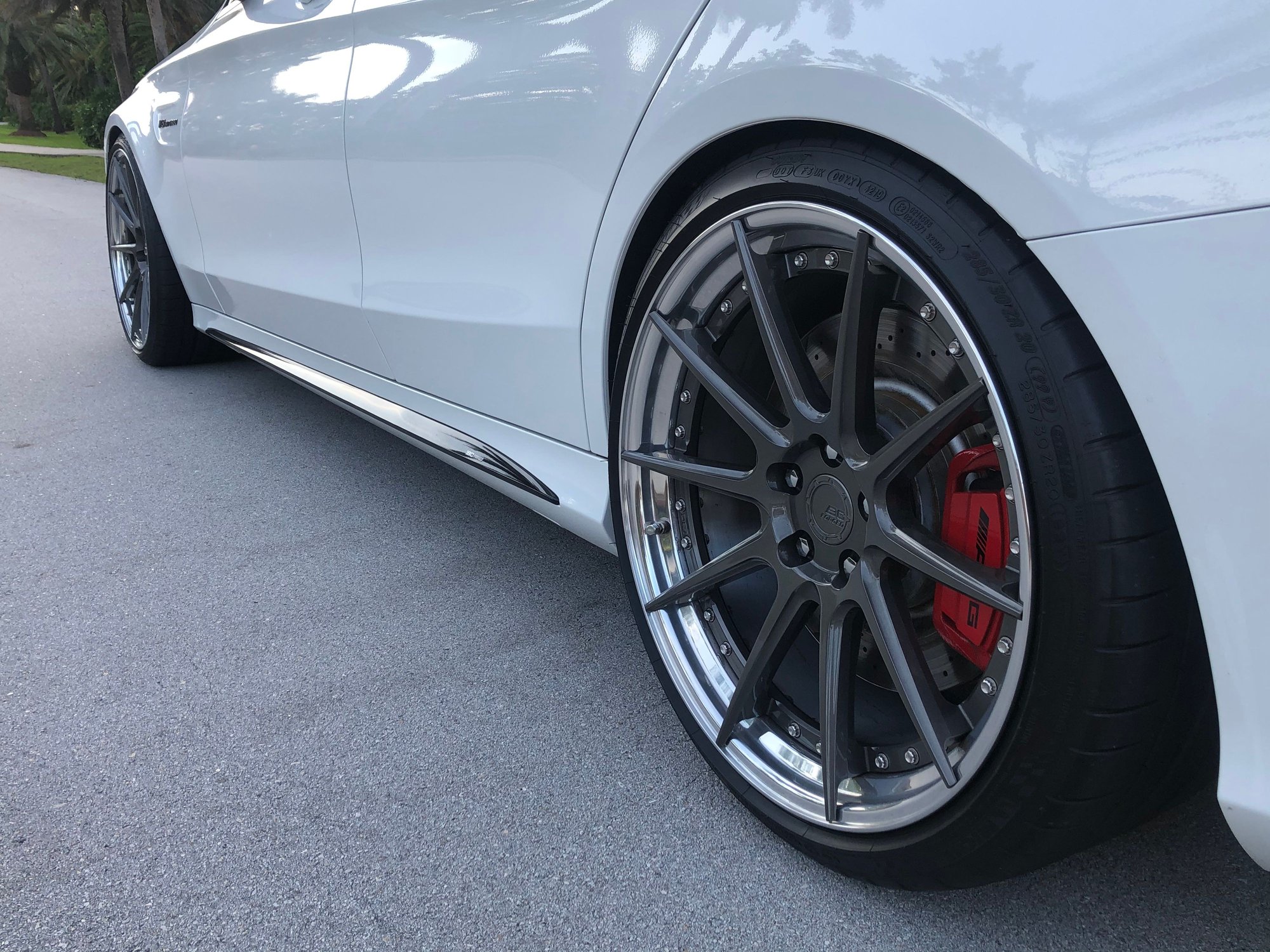

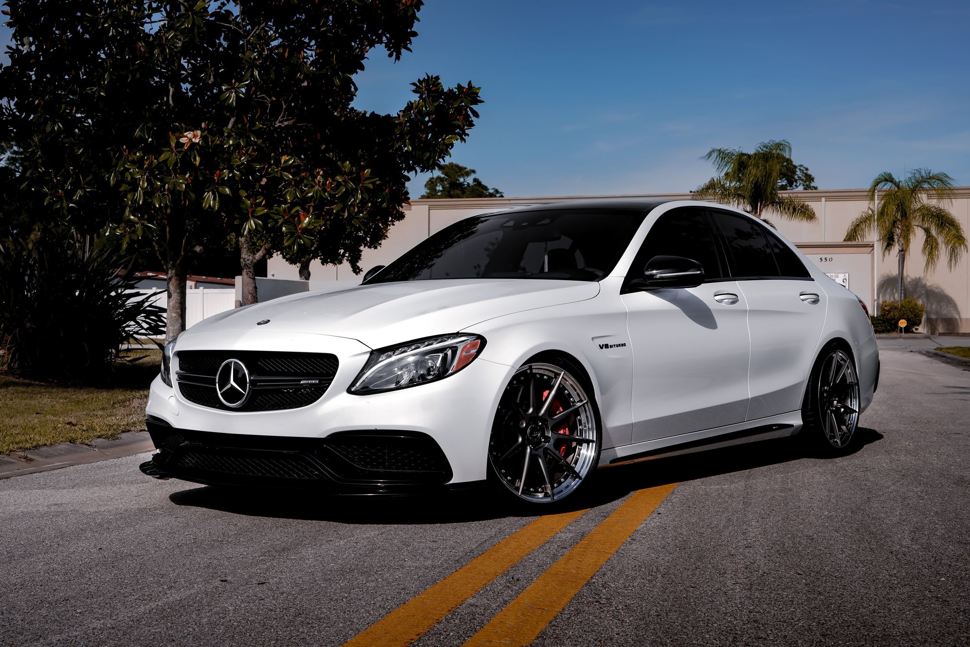

I have 20x9.5 +35 and 20x10.5 +57 on 265/30 and 285/30. Also lowered in KW HAS. It’s not much room left but no rub. I would not recommend the smaller offset Vorsteiner with 295’s. When it comes to wheels...well there are too many brands to recommend - depends what style you like and how deep your pockets are. But for sure I would only pick a forged or flow forged wheel type. I looked a lot around and settled on BC forged but there are many out there. I was going to use Rays/Volk but decided on the BC forged 2 piece.
Front view to show fitment
Rear quarter view to show fitment

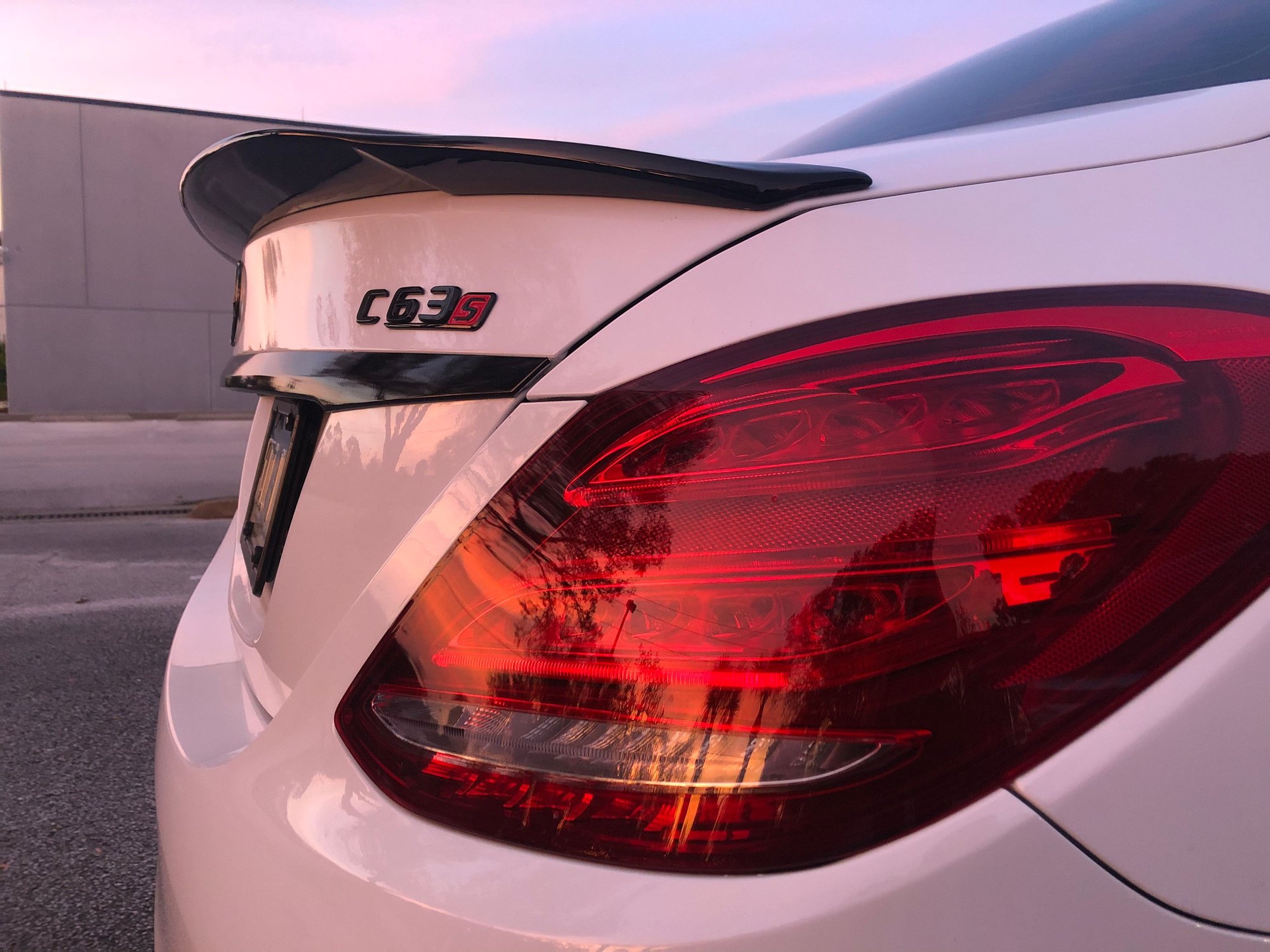

tobeit - what kind of rear spoiler is that? Also, great stance on your car, how much of a drop are you running?
The spoiler is PSM dynamics. Not sure about drop as I did not measure before but after it’s 13.2” front and 13.5” rear.
some more pics
