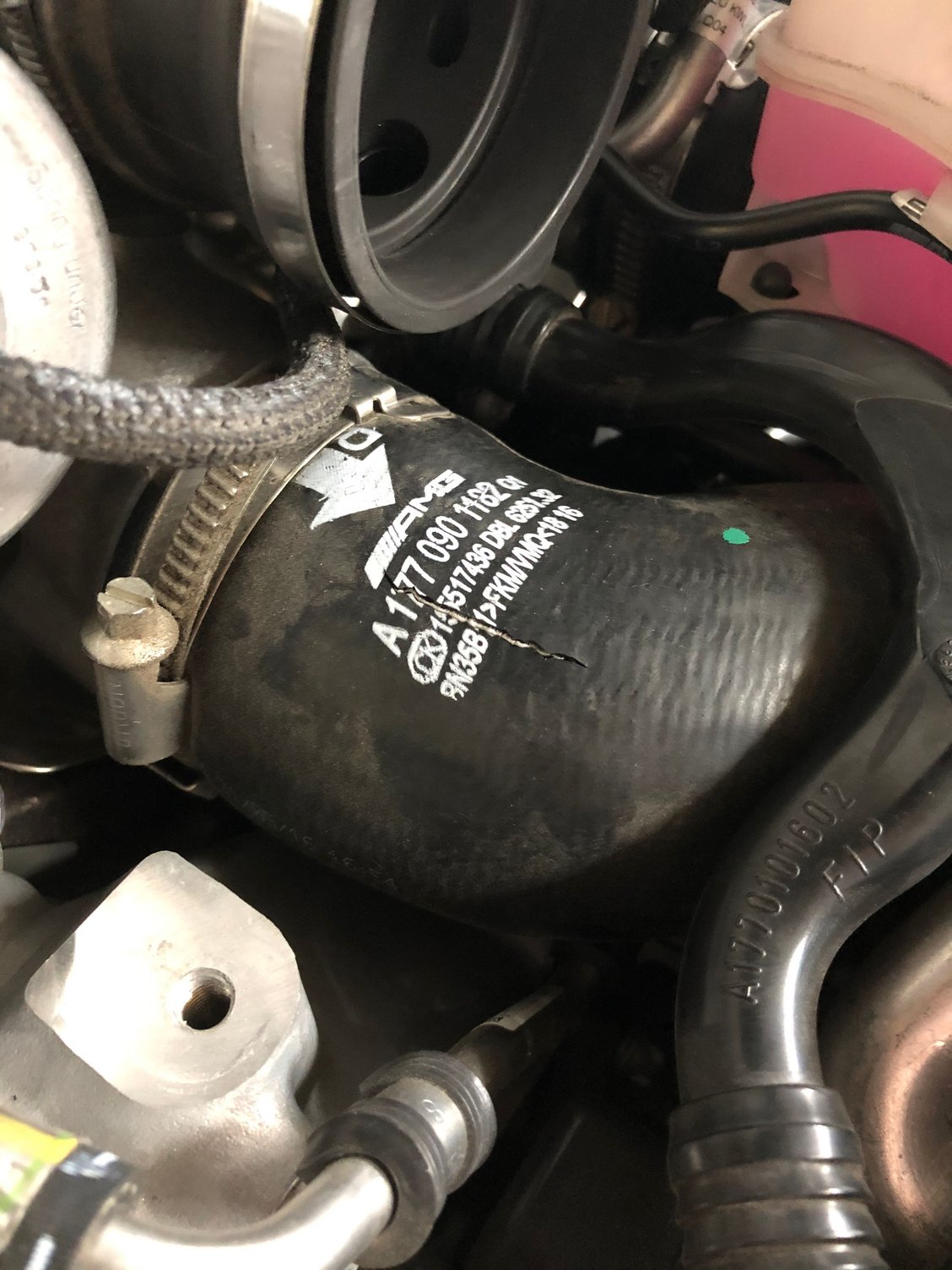

Also, to add, I’ve seen someones hose right above the one where mine is cracked (the hose that connects the intake to the turbocharger inlet) explode and destroy a turbo. I’d replace everything with silicone if it was available.

That hose looks like it burst from too much pressure more than it looks cracked from heat ....note that its a reinforced hose which generally split through the reinforcement threading

This is my worst fear. AMG uses the cheap **** for hoses and ducts, going back to the M157 when my E63 used carpet like material for intake ducts and they were all torn to shreds. They improved it on the M177s going full plastic.

I ran a Dinan tune (no other mods) which adds maybe 3-4 psi on top of the stock boost. A couple pounds of boost above spec shouldn’t tear an OEM hose. Now if I was running 25+
psi on big turbos that would be another story...

Old Aug 29, 2021 | 07:23 PM
tobeit's Avatar
Posts: 1,511
Likes: 424
From: Florida
AMG C63s
Originally Posted by Ghostec15
I was wondering if anyone here ended up installing the Turbomaster Kompact plumb back valve? I have catted HJS200 downpipes and stage 2 tune. I get a whistle/air noise sometimes when I drive a little harder and I’m wondering if getting the Turbomaster will eliminate this. I’m also a little worried about the stock diverted valve after seeing another member’s valve melting
Someone here has done and posted pics.
It's a tight fit under the harness and shroud but doable.
I tried to install the EV version with dual plumb back/vent to air...but failed. For some reason the TS flange did not fit on mine...short of shaving the TS flange I stopped and never went back trying again. Still have them laying around never used.
Old Aug 29, 2021 | 07:33 PM
Ghostec15's Avatar
Joined: Aug 2019
Posts: 28
C63S
Are you tuned? Since, you weren’t able to install the EV version, what did you do instead? Are you still on the stock diverter?
Old Aug 29, 2021 | 08:03 PM
tobeit's Avatar
Posts: 1,511
Likes: 424
From: Florida
AMG C63s
Yes, I am tuned. I am back on stock diverter valves. When you google the consensus is that while these plastic diverter valves are not ideal they hold up plenty even for tuned cars and turbo upgrades. The melted valve incident seems to have been a fluke - who knows what really caused it. Sure, the TS are better valves. Some here also swear you should switch to the vacuum controlled valves and bypass the ECU controls. Again, lots of opinion how much that really makes a change but my guess it it only really starts to make sense when going big turbo upgrade. The mild stage 1 and even stage 2 tunes don't need it necessarily..does not hurt either. JMO
