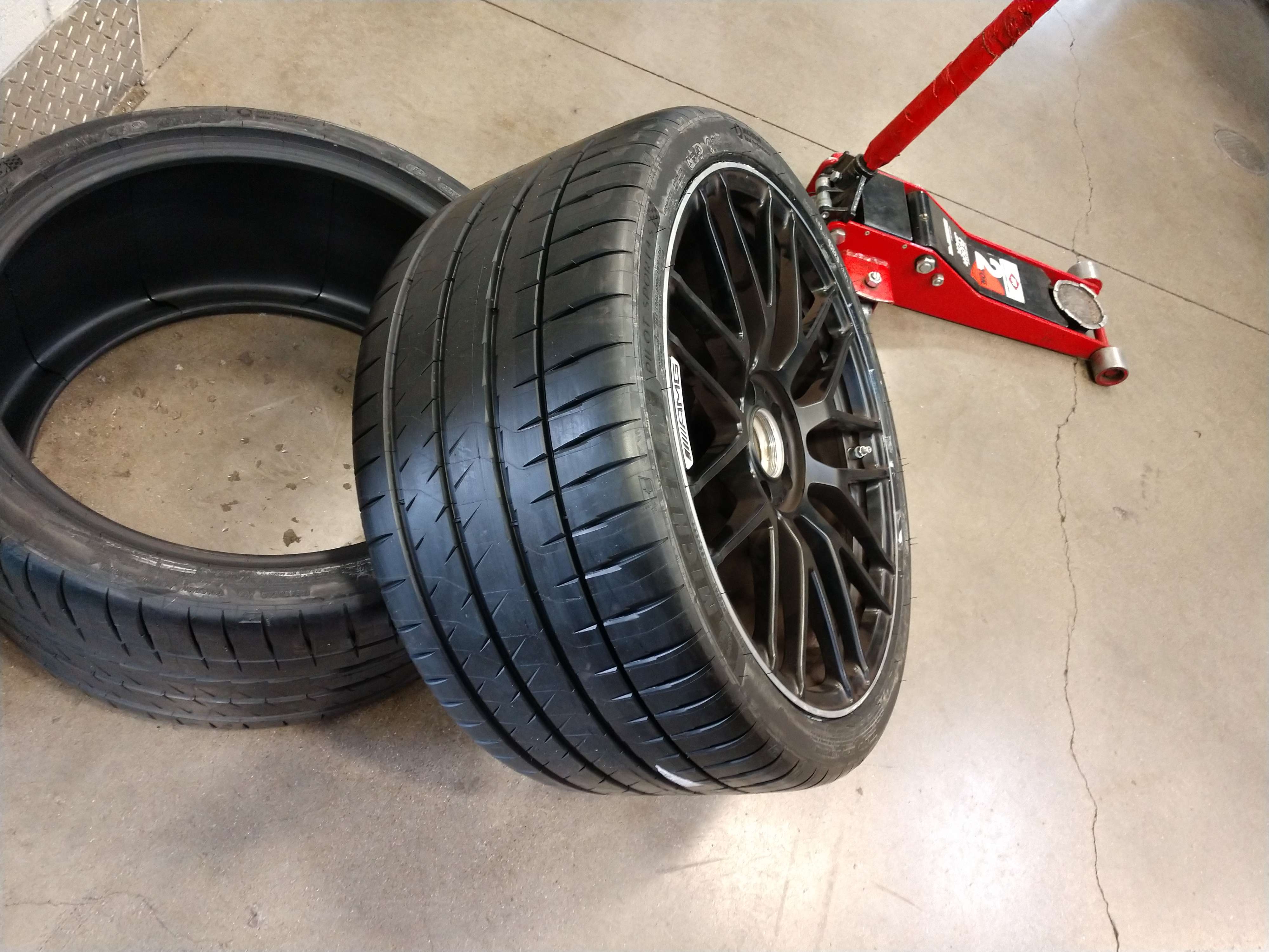

What is the widest tire we can run on the stock 20in rear wheels without the traction control freaking out and the car rubbing?
I am currently running a PS4S 295/30/20 on the rear (stock AMG forged cross spoke 20in wheel) with no rubbing issues.
The 295 is made to fit a 10.5 wheel and fits flush IMHO (see pic below). The 285 stock tire just looked too stretched for my liking.
There are people on MB World running the 305/30/20 tire on the rear and say they have no rubbing issues.
I have personally seen this size tire on my stock wheel and I did not like the look of the slight bulge from the 305.
just my 2 cents!

The "stretched" look is a bit visual and depends on brand of tire (design of sidewalls, shoulder, and actual tire width vs nominal). Michelin's PSS and P4S have that rim protective bulge and in general come in on the "narrow" range aka a 285 tire is technically 11.2" aka wider than the 10.5" rim yet looks a bit stretched due to the aforementioned details of the tire brand and design. 295 Michelins "look" more square on a 10.5" rim but in my case would likely rub a bit (or very, very close) on my sedan setup.
