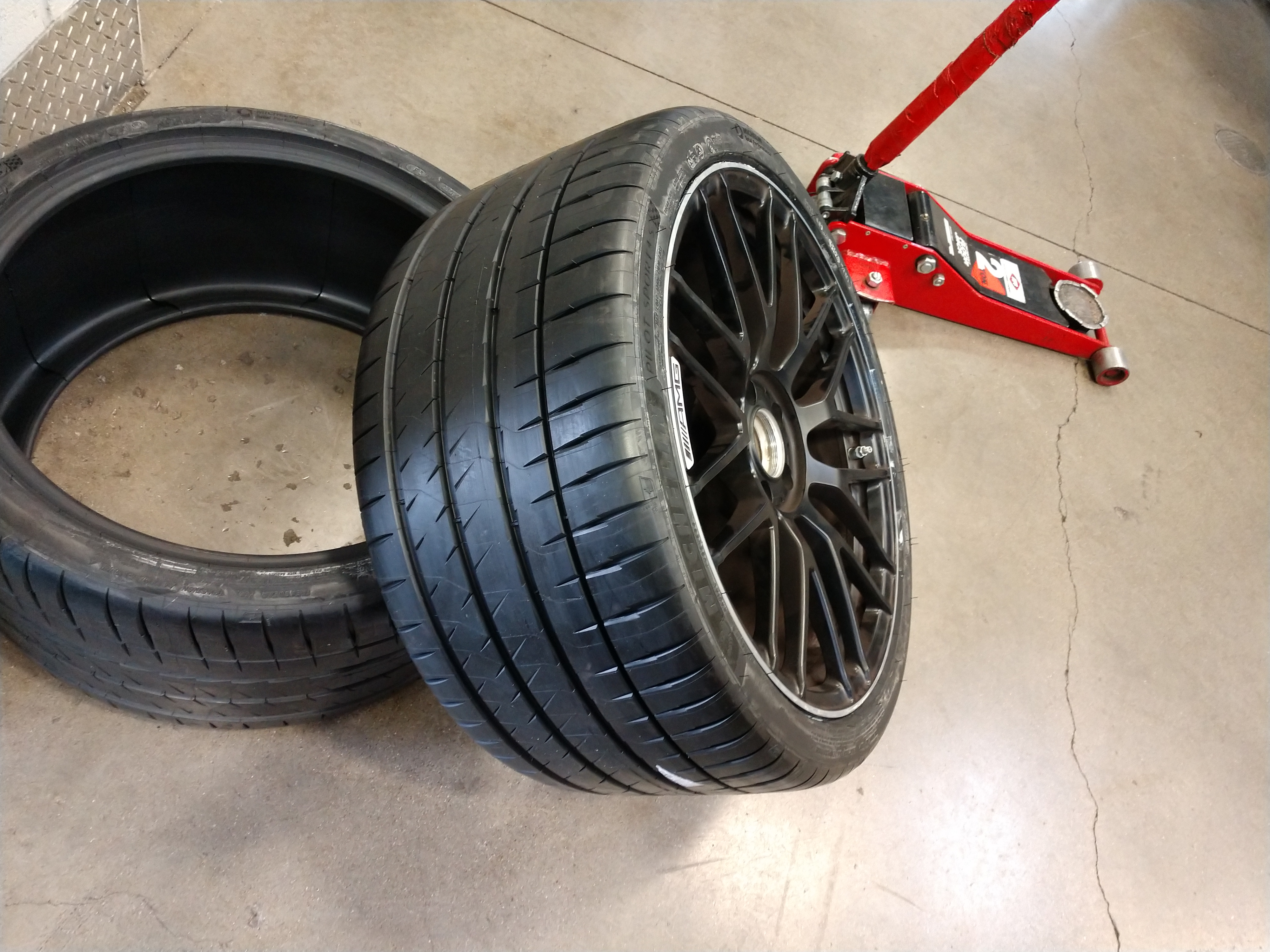

Congrats on the new PS4S...I am running the 295/30/20 on the rear of my 2018 coupe (see comments below)

Originally Posted by BrianShaw23
The 285 ps4s which is out of stock atm, has a tread width of 9.9" compared to 11.1" for the 295, that is definitely significant were you to go for the 295s next time. I'll let you know if I experience any rubbing around hard corners but I haven't heard anything about the 295 rubbing, only the 305 rubbing but rarely.
Regardless of width and grip difference I just never liked the way the 285 sat on the 10.5 in wheel...to much stretch look for my taste. I think the 295 fits the 10.5 AMG wheel perfect and helps fill the rear wheel gap.
Attached Thumbnails Advice on new tires/alignment-img_20191207_100445199.jpg
