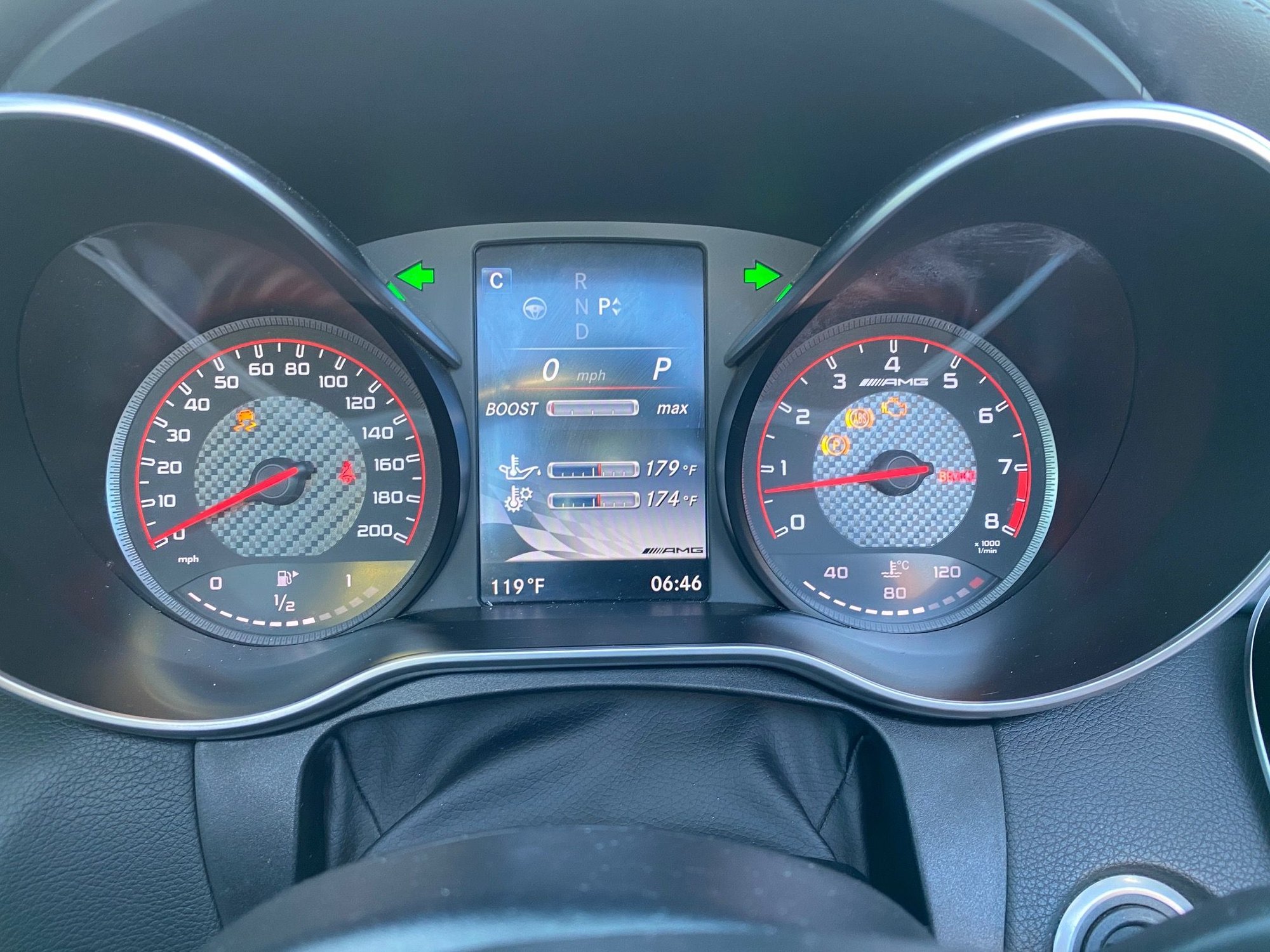

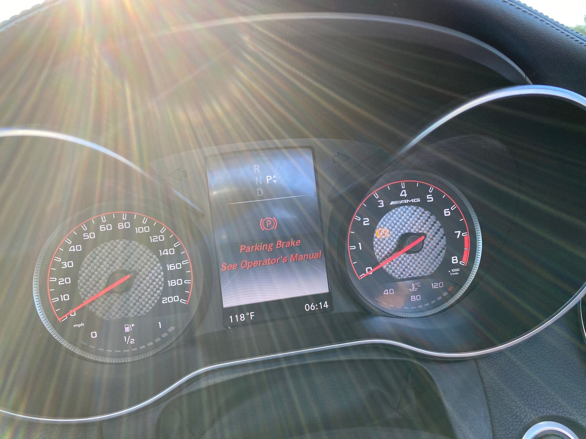

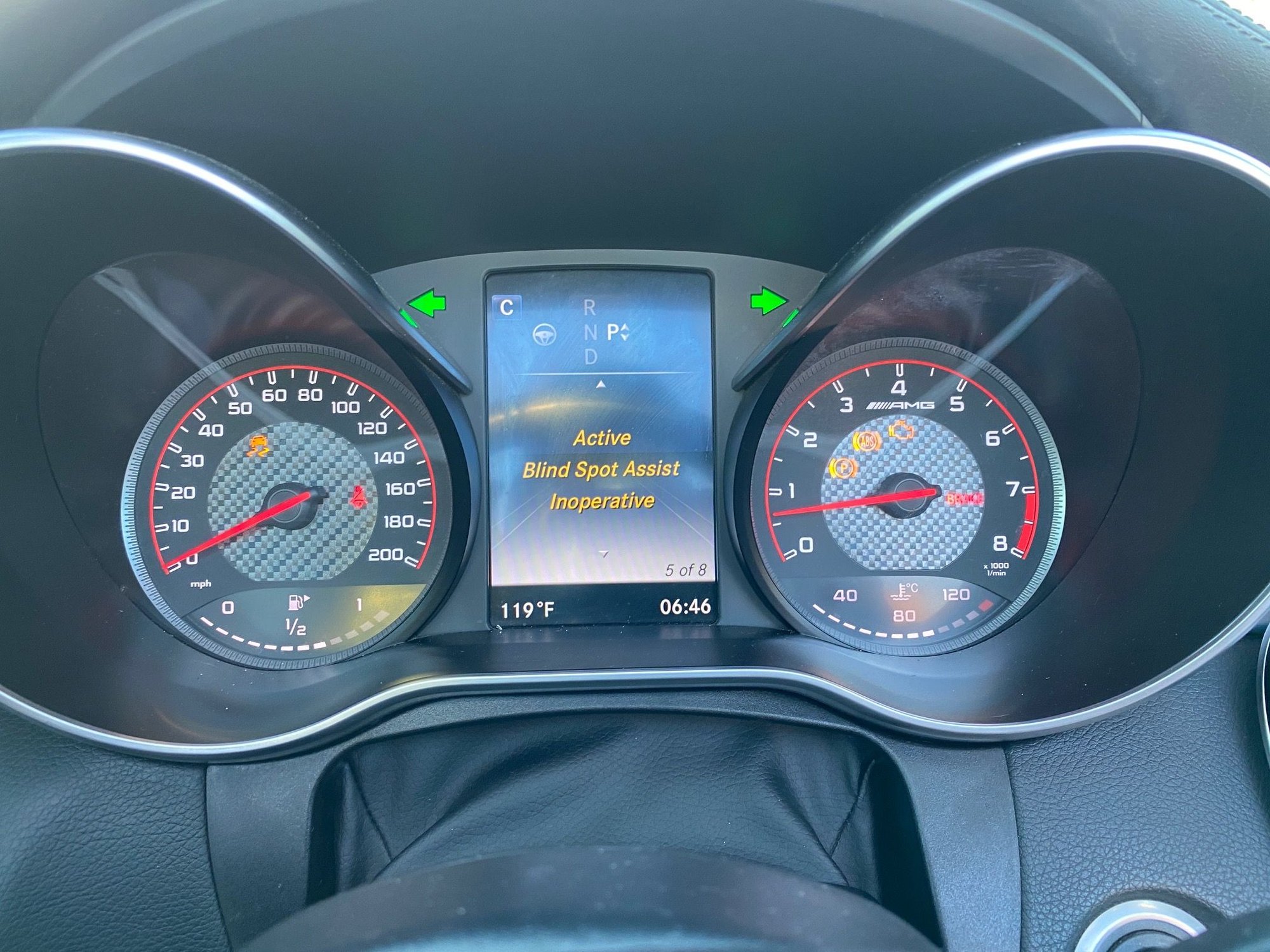

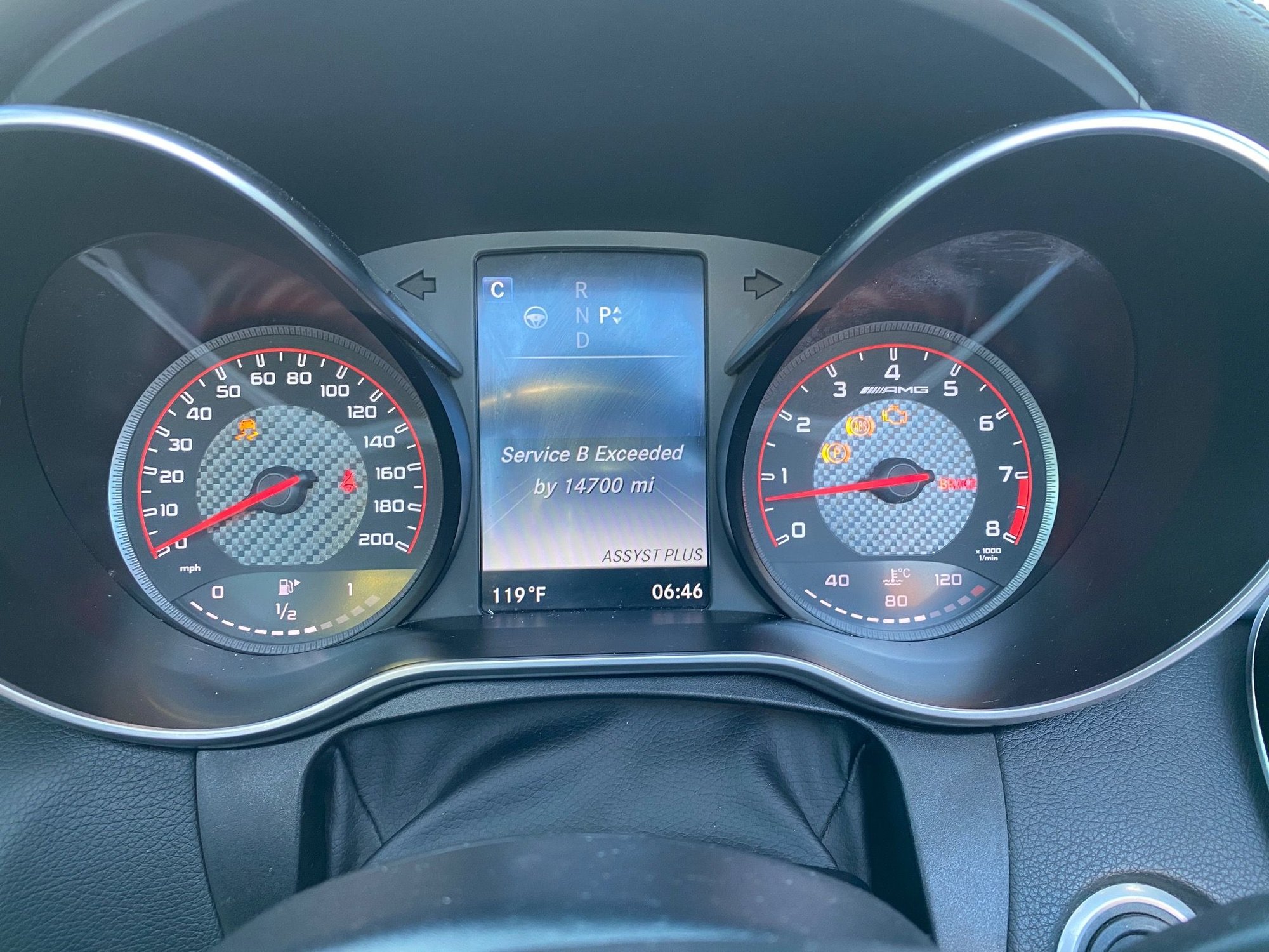

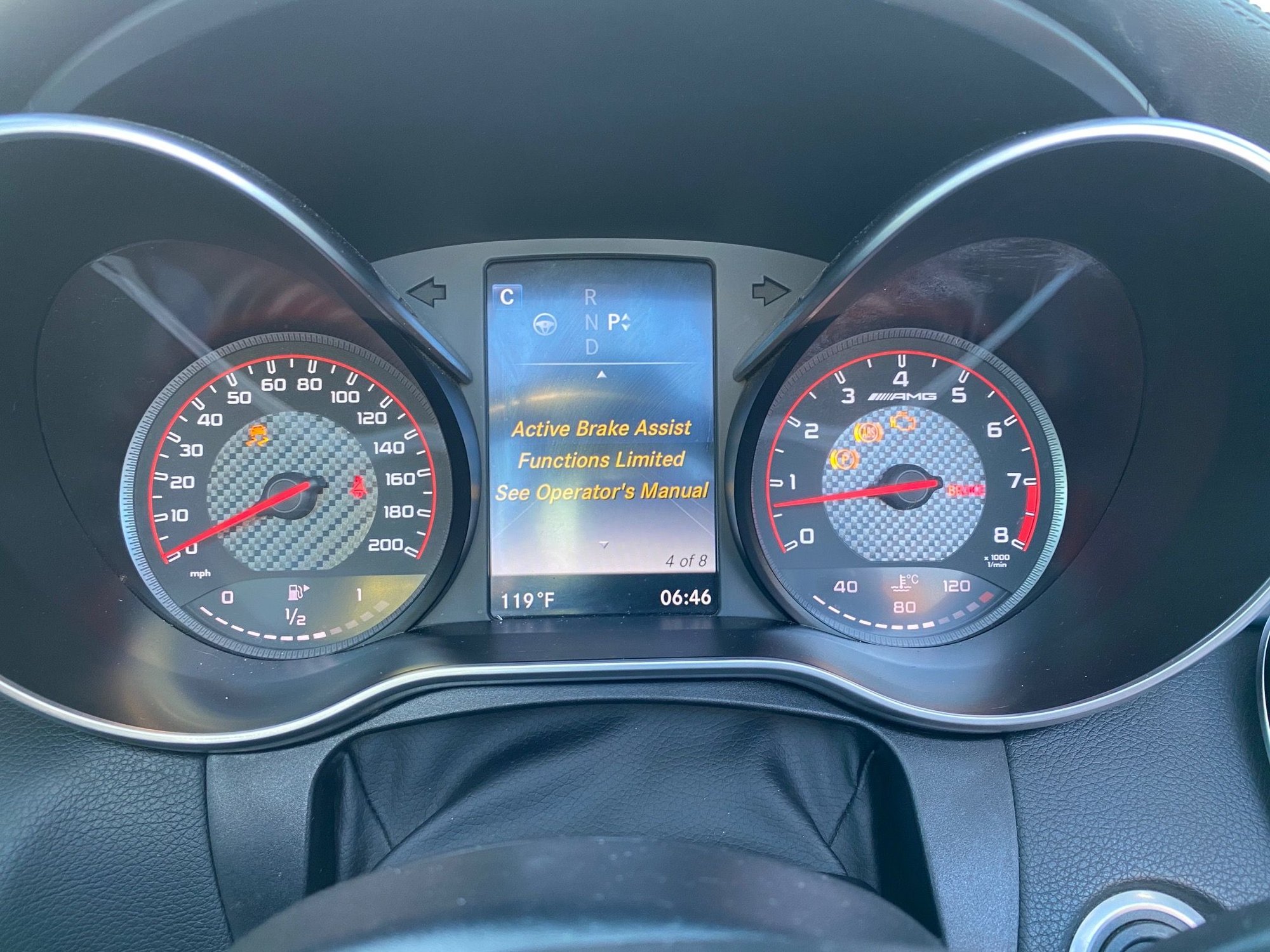

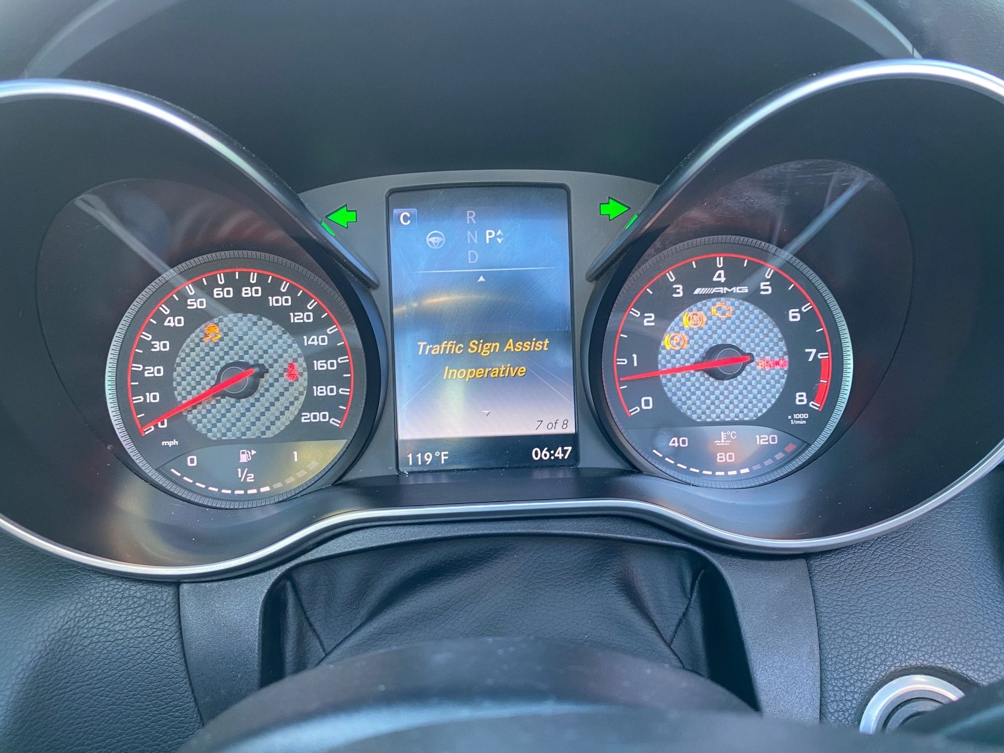

Hello, I have a 2017 c63s cab edition 1. I went in for a replacement of the wind deflector and while I was at it I still had 1 prepaid maintenance package left so i got the 30k service done to it around 34,500 miles. I pick it up Wednesday 8/19 drove it back home and no problems. The next day I went to get tires swap out at my usual place and an hour afterward car went into limp while on the highway. All sorts of lights came on. got it towed to Mercedes Caldwell where I got the service done and of course Friday and Saturday the car was just left there and I got no update. The car was in comfort when i was driving not pushing it hard. engine temps were good. the outside temp on the dash kept rising though. had to remove the push to start button in order to turn off the car after I move it to the shoulder. it did start right back after turning off the car. can changing 4 tires do this to a car? as of now I'm blaming the 30k service but trying to see if anyone else had this issue. I also could not put the top back up even after turning on and off the car and even waiting until the tow truck came. any help to solve this mystery would be great. thank you in advance.

Well it definitely seems like it's something electronic, to cause all of those random errors. My guess is that it will be a bad battery or you need a Benz software update.
A couple months ago I was driving along normally with the family and the engine started running rough and I had misfire codes. Independent shop could not figure it out. Took it to Mercedes under warranty and they gave an update and fixed everything.
The SA told me I was not the 1st and won't be the last that this happened to, sees it a lot. My error codes were different but because yours is a cabriolet it could be that the Same software problem could manifest a little differently?

Dude, you drive with the top down in 119F?
no. def not. for whatever reason, it was reading the outside temp completely wrong. after the car went into limp.

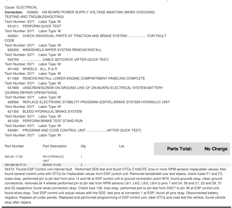

i was there throughout the tire change and everything he did seem normal. I got a phone call finally and the traction control module failed and stop reading the speed sensors which is getting backorder and taking 2 weeks to get the part in. at this point i so tired of having this car. had so many issues.

Hello all and sorry for the late update. They replaced the ESP control unit which i guess also caused all 4 speed sensors from reading which basically limp the car not going past 20 mph. this is the service record. took almost 2 weeks for replacement part to come in and installed.
