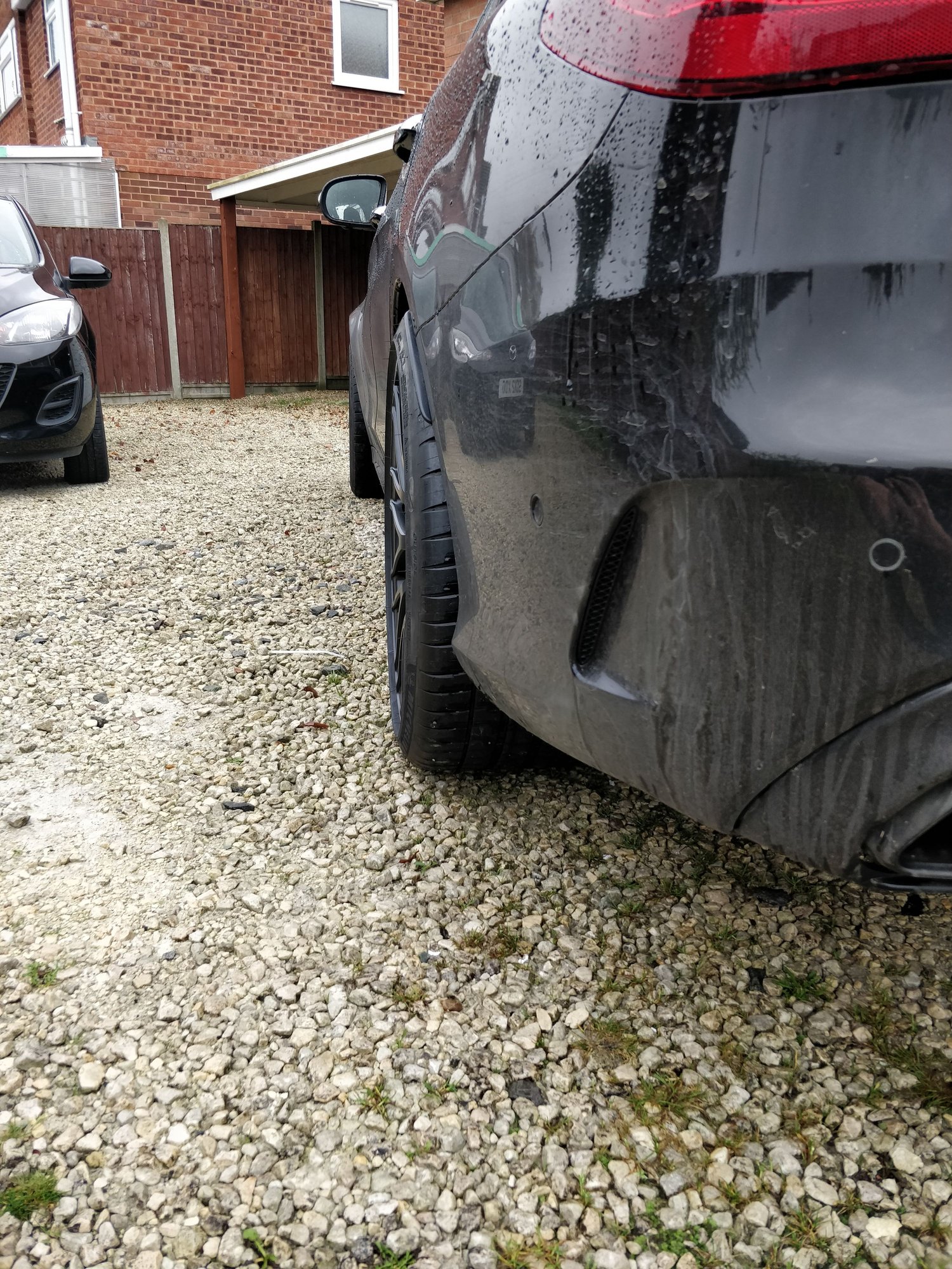

So I put some coupe 20J rears on the back with 295 tyres, they are tight! But they fit, might get rubbing at full travel, but I'd need serious air for that to happen.
I then put the standard rears on the front with 20mm spacers, so running the standard rear 265 tyres. It's worked perfectly. Some before pics:

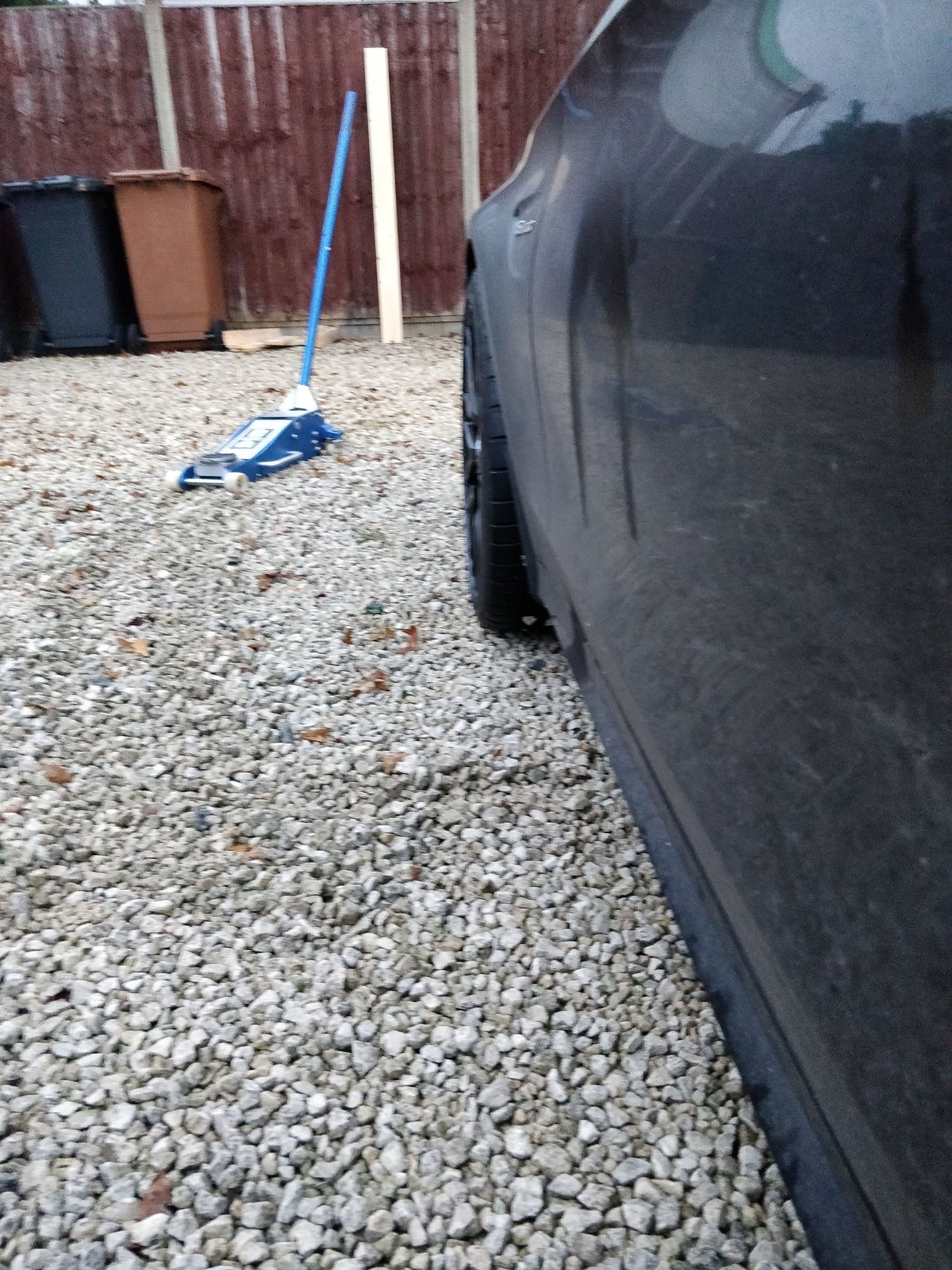

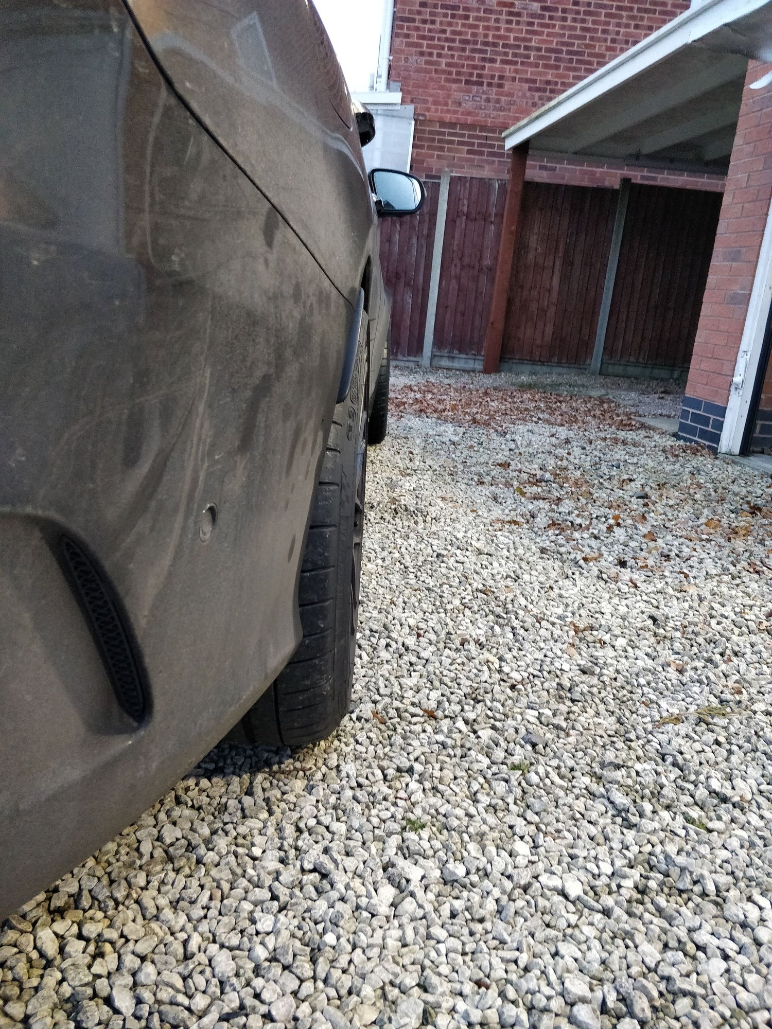

C63S
After:

That's some nice poke out the back. Looks fantastic mate, got any side on photos?

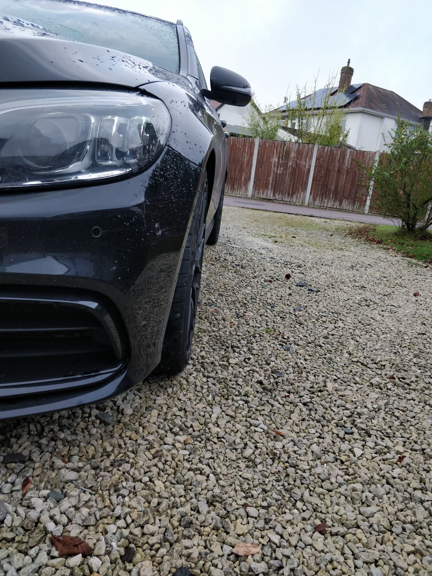

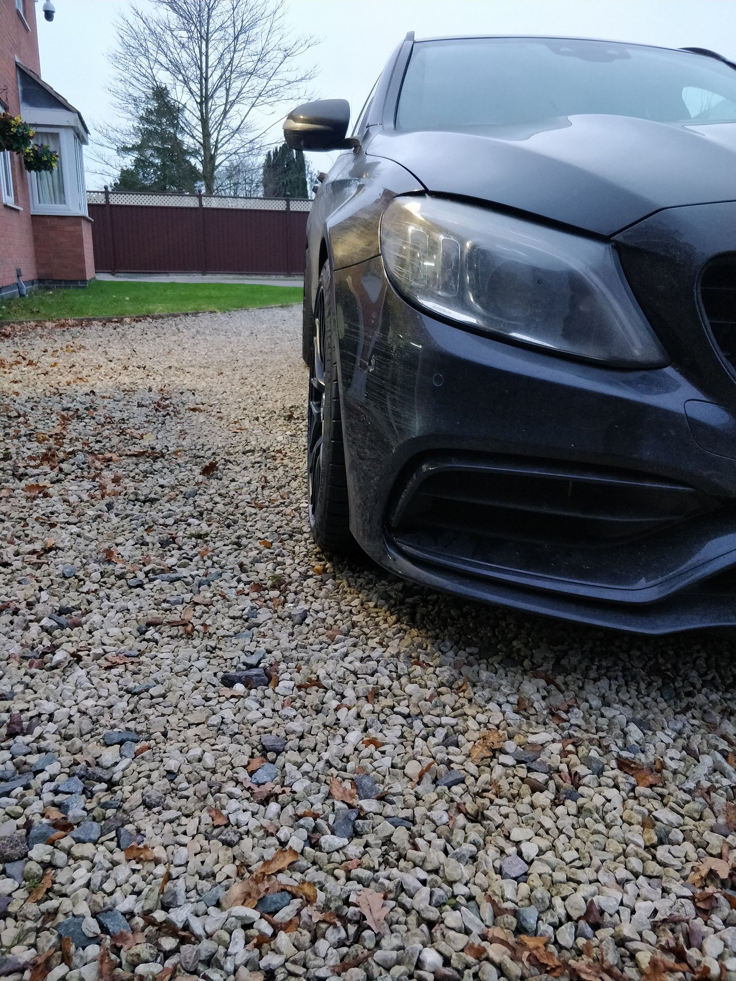

They're on!
So now got the coupe fronts fitted, machined 7mm off the hub and took them from ET25 to ET32.

C63S
Final fit
285/30/20 PSS M01 on 10.5J ET57
255/35/19 PSS M01 on 9J ET32

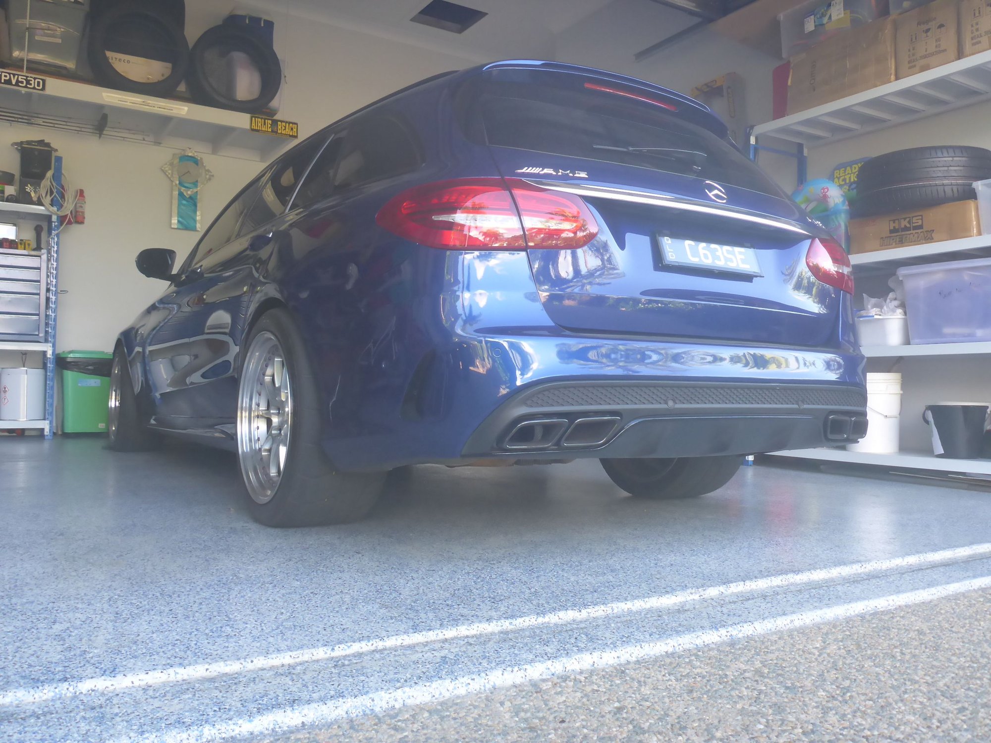

S205 C63s
9.5x19 with 255/35 and 11x19 with 295/30
2'nd pic has 285/35 Nitto NT01's
BTW nice Estate

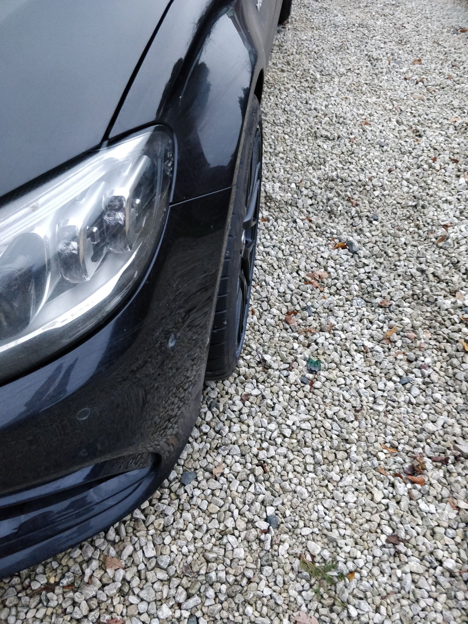

Here's the rubbing, thought I'd already posted these:
