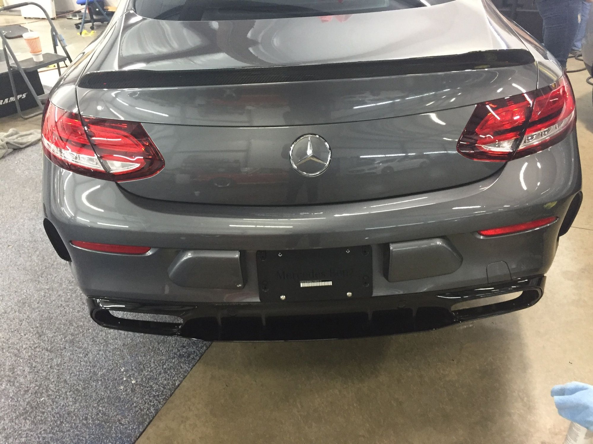

Originally Posted by ///Bruce
I think I see the problem. Your car is missing the exhaust
That’s an old photo of when it was getting ceramic coated. My wife forgot to order the night package. The tips were off getting powder coated.
