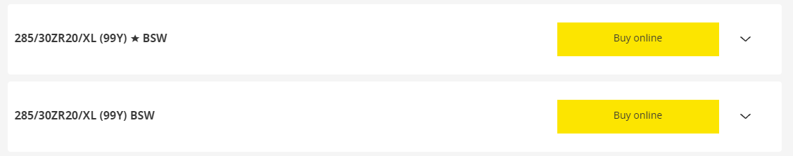

I found this one Michelin's website, for our front size, these are the variations that are available:
These are for the rears:
What is the difference between the normal one and the star BSW again? @superswiss

That seems to line up with Tire Rack. The difference between the star and the regular PS4S is explained in the video I posted. In a nutshell, the star has a compound makeup that's closer to the Cup 2, so it offers more grip and performance in the dry, but isn't as good in the wet as the standard PS4S. Seems to be the ideal compromise between the standard PS4S and the Cup 2 if you want more grip w/o going all the way to the Cup 2 and deal with the reduced initial tread depth of the Cup 2 and the resulting lower tread life, and not needing to get as much heat into it as the Cup 2 requires before you actually get all that grip.
