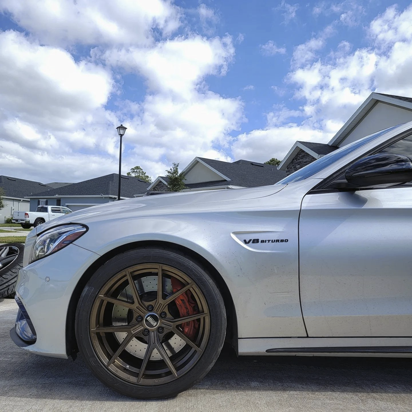

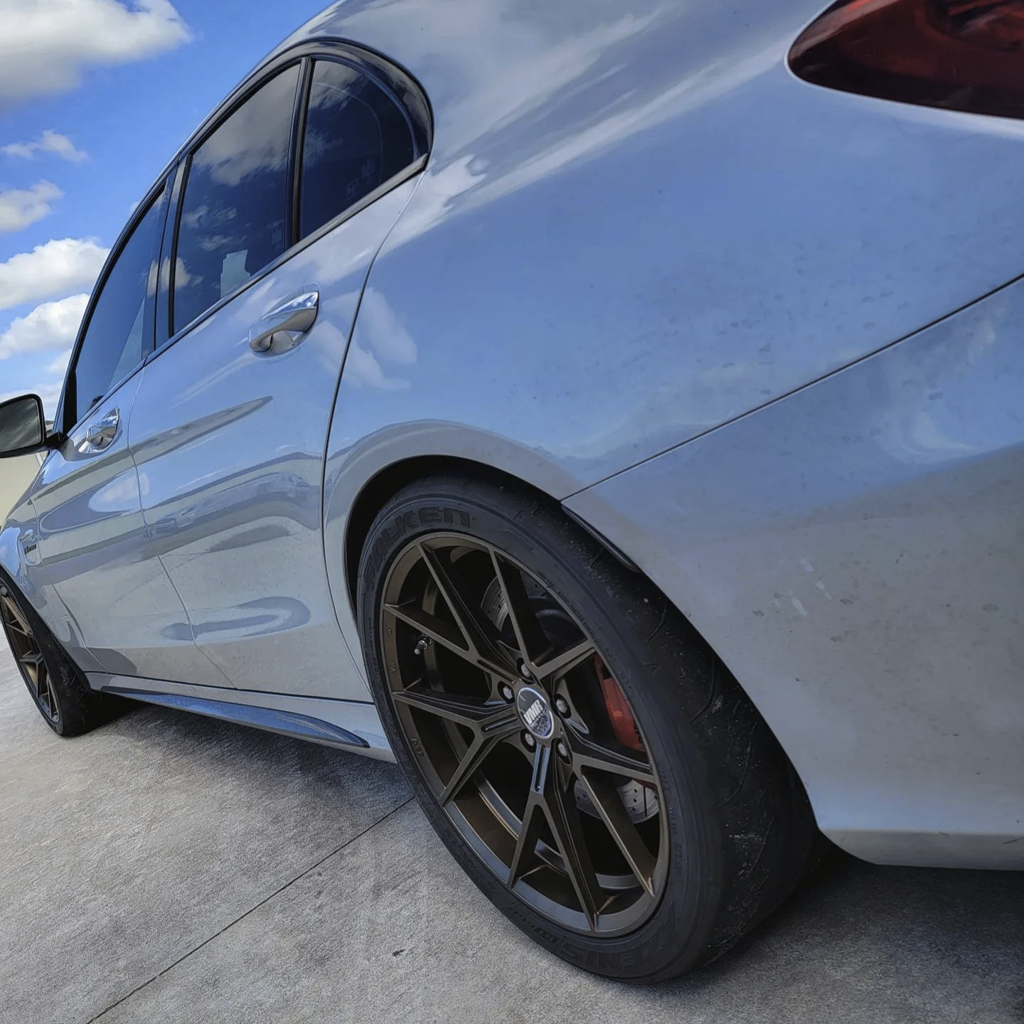

I apologize for the dirty car in advance, just got back from an Autocross.
Thanks to @RDO247with his staggered 9.5/10.5 fitment, I was able to figure out what the perfect square 9.5 setup would be.

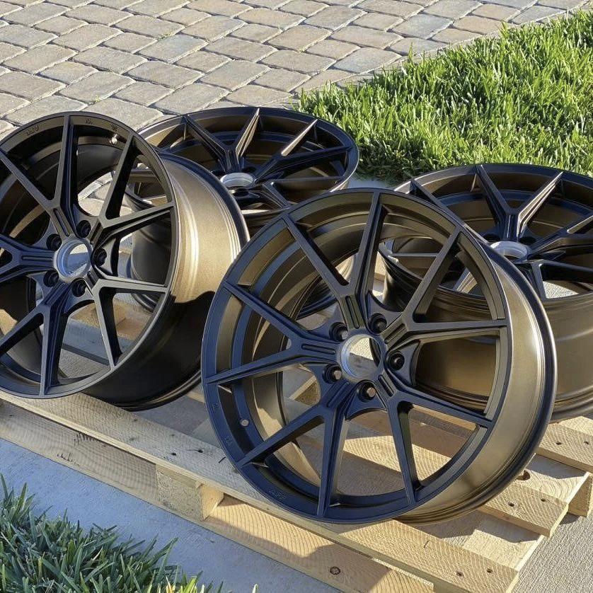

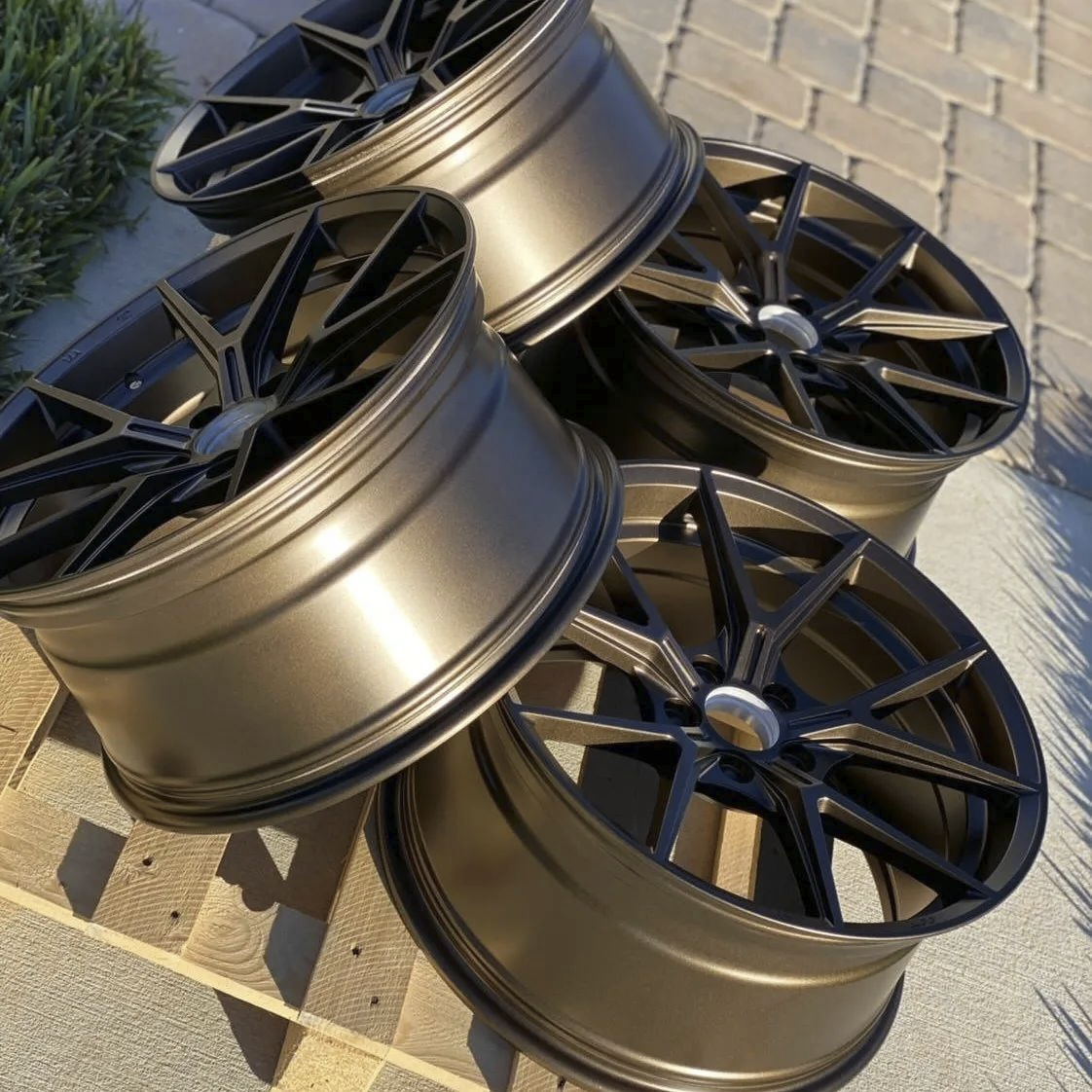

These are VMR V804 (Flowformed), wasn't planning on spending big daddy money on rims so these were just right in the budget to get rid of the "base" non-forged 19s.

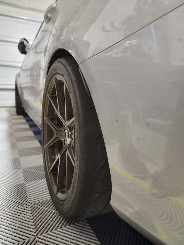

Specs are
19x9.5 +45, with Modalworks 12.5mm spacers up front, the only way it'd work without poking too much on stock height. RDO has 9.5 +30 on the front, a 15mm spacer would've achieved the same thing, but there's enough room on the inside for 12.5mm.

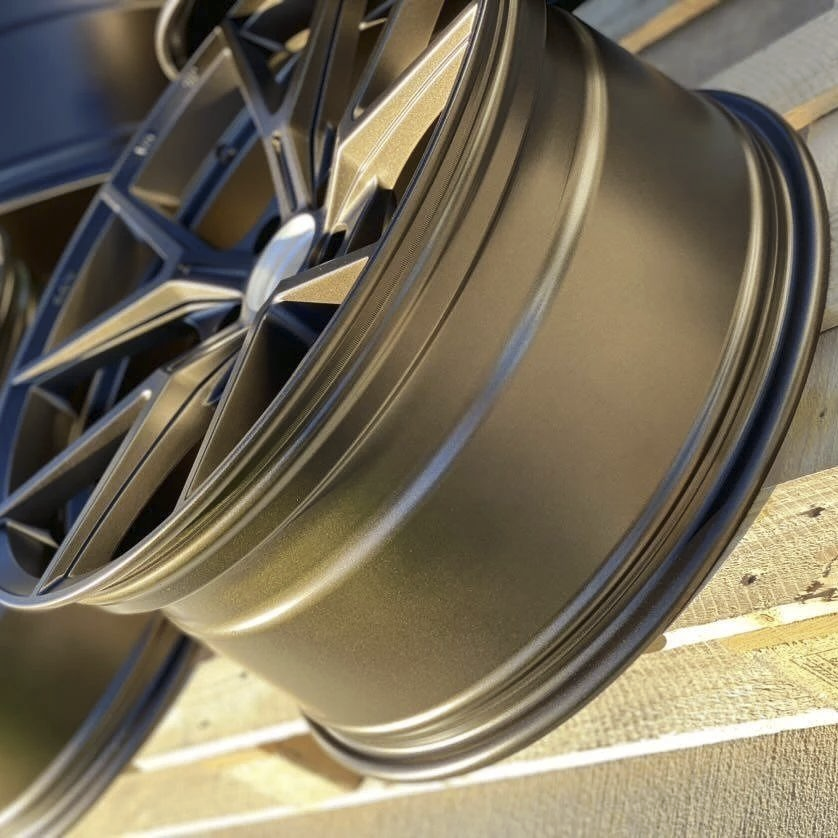

The powdercoat color is from Prismatic and it's called Triple Bronze, 2 coat setup, the color doesn't really show on a phone camera, and it kinda changes color when the sun hits.

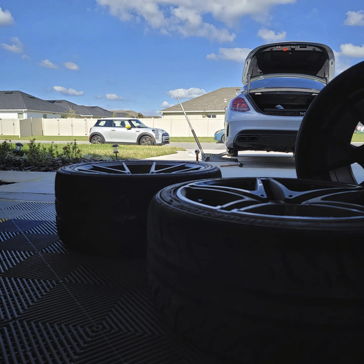

The rims are wrapped in 275/35-19 Falken RT660, and they are really more like 295, here's a comparison with 265 RE-71R, both being mounted on 19x9.5.
