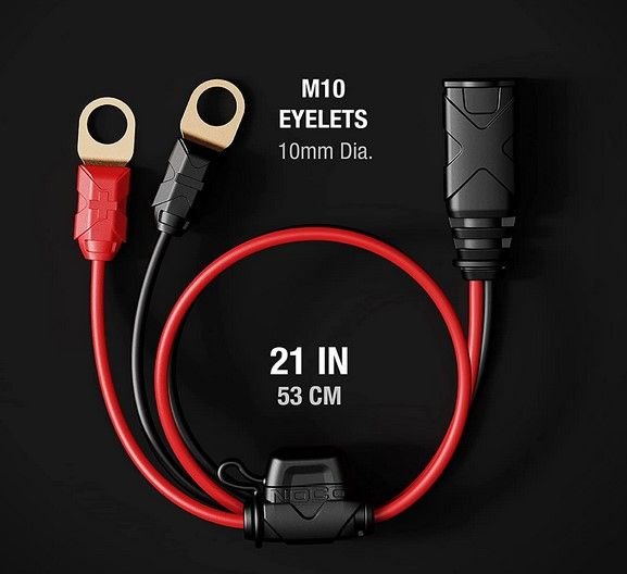

*****I use NOCO Genius chargers on several of my cars that sit, including my C63s now due to our snowy weather. The NOCO Genius chargers work well, and can be left on the car indefinitely. They are smart chargers and go into maintenance mode once the battery is charged. I rigged up quick connect plugs that are fused for safety on all of my cars that sit so I don't have to leave the hood open, or even open it at all to hook up the charger. The NOCO male end coming from the charger just snaps into the female end on the car, and the female end has a nice cover on it when not being used to keep dirt/water/etc.. out of it. Works really well.

The CTEC charger I got for my motorcycle came with this option for connecting to the battery and it makes it incredibly hassle free to keep the battery charged up. If you have a vehicle you don't drive much, I would recommend using something like this to make your life easy.

****Yea. I use those M10 Eyelet kits from NoCo because they are fused, and fit the NoCo chargers which I use on all of my garage queen cars, which generally only come out on sunny days. Years ago, I used to pop the hoods up every couple of weeks and connect a charger, etc... Realized life is too short, and my C63s was *super* easy to mount those eyelets on. You only need one M10 nut, and for ground just use one of the accessory grounds that already have a couple of other wires on them already, with its own nut already there... The positive terminal is protected by the plastic bonnet on the positive terminal in the engine compartment. I ran the plug to come out discretely from the back of the hood and it folds out of the way neatly, is basically not visible and is sealed with a protective cap. It's so easy to hook up the smart charger now, no popping the hood, etc.. Just flip the cap, and plug in - done in 5 secs.

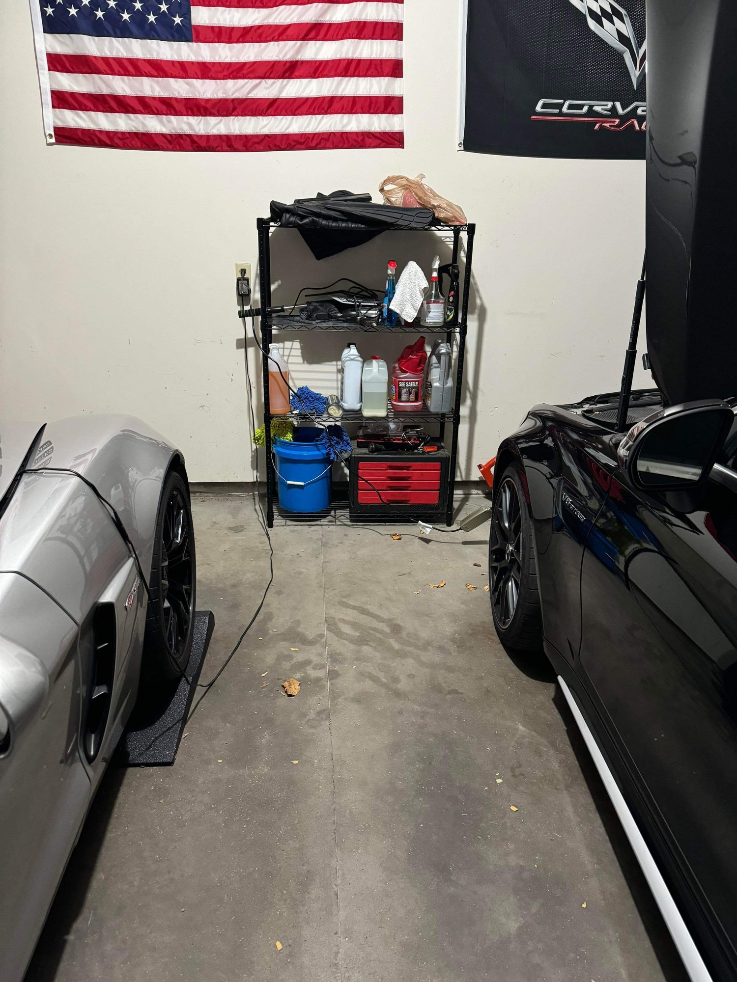

Not a dumb question at all. U have to angle the clip on the positive/red terminal before closing the hood. I then use a small box right where the spring clamp is supposed to engage and close. The box props it open ever so slightly and hood stays partially open. Here's a pic to see.
I can send a close up pic tonight when I get home if needed of what kind of box I use as well. Let me know.

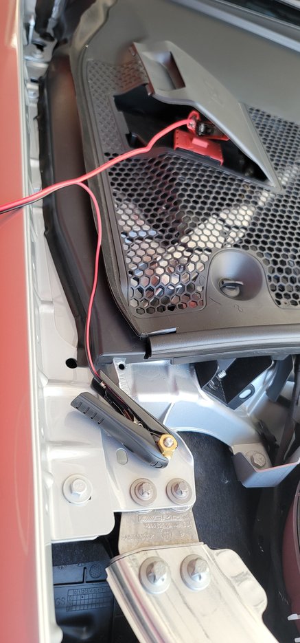

Haven't had an issue. I fold the cover over completely flat, then make sure that the clamp is flat as well and lower the hood to the first latch position. It stays there on its own w/o any need of a prop.

Nice garage. Are you gonna repaint the wall if you switch to a different brand?

Nice garage! Mind posting a pic of the box and location? haha
