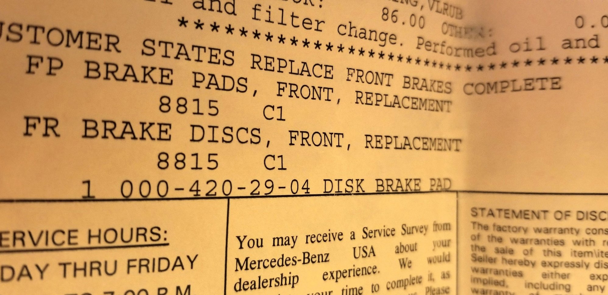

In November, I had my front brake pads and rotors replaced for my 2019 C63S coupe at a MB Dealership.
Below are 2 photos of the Dealership part numbers for front brake pads, rotors and other parts used for a 2019 C63s coupe.
This month I had my rear brake pads and rotors replaced. If you like the part numbers let me know.
MB Parts will let you know for sure if front rotors are the same number for the C63 vs C63s. I believe they are different but not sure.
