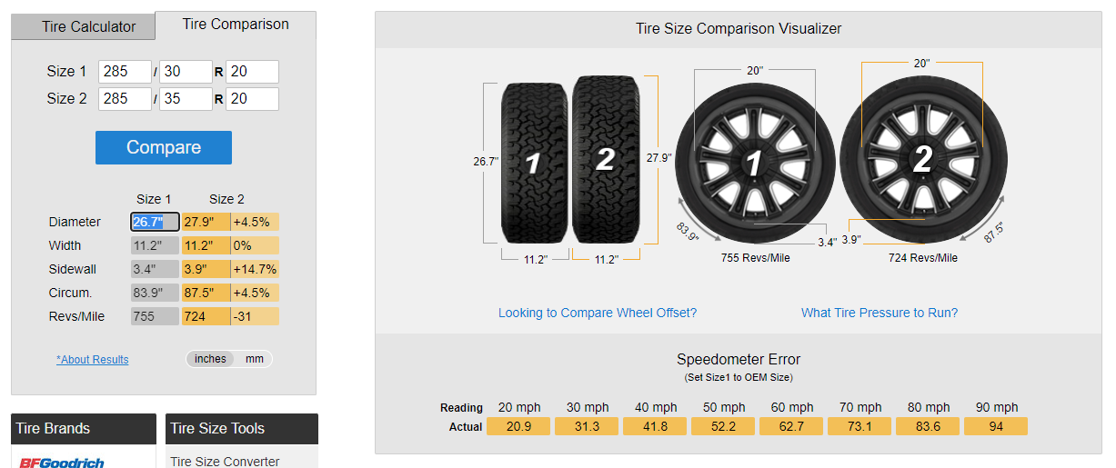

I'm lowered on H&R sport springs with 15/12 spacers and I think I have room for 295, but 305 might be tight. I'm fairly certain I do not have room to run a taller tire like 285/35 (26.7 inches vs 27.9 inches tall).
Tire Size Calculator

The only reason you'd really do this is to have more protection between the wheel and the road against potholes and a bit of added comfort. At the same time you'd increase the ride height at the rear compared to the front and potentially degrading aerodynamics. Below is the comparison between the two. Theoretically it does improve traction by reducing your acceleration. The force acting at the contact patch reduces as the radius of the wheel increases, so with less force it's less likely to break traction, but at the same time it reduces initial acceleration as that force is what propels you forward. You'll essentially reduce the force and acceleration by about 2.25%.
Torque at axle = wheel radius * force at contact patch
Force at contact patch = mass of the vehicle * acceleration
So if you solve the above for acceleration or force, you'll see both decrease if the wheel radius increases since the torque at the axle and the mass of the vehicle don't change. Now this doesn't factor in drag, so it's only good for taking off from a dig. As speed increases, air resistance takes over and horsepower determines how fast the car accelerates as you need the power to overcome the air resistance.
