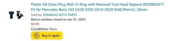

*****Yea, they totally rip you off on all of that. I totally understand they have costs, but $29 is ridiculous for that plastic plug. Below is a scan of what I have used - that's two plugs and the tool to remove it safely. They work great and seem *exactly* the same as what came out.
