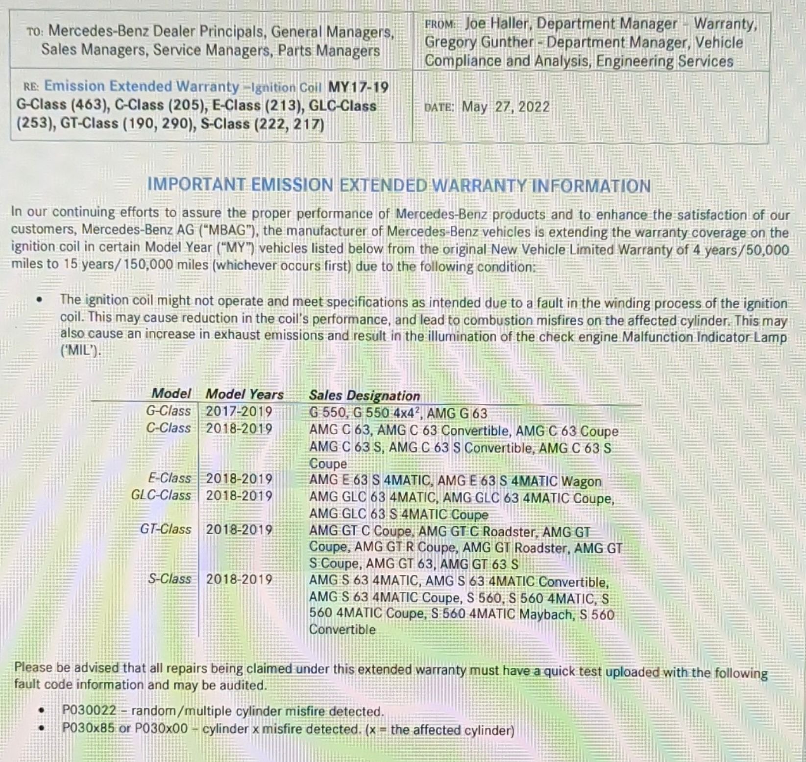

I have a 2020 C63S, but an early build. I am wondering if I can check if I have new or old ignition coils.
Also, is there a TSB or other ID# for that bulletin?

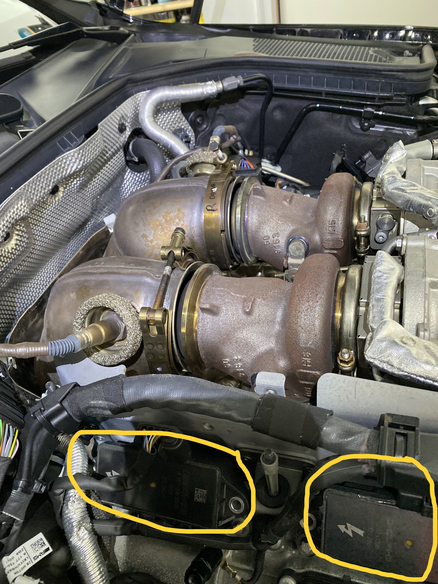

*****I have aftermarket intakes on my car now, but I think you can see at least one or two of the ignition coils even with the stock air cleaner on, and check the part # on the coils. I have a 2018 C63s but have the updated coils. Pic below of my motor during my turbo swap last week, passenger side - I have circled two of the coils (car has 4), and even though the pic is not clear - the part #'s are visible on the top surface of the coils. You *might* need to move an airbox a bit out of the way perhaps to see, but this is very easy to do.
The newer coils came with my car, but I am the 2md owner so think the original owner had the new coils put in.

I am trying to find an official version of this. Like a TSB or identification number, but I am having trouble doing so. My car is eligible, but I need to track down this publication so that Mercedes can cover it. Please advise.
Did you find the TSB or other ID# for that bulletin?
