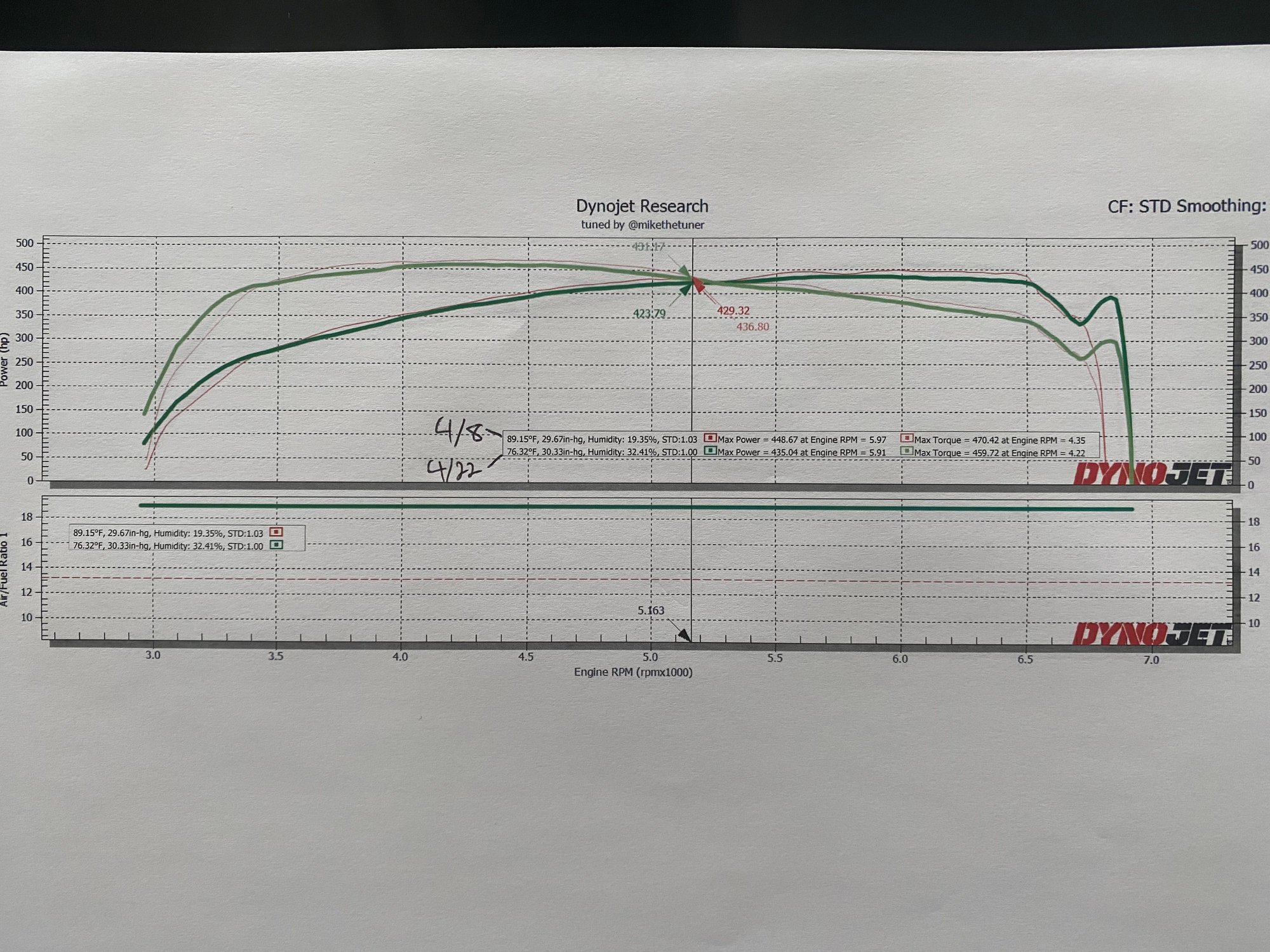

Below are a couple of dyno pulls on one of my cars. Stock everything except an intake on the *earlier* pull (higher numbers first pull..second pull was stock air cleaners and housings,etc..Verifying how much restriction we could get away with, and doing fuel trim adjustments, blah blah), both on pretty hot and humid days but still within specs for the car (C63s). These were baseline pulls to make sure the car was ok before throwing on parts. I have lots of other pulls, including with downpipes, intakes, exhausts, and turbos, etc... Experimenting with different tunes and fuel/air trim ratios, etc.. for optimization of the car with the parts I've been messing with.
The modified graphs look a lot different in terms of power band movement due to increased flow, etc.. Power curve shifted down with the stock turbos and opened up exhaust (DP, secondary cat delete, 200cell cats). More power and torque down low with the stock turbo setup and a more marked drop in power above 5k, again with the stock turbos. Again, higher peak power in terms of HP and torque but the band shifted left a bit due to less exhaust restriction. The stock turbos are nice street turbos and a good balance for most people, but are limited in terms of higher numbers just due to mechanical limitations of the inducers/exducers size.
