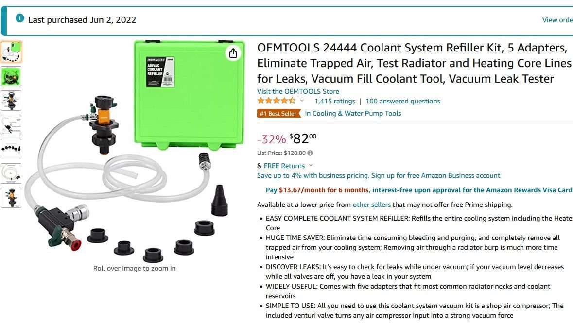

Old Aug 26, 2022 | 10:04 PM
MaxVO2's Avatar
Joined: Dec 2021
Posts: 268
Likes: 135
From: Maryland
2018 C63s
Originally Posted by '1663s
Max, any chance you can link the pump you used for your trans flush? I have to do mine and dont want to pay someone a gew hundred for what is a mostly straightforward job. I also want to flush engine coolant as mine seems to be fairly low in the main chamber. Not sure the exact equipment I need for that one either. Just trying to get some insight. I try to do most of my own work but I am younger and haven't had vehicles for long enough to need these services until now. Today I did front and rear rotors, this weekend the rears are up, then diff fluid. Hopefully can figure out this trans flush and coolant flush with a little guidance. Thanks
*****This is what I bought from Amazon and used. It works really well, and has all manner of adapters for *many* cars. It has the nice metal adapters versus cheap plastic ones I have seen on cheaper units.
Old Aug 26, 2022 | 10:14 PM
MaxVO2's Avatar
Joined: Dec 2021
Posts: 268
Likes: 135
From: Maryland
2018 C63s
*****For the coolant flush and fill you WILL need an air compressor or some major source of vacuum so you don't end up with air in the system which WILL cause the engine to run a LOT hotter. Do not be cheap and just fill the coolant from the reservoirs and hope no air gets in. You must use the vacuum or closed system technique with the appropriate adapter and make sure it isn't leaking air. Link below to what I used. You can't just squeeze hoses and do other stupid old school crap on the system our cars have as the water pumps work different than old school cars and don't do well at all if there is air in the system. Get the system below or something similar, or pay a pro to do it right. The motor you save by doing it right will be yours, and I've seen a person or two try and cheap out and wonder why their car runs like crap, and runs really hot even though they have replaced the radiator and heat exchangers to the latest and greatest and their car is now *slower* and runs hotter than it did before the "upgrade"

Old Aug 27, 2022 | 12:48 AM
'1663s's Avatar
Joined: Oct 2020
Posts: 124
Likes: 21
C63s
Thanks for the info man, really appreciate it. Yes ive seen you say on other threads vaccum is required. I have a manual oil extractor pump, I wonder if I can somehow rig the adapters to make it work. I'll do some investigating. Thanks again.
