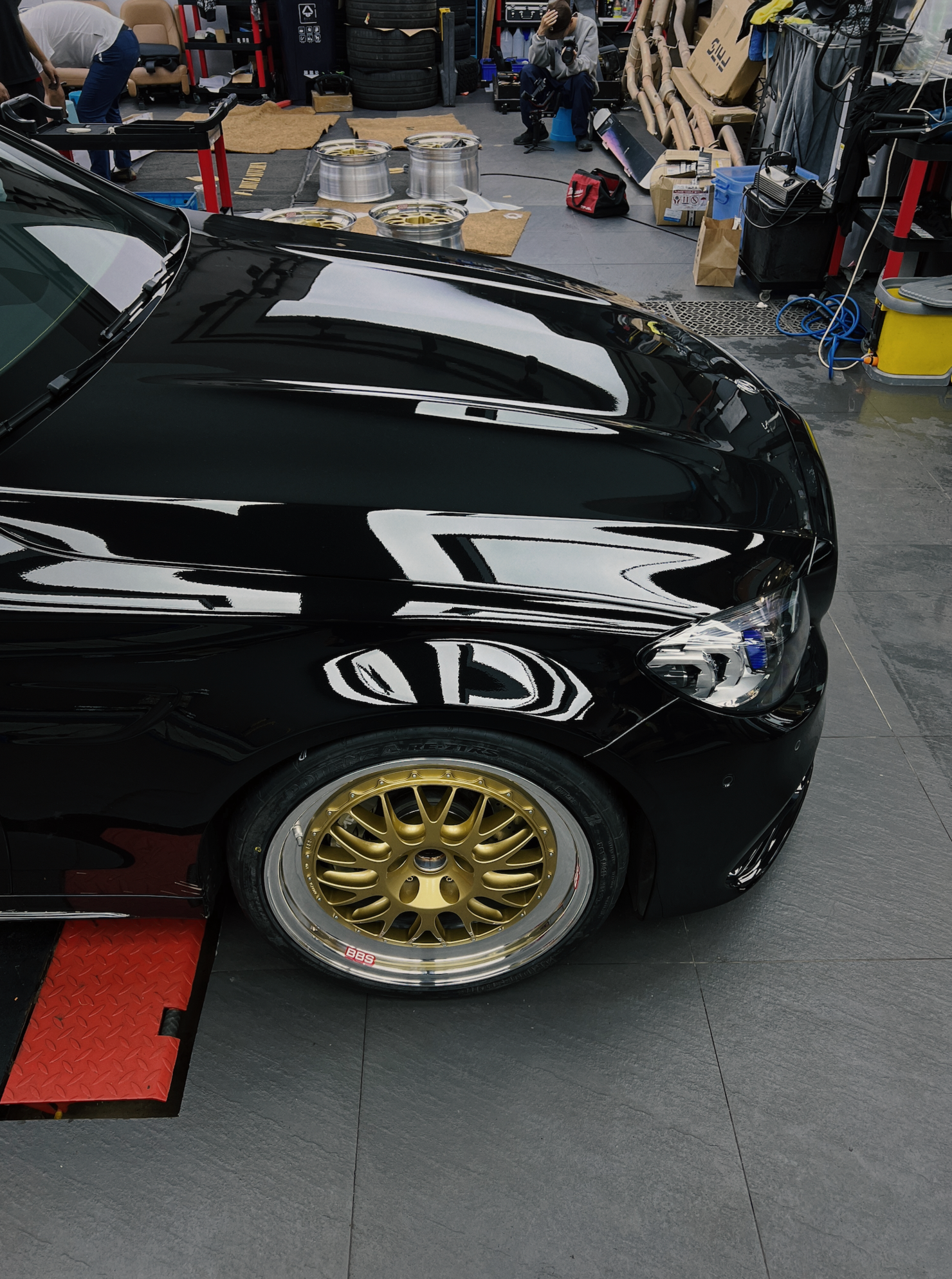

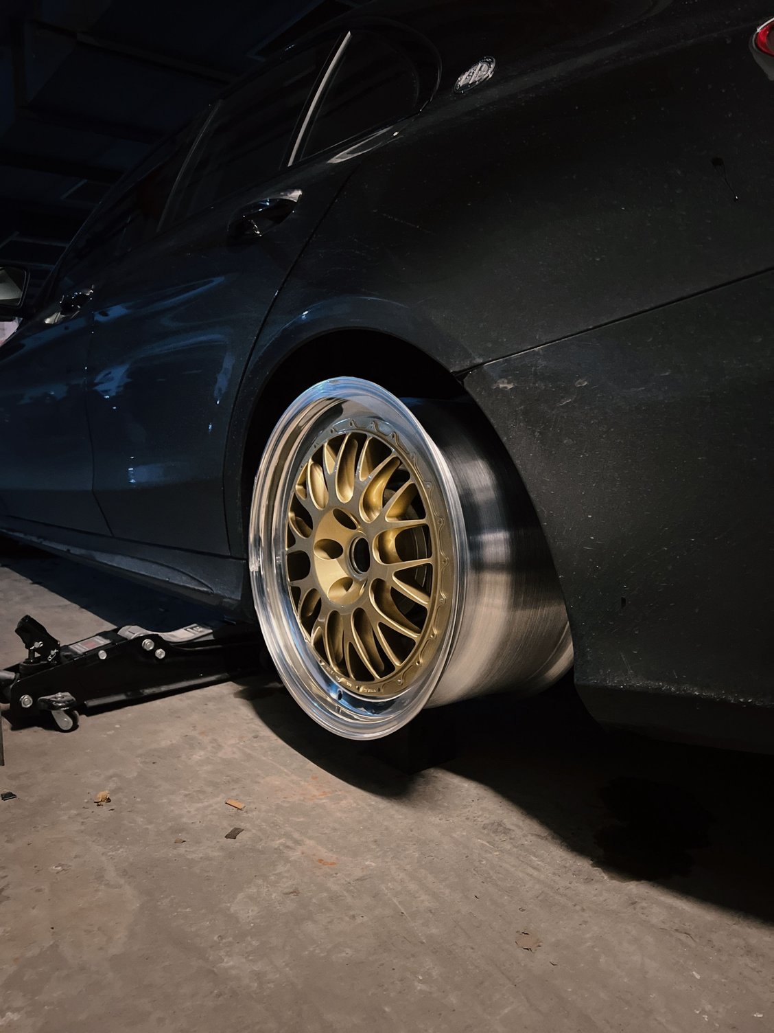

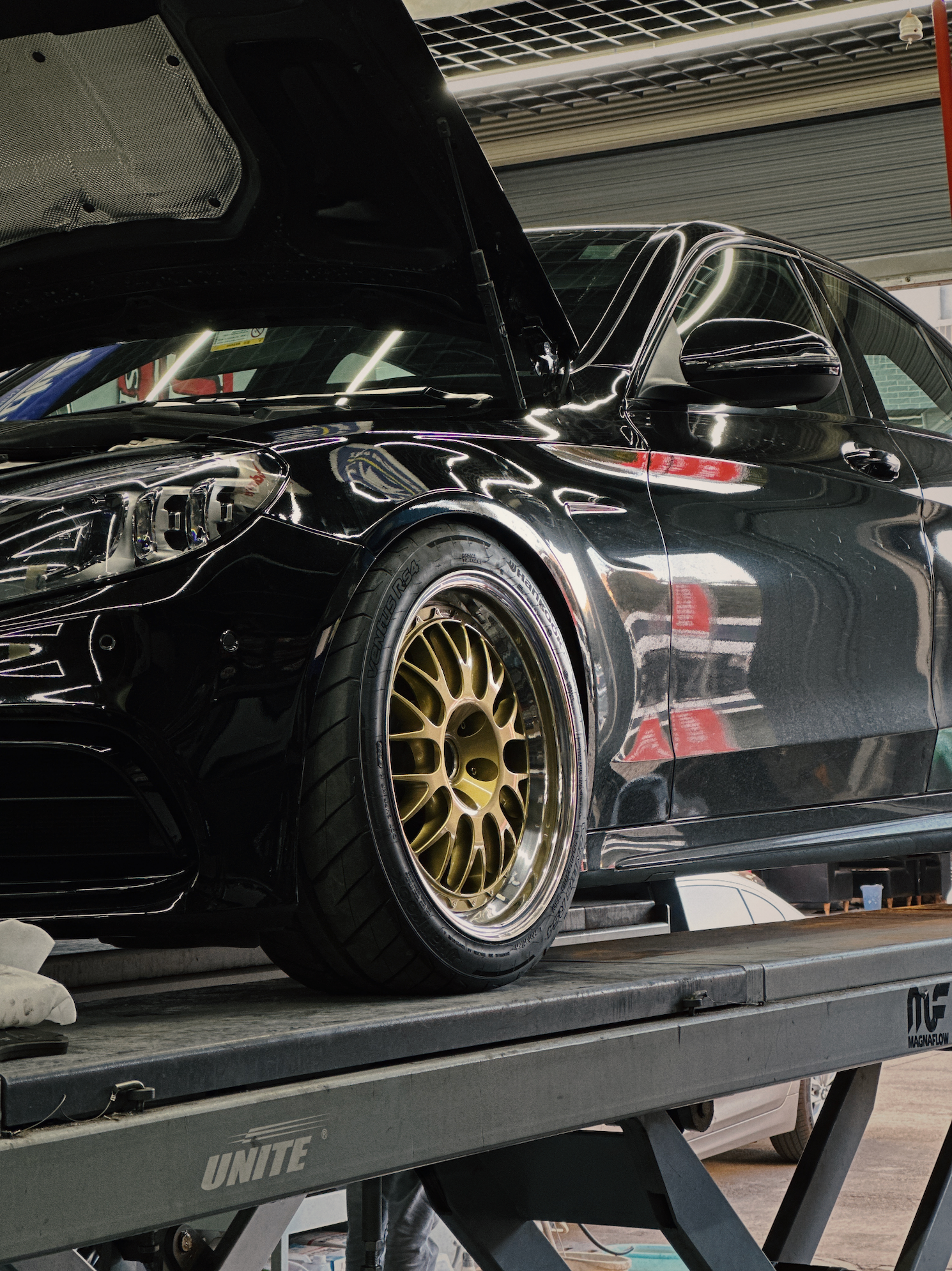

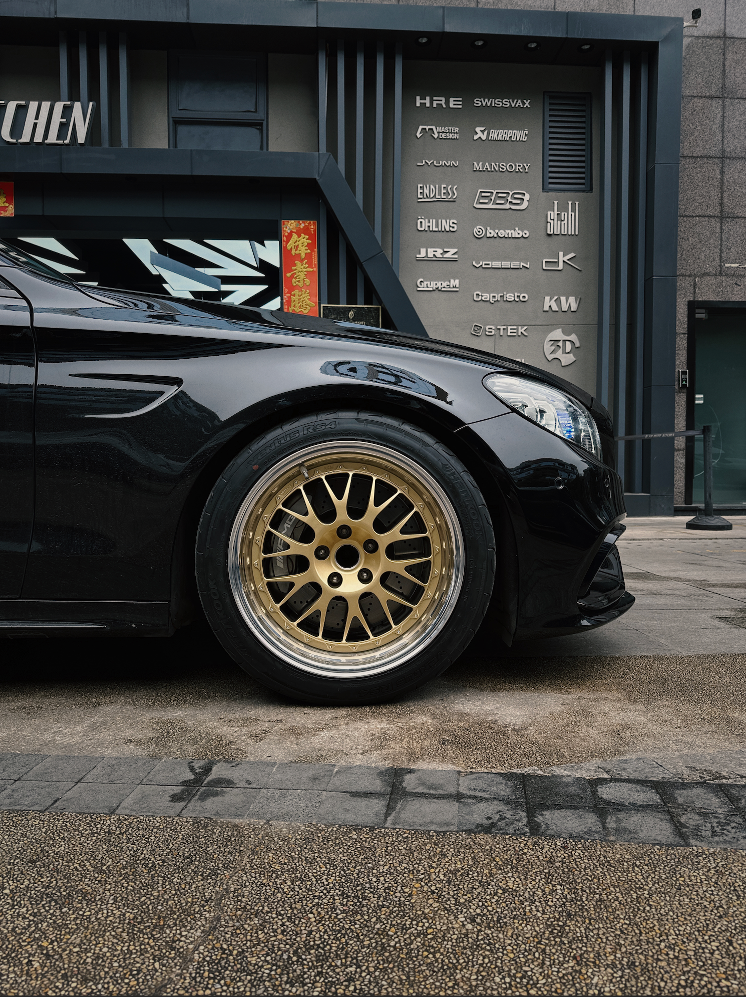

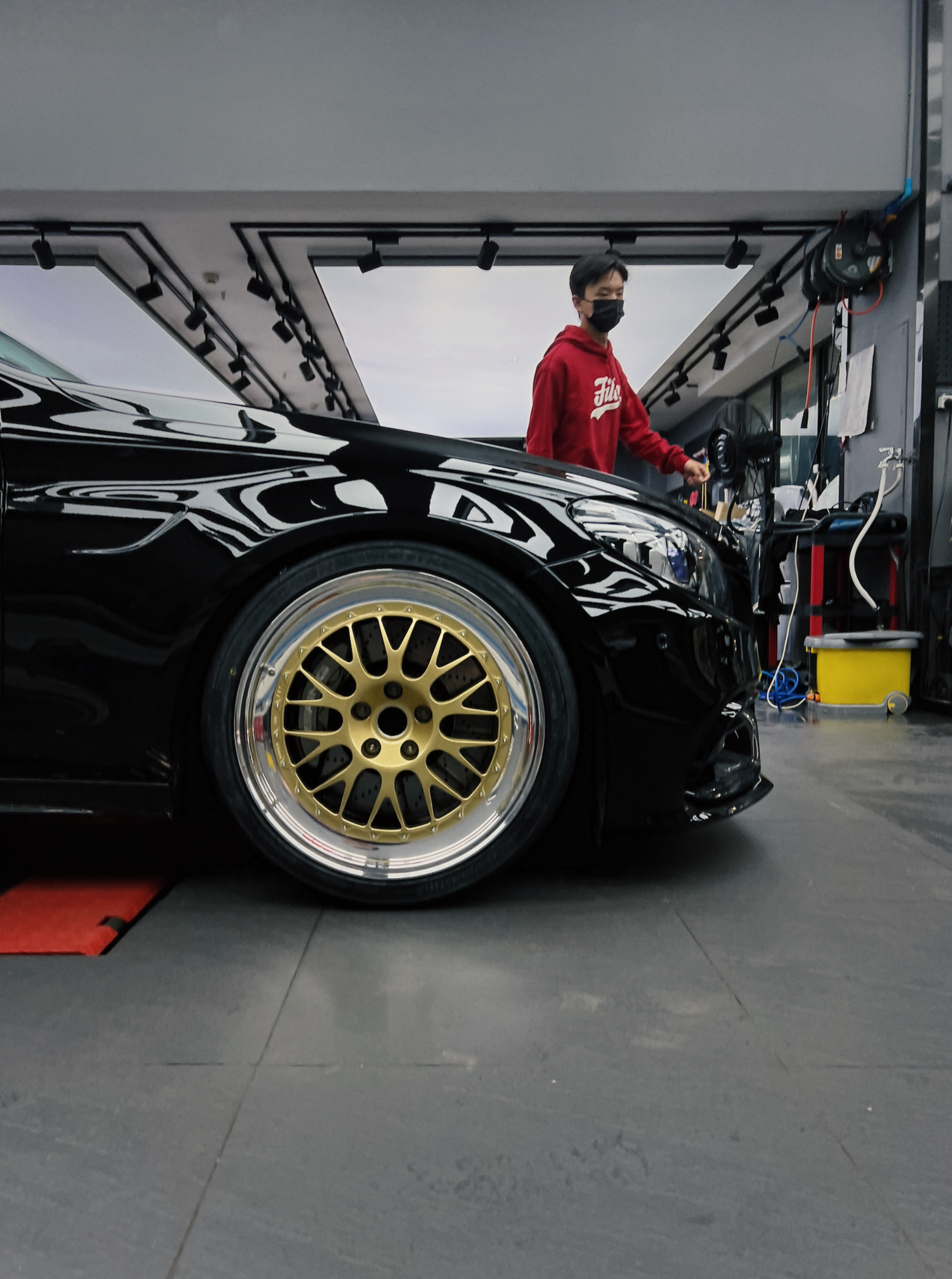

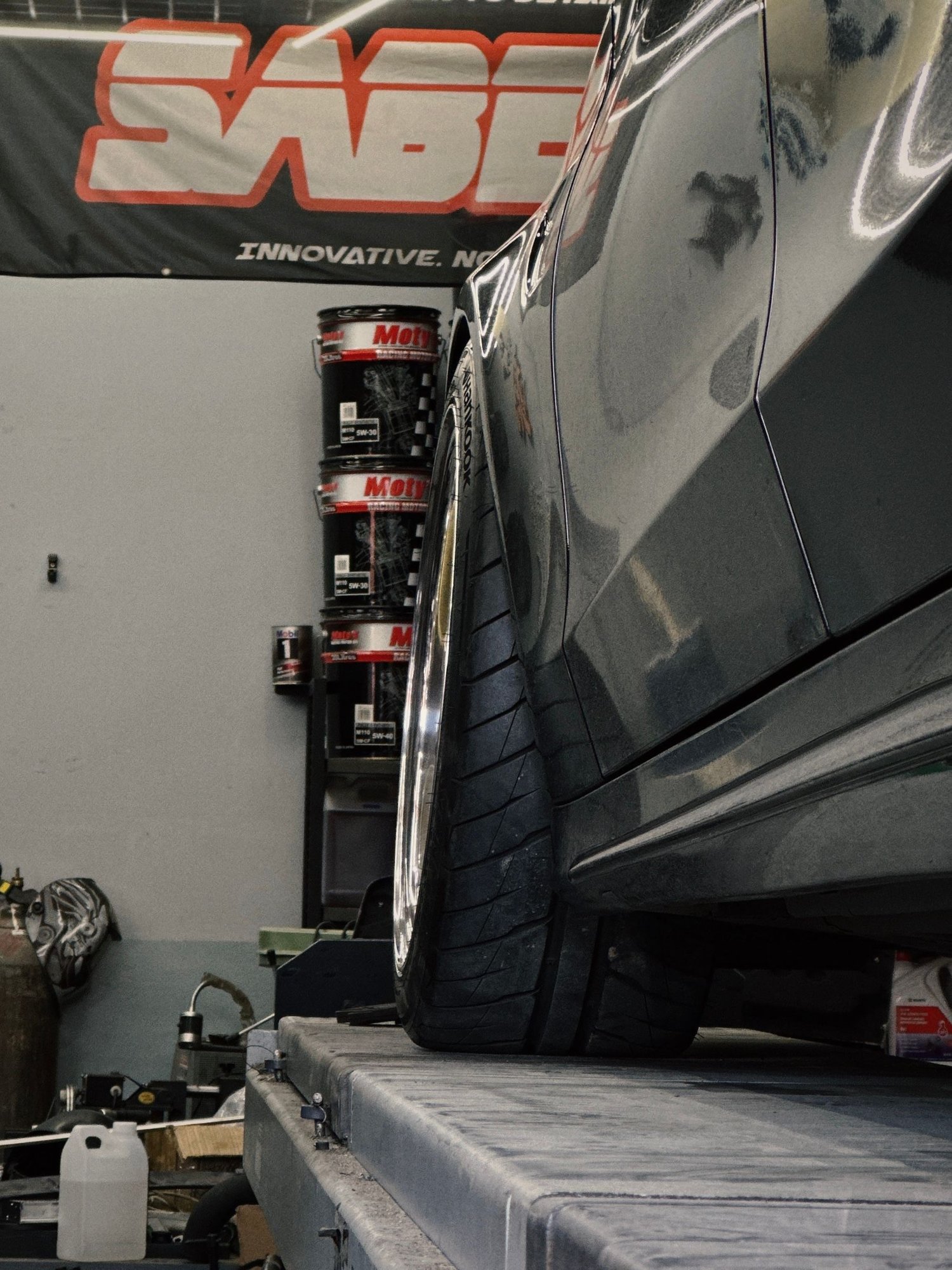

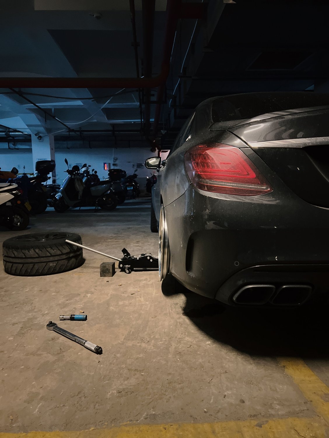

AMG C63 X BBS Motorsport E88. Square set up. *Updated 10/24/2023
Bought the car almost a year ago,
finally pulled the trigger.
This set is still in WIP stage, *Updated
currently running 18 inch Enkei GTC02s.

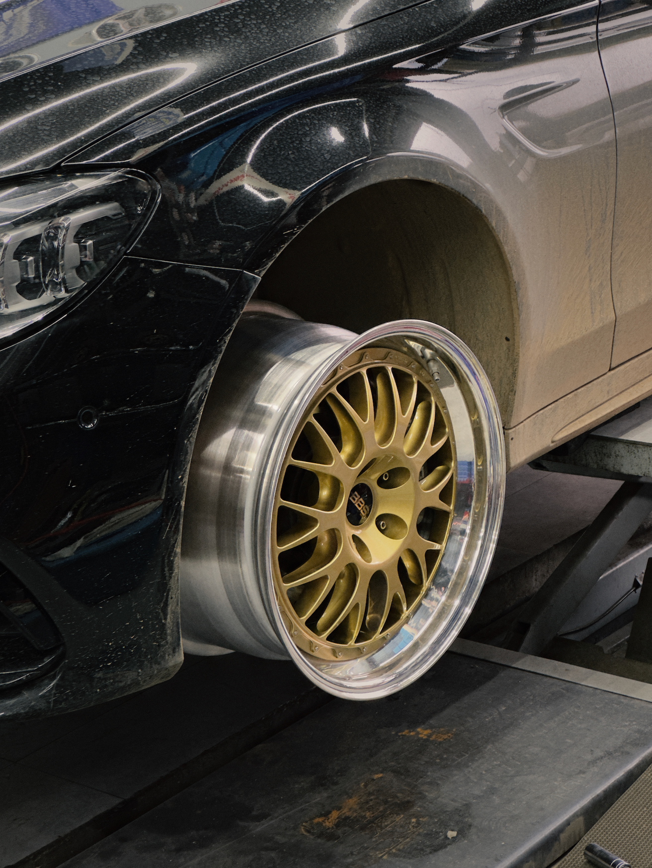

Gonna need a spacer, probably 3-5mm.
Finally fitted.
*12.16.2022 Updates
Added 0.5" on the lip and switched back to 18s.
***July 28th, 2023***
Finalized the camber spec,
and here are some random rolling shots I took lately.
***October 24th, 2023***

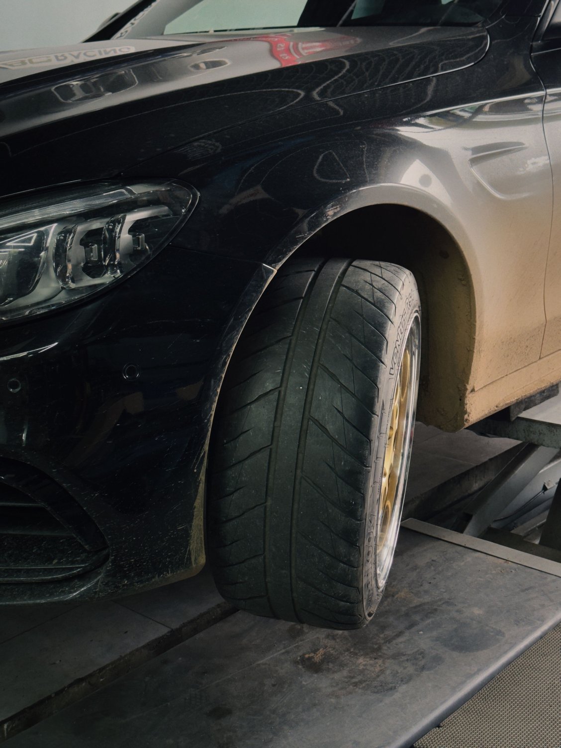

Widen the front wheel by 1 inch, and now the car runs 18x10J et 33 and 18x10.5J et 44, with 265 40 18 Hankook RS4s.
The turn-in is very neutral now with a much improved front axial grip and braking performance.

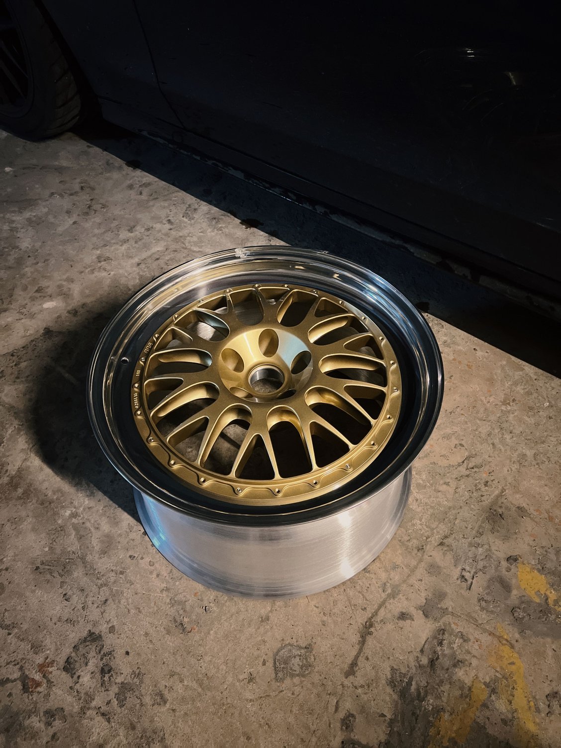

I feel like this will be a first on the W205. Looks like you have a non-S, which should play into the ability to fit these based on a smaller diameter disc. Wonder if this would work on an S model.
E88's are sick! Assuming you had to get them re-bored for our lug pattern?
Can't wait to see the results.
Old Sep 2, 2022 | 11:38 AM
ChrisX_Xzb's Avatar
Joined: May 2022
Posts: 18
W205 c63
thx bro!

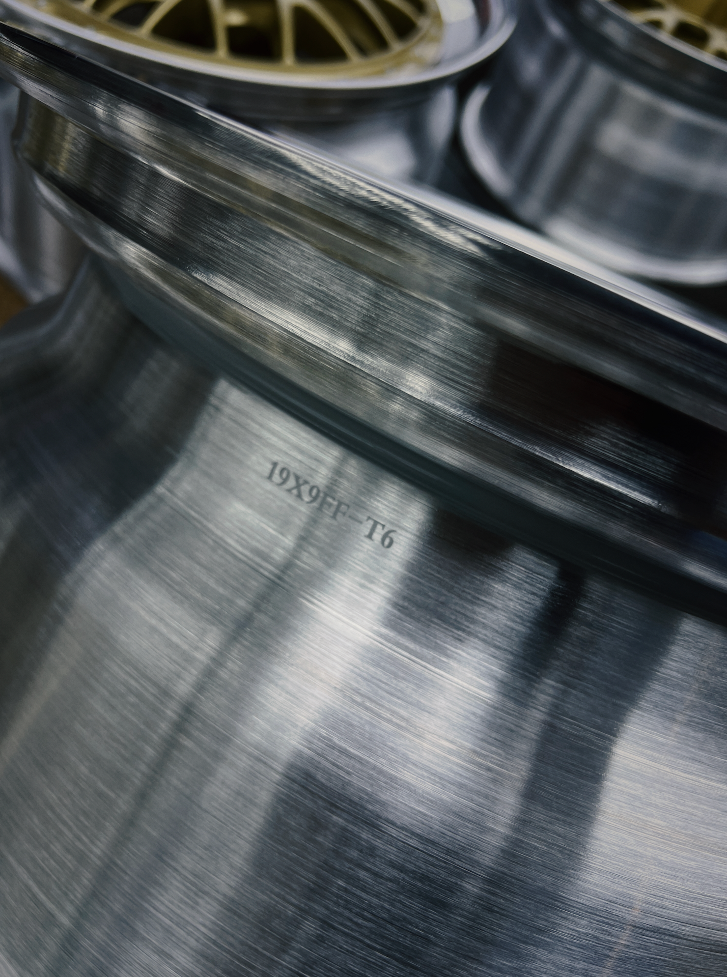

The centers are made for VAG so they are 5x112, but the wheel-bores need to get modded to 66.5.
Shouldn’t be problem fitting larger brakes since the wheels have been double-stepped into 19 inch.

Thx dude! I’m running kw v3 and the tires are Hankook RS4, 245 40 on 9J and 265 40 on 10.5J.

18x10 et33 18x10.5 et44 with 265 40 18 hankook rs4 front and back.
