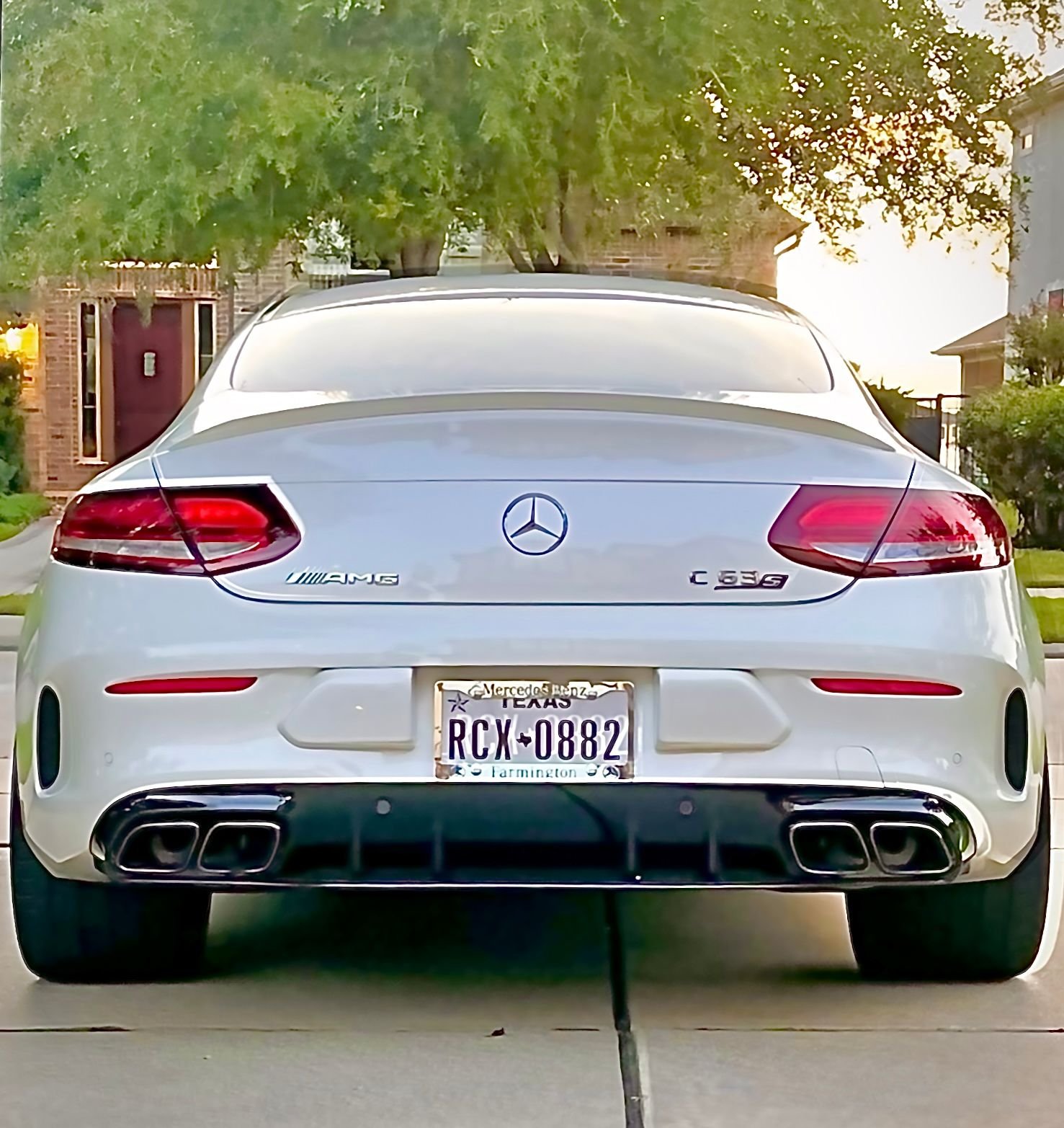

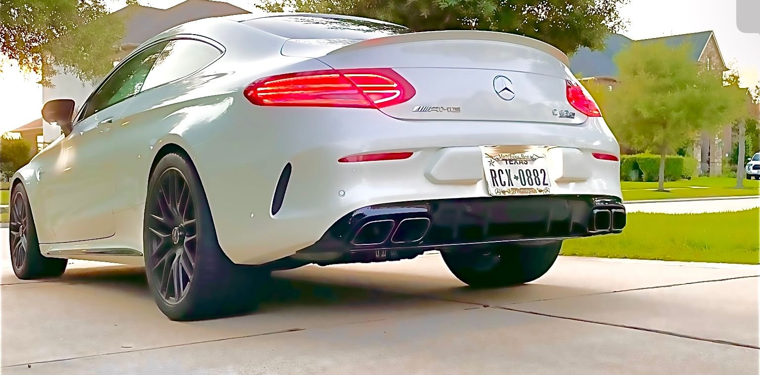

Thanks for all the input. Yeah the stock rear suspension is still darn near new, with only 4.1k miles on it so far. I’ll check the wheel wells / inner edges of tires for any rubbing. I’ll go with a 5-7mm spacer as you suggested if I do see any evidence of rubbing, but I’ve put on 4k miles on my beast on these 305’s and haven’t heard or felt any rubbing as of yet, so hopefully I can leave it alone as is. I definitely don’t want to mess with rolling fenders. I did go up in tire size mostly for a more aggressive stance / look so I’d welcome an even more aggressive stance if I do end up going with rear spacers. Our Houston roads aren’t the best in some areas with respect to potholes but they’re relatively rock and debris free, at least in the areas I drive in the most.
Here’s a couple of pics of my diamond white coupe on 305’s. I had to enhance the contrast so the tires would be more visible.
