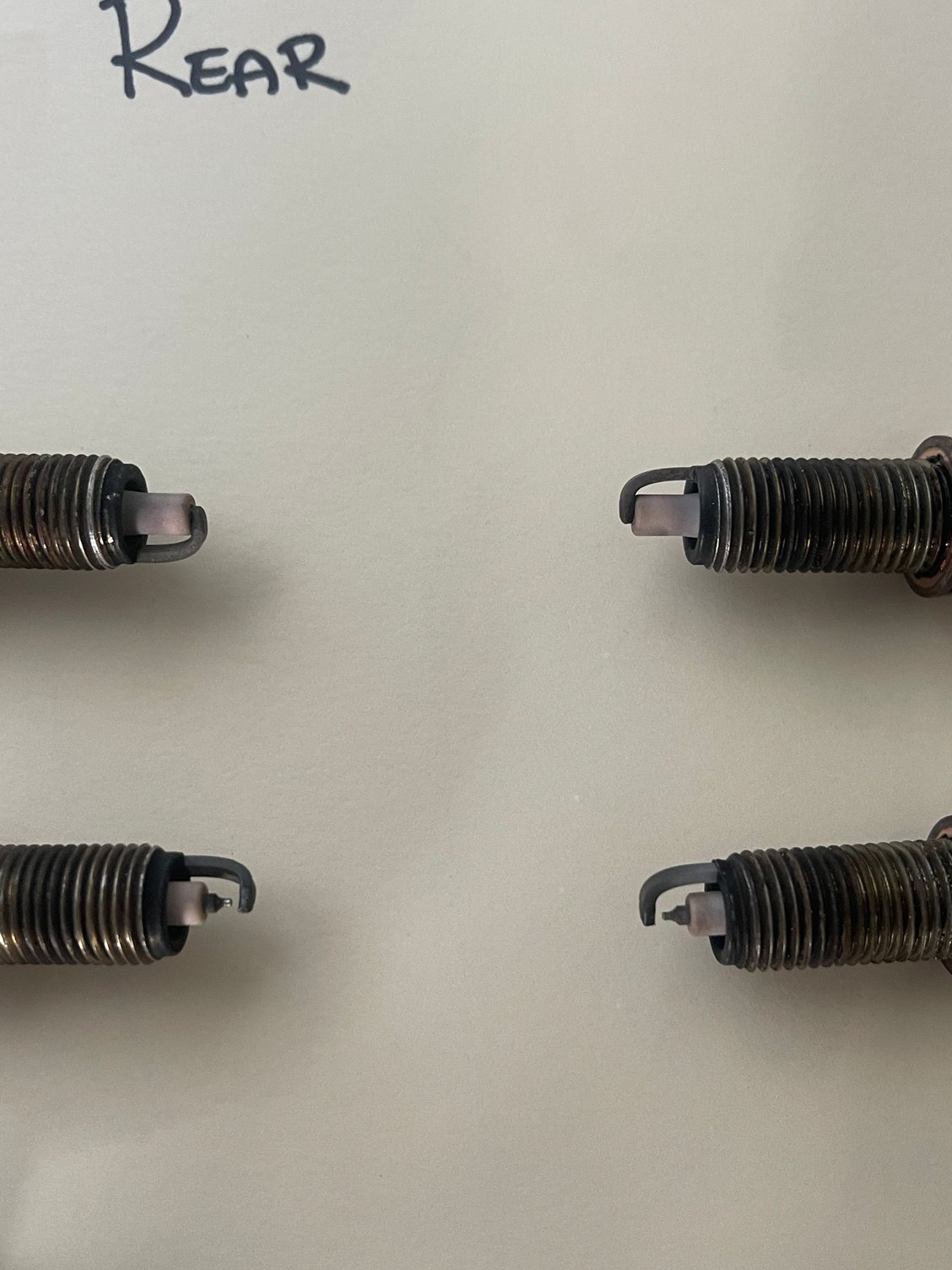

So after purchasing my 2017 c63s around 2 months ago , car developed a few issues , rough idle , minor misfires . Car only has 20,000km
took the car to a reputable workshop to have a full inspection and replace all fluids etc and was advised spark plugs in great condition .
Being un satisfied I went ahead and ordered a set of HKS spark plugs and went to work replacing them.
what I found was the 2 rear spark plugs ( furthered back on each side ) had the ceramic sleeve come loose and essentially blocking the spark .
has anyone experienced this before with the factory spark plugs ?
car runs like a dream now

*****That can happen with pretty much any plug. It's a twin turbo car with a lot of power. A slightly off injector, or weakened coil, or bad batch of gas can cause pre-ignition or a bit of detonation and it damages the plug.
Glad you replaced the plugs and figured it out. I replaced mine with factory plugs and the old plugs looked fine but I was already swapping out turbos and other stuff so the plugs were an easier job with so much off the motor already.

A while back I was having an intermittent rough idle that would only occasionally throw a CEL which would go away when I turned the car off and restated it. Eventually it threw a CEL that stayed on that I could have diagnosed and it was a misfire in cylinder 7. I changed all the plugs the next day and that resolved the issue. Turned out to be a failure of the Cylinder 7 plug that triggered the CEL. The ceramic broke and dropped down, covering the electrode. Before it finally gave way I assume it was loose and causing the intermittent issue I was experiencing, but hadn't completely failed yet as there was no CEL.
My car has been running fine ever since I changed the plugs.

I ended up changing out my spark plugs and come to find out two of the 8 had the little ceramic piece broken and loose causing issues with the spark just like the member above. After the change car runs amazing, idles smooth and pulls so much harder. Down below i posted a video showing the broken spark plug.
