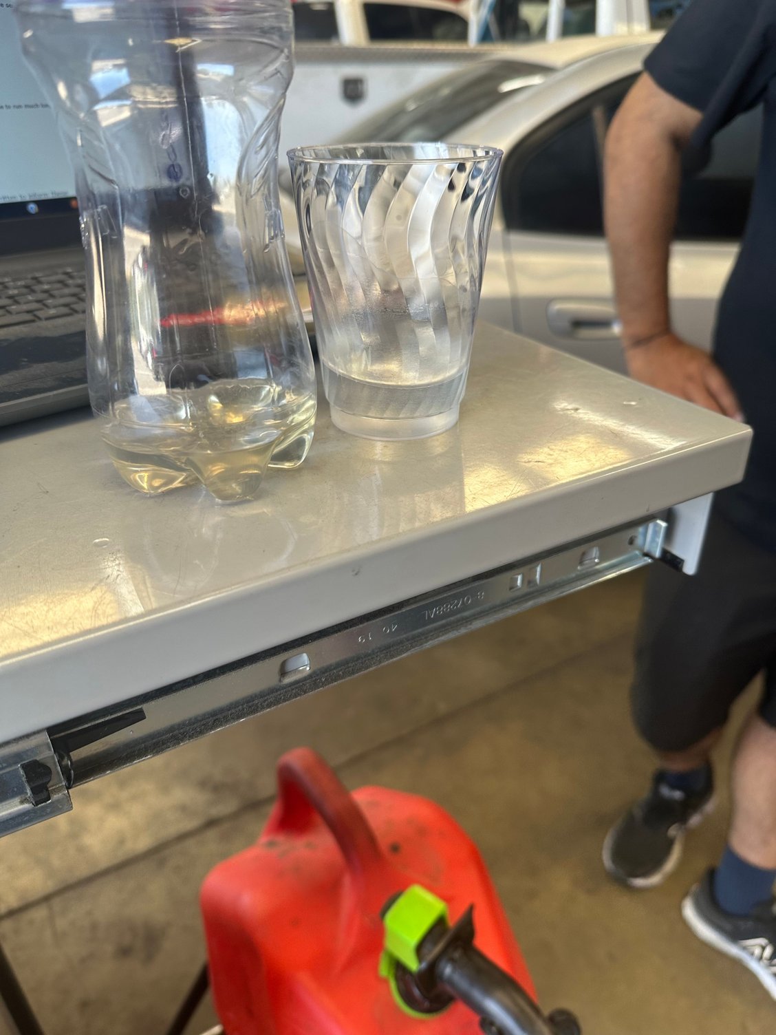

vtatla408's Avatar
Joined: Jul 2023
Posts: 4
2017 Mercedes C63S AMG
Originally Posted by chassis
Please post the mechanic’s photos indicating mixed fuel. Thanks.
Here is a picture of the fuel. On the left is what they pulled out of the car and on the right is fresh 91 from the gas station.

chassis's Avatar
Joined: Sep 2018
Posts: 14,694
Likes: 4,584
From: unbegrenzt
2017 GLE350 4MATIC
Thanks. I don't see anything concerning. Slight color difference, but does anyone know for certain why? Fuel is not the cause of the rough idle.
You have an early build M177 4.0TT and this engine is known for misfires which can lead to rough idle. Search this site and you will find that coils and software (coding) are the dealer field fixes.
On a car this new, sensors should be assumed OK (cam, crank, cam solenoids, O2, etc.). I would put new spark plugs and ignition coils in. If the problem persists a software fix from the dealer would be the next course of action. Need to find a campaign number or TSB. I think the W213 AMG guys know about this.
