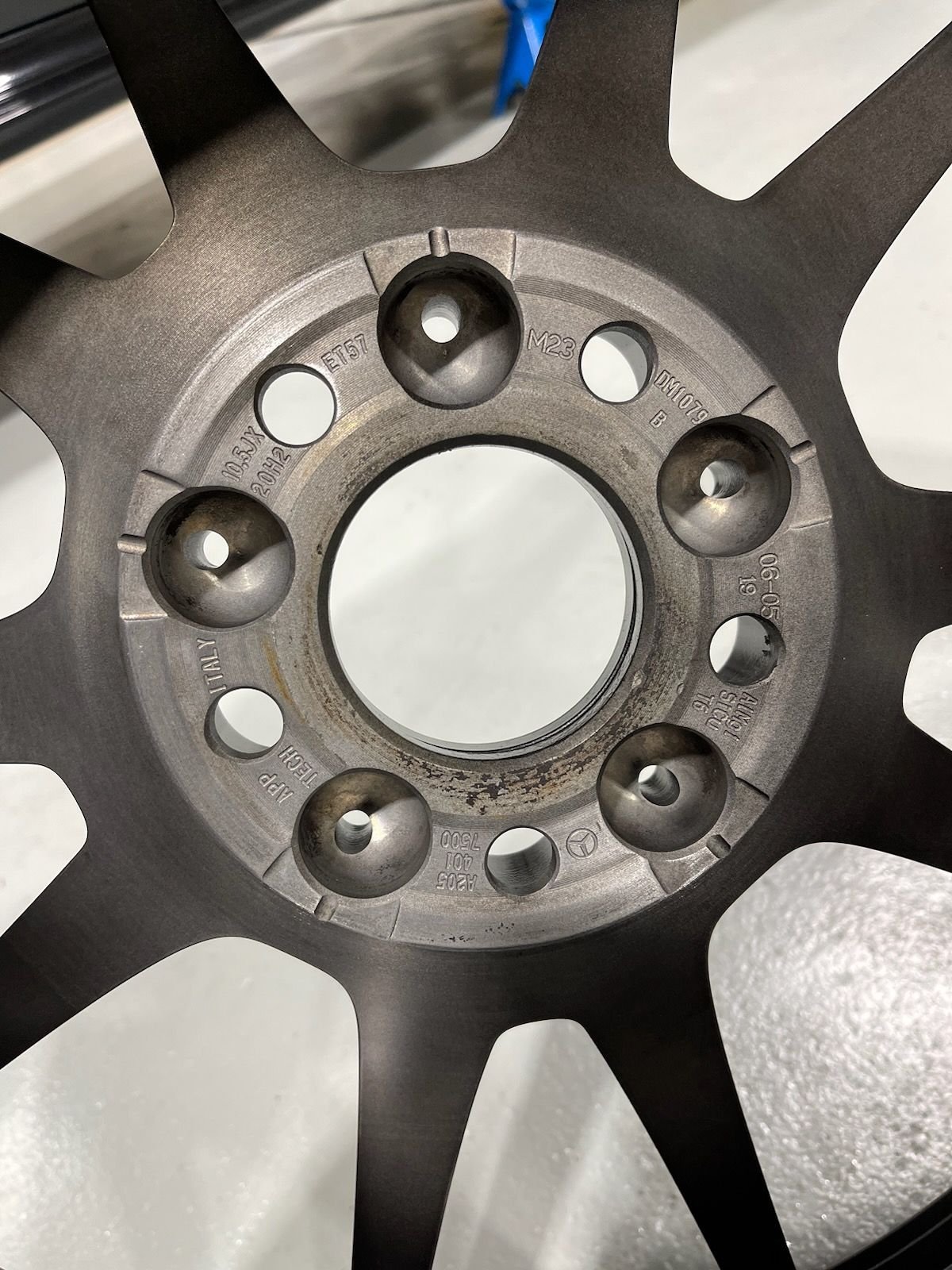

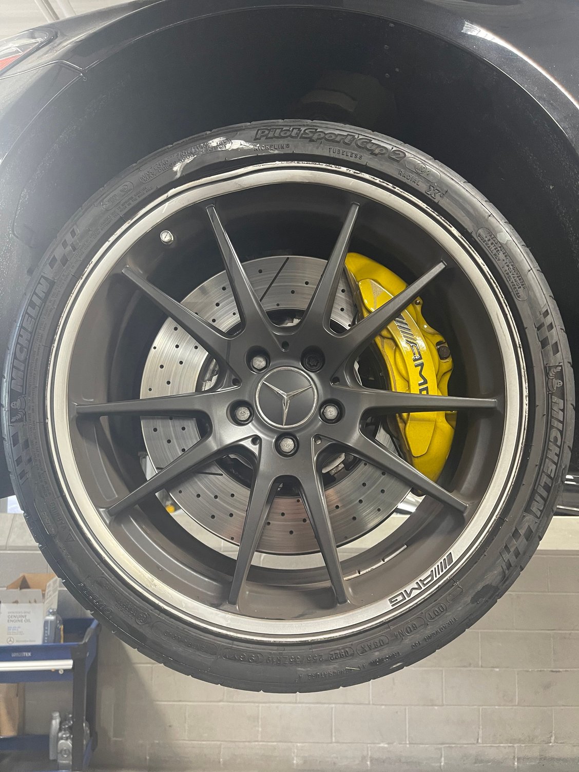

Looking to upgrade my tires
i have a 2020 coupe c63s
fronts are 255/35/19
rear are 285/30/20
i want to upgrade to 275 and 305s
is this possible and will I have enough clearance.
i will attach a picture of my current rims
ignore bent rim, i fixed that hahah

Yes. I went with 305R / 265F Michelin 4S tires on my 2021 C63S coupe, and mounted 305R / 275F on my 2023 coupe. No rubbing or clearance issues whatsoever, just make sure you run the correct psi’s or you can possibly experience rubbing on 275 fronts.
