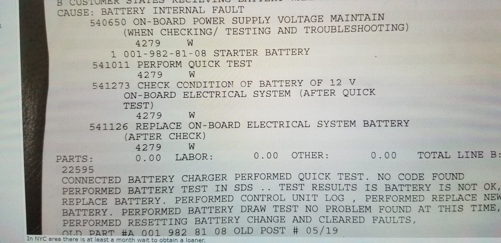

After 3 1/2 years my 2019 C63S coupe (purchased new) displayed an On Dash warning: 12V Battery See Operator's Manual. The Manual noted to Leave engine running for a few minutes, or drive for a longer distance. The Battery will charge. Note this happened right after the car was at the Car Spa for 3 hours. Also note that
for some time my Mercedes me Connect was displaying Battery as Partial Charge. So right after the On Dash warning I called the MB SA and he recommended to bring the car in to have the battery inspected. So I drove over and the Battery was not ok and was replaced, to my surprise, under warranty. It took about 2 1/2 hours so I waited. Not sure what it would have cost if it was not cover under warranty.
It may be that the car needs to be driven for an extended period but to be sure I would wait and have the MB dealership do an inspection on it.

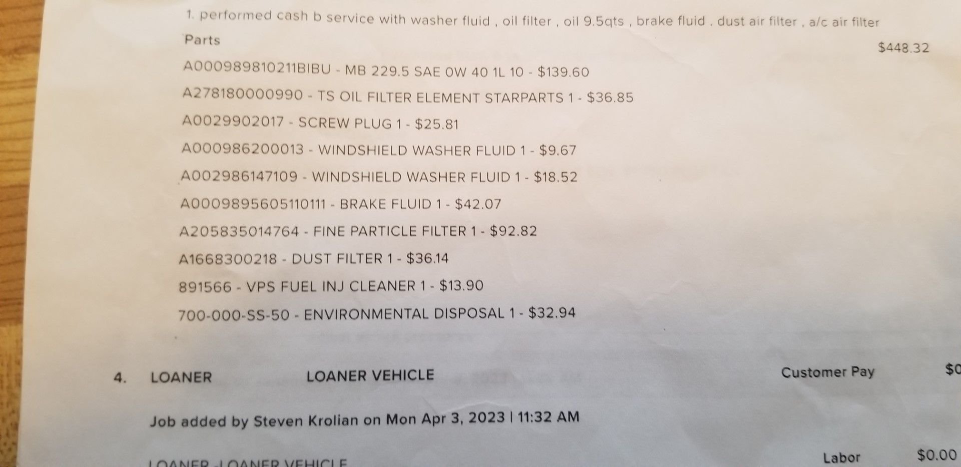

The Mercedes Benz B Service is required every 2 years or 20,000 miles. If your newly purchased 2021 has not had it done already the photo below shows what is performed and the part# and price for B service. I had my done 2019 C63s coupe at a MB Dealership and cost $963.32 or may want to use an Indy. I glad the car checked out for you.

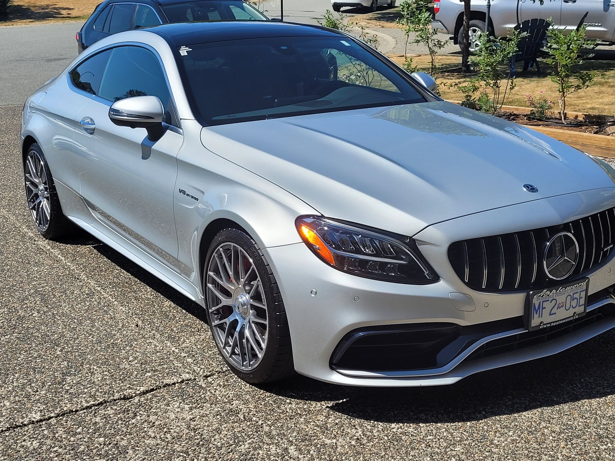

Mods likely
Need to change the piano black center console, as I can't take the fingerprints. Carmarka in Dubai has one that is bot obscenely expensive so may try that
Front lip had a bit of damage on the top edge (you can see it in the pic). I think the RWCarbon GTX Carbon Fiber Front Lip looks like it overlaps the stock one rather than sit underneath, so that would fix that
