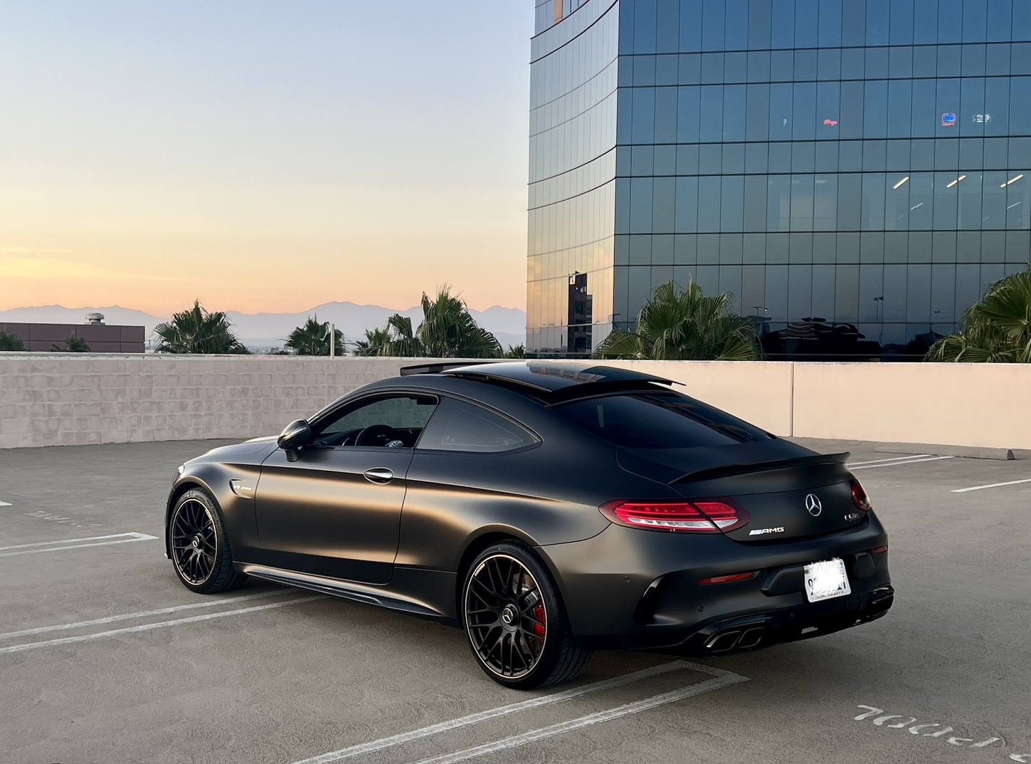

​ Hey guys, I am fortunate enough to get a 2023 C63S v8. Fully loaded, Every single option ticked. Full-body PPF'd. Here's my question...
Do I still need to get a Rear Differential Oil Swap @ 2,000 miles? Mercedes is saying no.
Backstory: Previously, a C63S would come with a window sticker saying at 2,000 miles a rear differential oil swap is needed. This is due to the metallic debris caused from breaking-in a brand new rear differential. They were so strict about it, that your rear-diff coverage under your warranty would be voided due to not following the break-in instructions. This 2,000 mile service was included in the price of the vehicle.
Now, present day, Mercedes is telling me it's no longer needed. Could the engineers really have solved this? I highly question that, furthermore manufacturers such as BMW still require it at 2,000 miles for their M series (apparently).
Apparently if I wanted to foot the bill and have it done out of my own pocket it would be $400-600.
Have you guys heard anything about this? Is it still required? Thank you

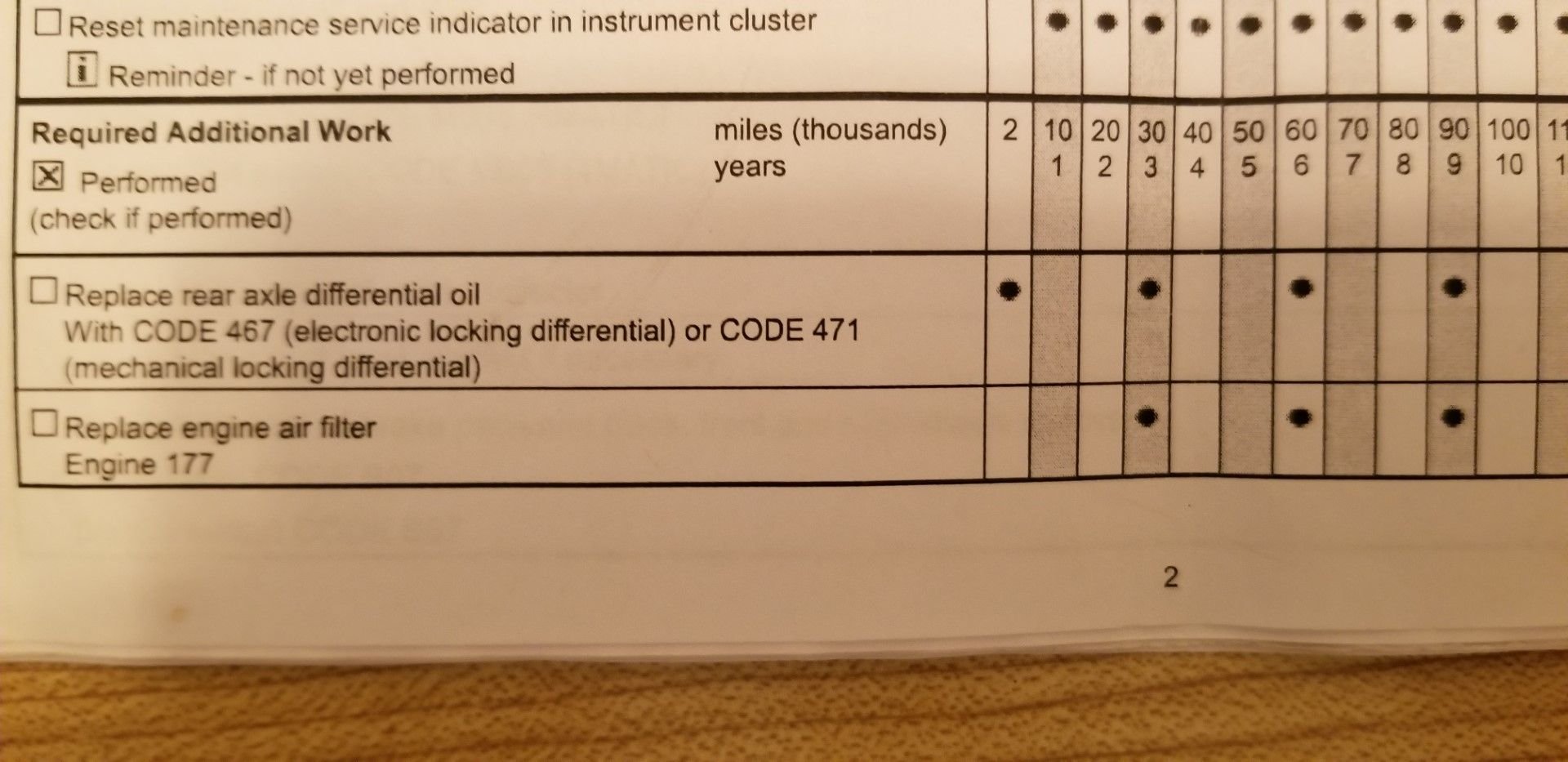

My new 2019 C63s coupe had the window sticker stating in addition to the Notes on the Break in period that the rear differential oil must be changes at 1,875 miles. (See photo below). So I had it done I believe just before the 1,875 miles at ther MB dealership for $255.97. At this time (2019)is was questionable if it needed to be done anymore. The SA reminder me to have it changed again at 30,000 miles or 3 years .
According to the MB Service Maintenance Work Sheet: Required Additional Work it states : Replace the rear axle differential oil at 30,000 miles or 3 years. So I had it changed at MB in May 2022 (3 years) at a Cost of $260.59. See photo below).
So if it's not required anymore at the 2,000 miles then when to they recommend it be changed at 30,000 miles or 3 years?
beautiful car.
Still every 30k or 3 years like before. Mine was changed at the 3 year service.

Congrats on your 2023! However, if that’s your car in the pic, it’s not an FE unless you made some aftermarket changes. Final Editions don’t have the full night package and have black calipers, side and trunk yellow race stripes as well as FE badges on the rear c pillars. It also does not have every single option ticked. The red calipers indicates it has standard brakes instead of ceramic brakes ($5,450 option). Maybe it’s the pic’s lighting, but the rear diffuser and spoiler appear to be gloss black instead of cf. If that’s the case, you’re missing the exterior Carbon Fiber I ($1,750) and Carbon Fiber II ($2,950) options.
It’s still without any doubt a gorgeous car. It looks just like mine which has almost every option ticked, the only 2 worthwhile options that are missing on mine are ceramic brakes and rear passenger airbags. I also got mine fully PPF’d. What color is your interior? Was this your own build or did you find one on a dealer lot? As of now, there are only 6-7 non-FE coupes remaining for sale in the USA.

Hey! You're right! I mislabeled it following a similar trend seen elsewhere, it seems there's a trend of 2023 buyers labeling theirs as Final Editions even without the sticker pack as they're 2023, even rarer and include night package. This does not have the $33k "sticker-pack".- my mistake.
I imagine these are some reasons why others have started the trend;
  • If the Final Edition had unique traits (a la Edition 1) or performance gains, I imagine nobody would call theirs that, however, intrinsically some would argue due to the immense rarity of the 2023 v8's they're all 'Final Editions', some just without a $33 Thousand sticker option + Removal of Night Package...
  • Personally, I like the Night Package. And spending 33 thousand for Stickers felt wrong.
  • America also received less 2023 Non-Final Editions than 2023 Final Editions. All in all, I got mine for MSRP with no markup for $106k + Tax. Final Editions started at 134k + Tax.
Why did I buy this one in particular? All 2023 Non-Final Editions are theoretically rarer, and have their Final Edition step-brother's anchoring a high price next to them for life. Sure, the ones with the sticker pack will retain a higher value over time, simply due to a higher sticker price, however the Non-Final Edition 2023's will be right beside that, anchored to the hip, why? Non-Final Editions simply look better stock with Night Package, and are rarer.
She indeed has Carbon Fiber 1 & Carbon Fiber 2 + Carbon Trim & Steering Wheel. The interior is Red Nappa + AMG Performance Seats.
I had been working with Fletcher Jones in Newport Beach for 12 months looking for the perfect spec in the used category as there had been no mention of any future C63S V8 in production. To everyone's surprise, Mercedes shipped these 2023's without even as much as a press release or social media post, completely ghost-shipped them. Was this due to fear with the upcoming plug-in hybrid release? Who knows.
Fletcher Jones in Newport Beach said no customer-builds were available, only pre-specced C63s' on their way from Germany. I called other dealers and they confirmed this. So, to my surprise, I went on a hunt for the nicest optioned one in California (Minus Carbon Ceramics) and found one - Fresno, CA had my pick of the litter. I have been following the market closely and you're right, there are practically none left in USA, especially ones that are well-optioned, and MSRP(or close). The stealerships who still have some available know what they possess and are asking ADM's. This past week, a used 2023 with a few thousand miles on odometer was listed for $120k. Made me smile!
P.S. - The 2023 v8 versions are much, much louder than previous Facelift C63s' (2020, 2021's)
After writing all of this, I do laugh at myself mislabeling it a Final Edition, perhaps it's even better? I shall dub it moving forward, the Ultimate Final Edition!

Yes. My early 2019 C63s coupe had the window sticker: the rear differential oil must be changed at 1,875 miles which I had done and again at the 3 year period.
It was ambiguous even in 2019 about this issue whether it needed to be changed.
Now the direction from MB for the 2020 to 2023 is that it no/ longer needs to be changed at 1,875 or 2,000 miles. Thus according to MB Service maintenance schedule the next time and the 1st time the rear differential oil change will be done is at 3 years or 30,000 miles. A big difference from MUST change at 1,875/2,000 miles to now 3 years/30,000 miles.
I was looking to find a MB Service Bulletin, Memo, Document that address this issue and what specifically was done or modified what was done, if anything, to now determine that the differential oil no longer needs to be changed at 1,875 miles or 2, 000 miles? I could not find any such MB bulletins regarding this issue.
Just curious about this issue.

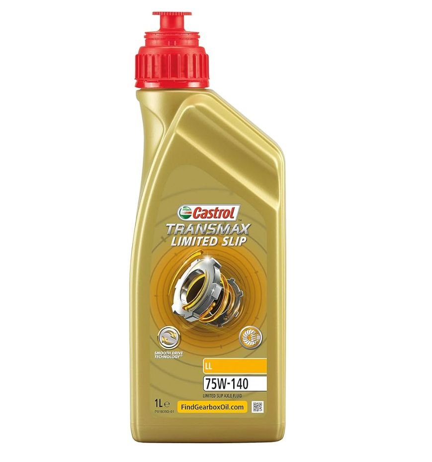

Anyone know what differential fluid to use? I have a 2019 c63s and went to the dealership parts department today and they tried to sell me 85w-90, but I told them I'd hold off as I saw a lot of posts saying it's 75w-140? I asked if they had any 75w-140 and parts guy told me they do not sell the oil at that weight.
I have a 2019 C63s also and had the differential oil changed last year. I will be home Sunday night and will look for the MB Invoice to see what fluid was used and post a photo of the Invoice.
Awesome, thank you. I was sure it was 75w-140 from searching the forums until parts guy told me otherwise! caught me off guard haha.

Do it yourself it's easy. You'll need 19mm hex socket for drain plug 14mm for the fill, 1.5 L of 75w 140 gear oil, I used 2 bottles of castrol syntrax I thinks about $25 each. When I drained it out at 2000 miles the oil was a very dark green color.
The MB part # 001-989-52-03-10 listed on my invoice (photo below) looks like they used 75W-140.

So my dealer got this one, is it ok? They say us the new version of the Syntrax. Thanks
