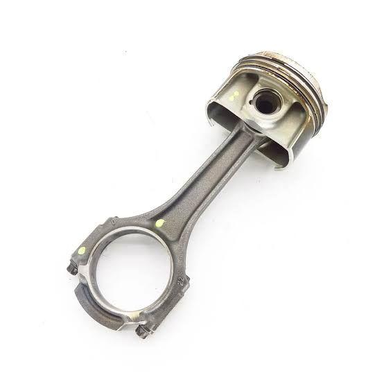

Just browsing on FB, came across so
someone claiming FL c63S don’t have forged pistons. When asked for proof they said “my own pistons when I took them out”. This actually true? I thought all the c63S PFL and FL ran forged rotating assemblies.

Same part number for both facelift and prefacelift on EPC A1770300800 so that's already raising suspicions of bullsh*t.

agreed. I very much doubt Mercedes would got the trouble of having another part made of weaker material, risking warranty claims.

Even that turned out to be BS as far as I remember. FWIW, the above piston seems to be for the GT. The different power levels of the M177/M178 use different pistons. Some are forged and some are not as far as I know and they have different shapes. I got to see the different pistons when I did the factory tour.
