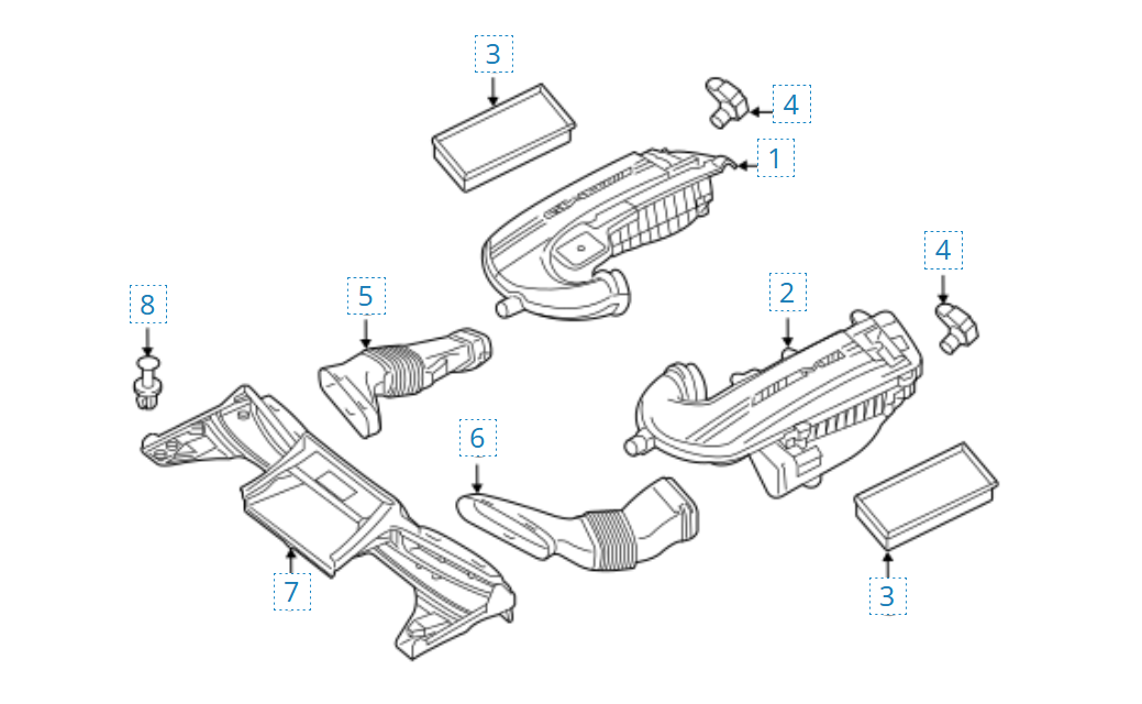

I have a 2016 c63s and the air intake ducts cracked. I was unable to find any instructions or videos on how to replace them. Anyone has done it before and can help me with instructions? The parts that need to be replaced are #5, 6, 7 in the pic.

I have a c350 and changed them out recently, almost the exact same. At least for me, there was no need for tools. The clips shown near the arrow of 6 clip into the shroud of 7 just push them down and pop it out, The other end of the intake should just slide off the air box

Thanks. I looked a little closer and looks like the screws (#8) are the only thing I need to remove to replace the parts.

Does anyone have an MB part number for #7 in the diagram above? Mine is toast and I need to replace it before it crumbles into pieces more than it already has. I have the 2018 C63s instead of the 2016 model year, but I'm thinking that part carries over as common through those years. Thx -
