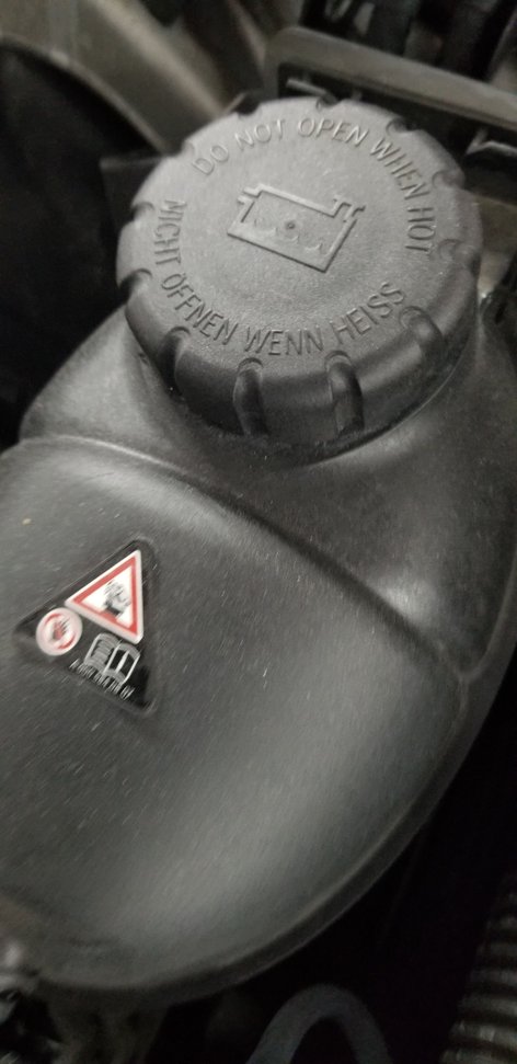

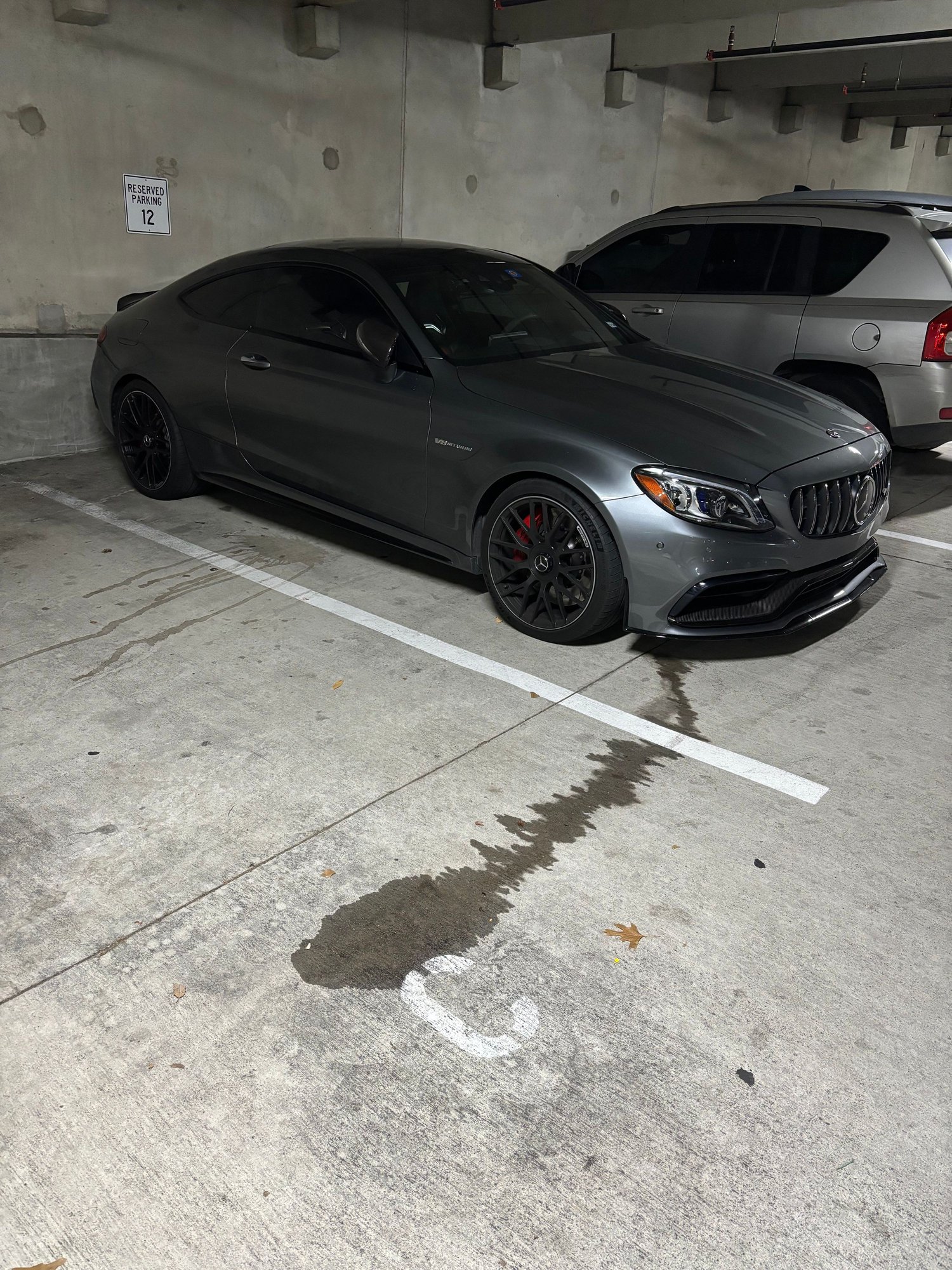

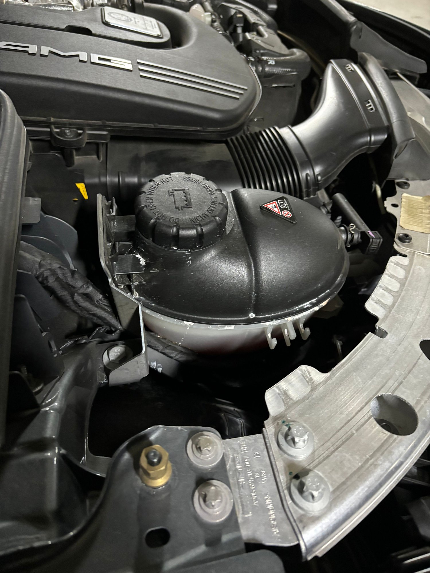

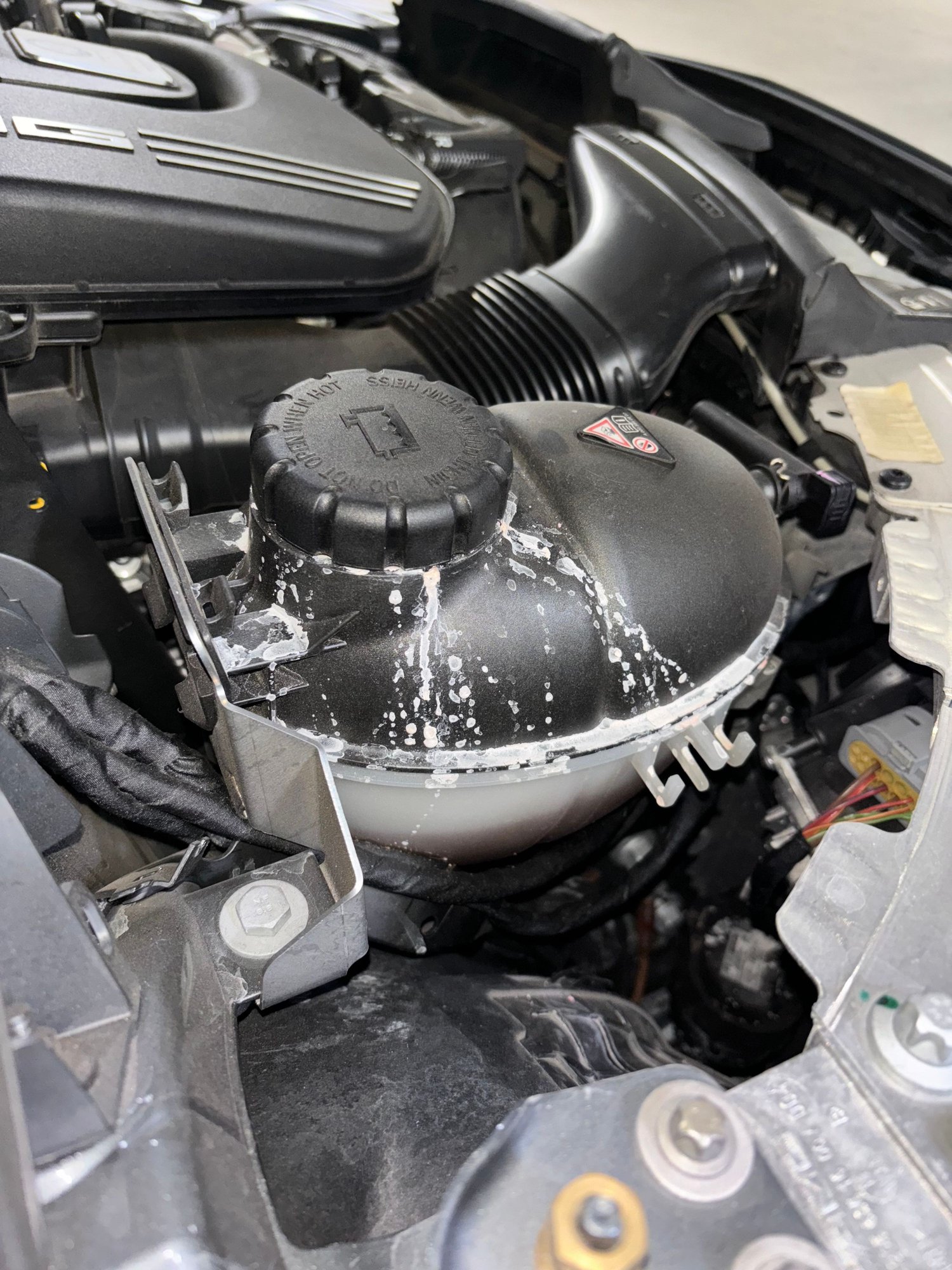

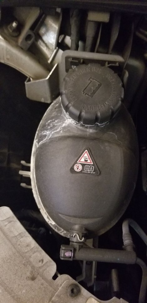

Last winter I got a low coolant warning, took it to the dealer, said that I thought I had a coolant leak, they said they didn't find a leak, topped it up with coolant, sent me on my way. A few days ago I got the light again, checked and saw the coolant looked low and that there was coolant residue all over the expansion tank, seemingly coming from the cap. Bought OEM coolant, mixed with half distilled water, added a couple of cups (couldn't find the fill marker) and the message went away. Yesterday I saw a visible leak below the car, it was back down to its low level with the light on again, and there was a tiny bit of residue on the top of the expansion tank that I had cleaned off. Not enough residue to be the whole leak. The level was the same as before I re-filled it, a few inches below the top of the bottom, translucent portion of the tank.
Still waiting another week on my appointment with the dealer. Could it be a head gasket? Anyone have any similar issues? I've seen a few posts on the forums about leaks from the caps but this can not all be leaking from the cap. Anyone have any idea where the fill marker is for the c63s? My tank doesn't seem to have the marker that my c300 manual seems to indicate it should.
Before cleaning and refilling
After cleaning and refilling (the level was a bit higher but already had started leaking again)

Most likely just a faulty cap. Does the engine or trans overheat? I replaced my cap at relatively low mileage for a faulty o-ring seal on the main expansion tank.

You might have just overfilled the tank. When the coolant gets hot and expands it will have no where to go but bleed out.

No, temps are all normal. Oil no higher than ~223 after the hardest of hard pushing, about 215 more generally. Thanks for sharing about your cap.
Regarding a possible overfill, how would I even know what to fill it to? Does your tank have the little cross that is indicated by our c300 manual in the bottom of the tank? Mine doesn't seem to even have that marker. And the manual seems to just be a c300 manual with an AMG supplement that makes no mention of coolant.

I usually fill mine a little bit halfways from the seam across the exterior of the expansion tank. Mine does not have that cross. It’s a bit misleading in the owners manual.

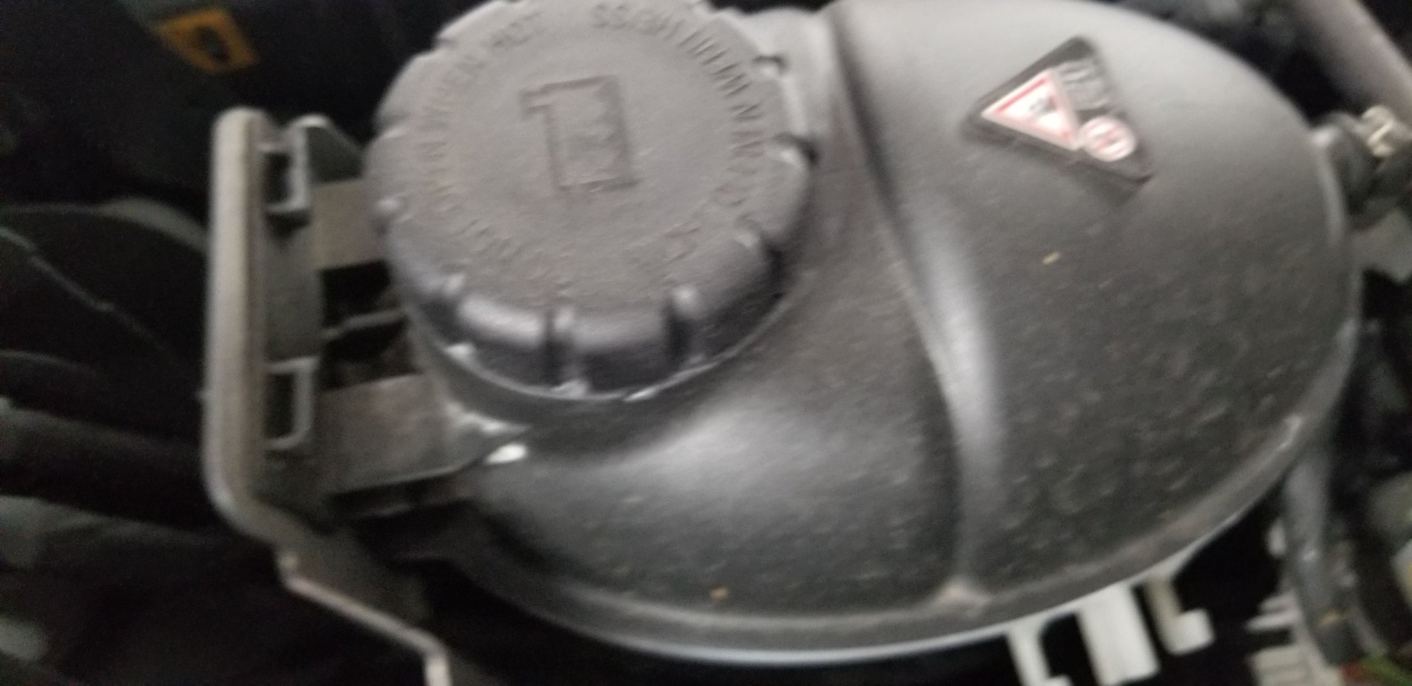

Last August I noticed residue around the expansion cap (2019 C63s coupe). I called MB MB Dealership and SA bring it over. So that morning while the engine was cold I opened the hood and realized the cap was not properly sealed. I turned it until I heard the click.
I still went to the MB service where the tech. cleaned the outside tank, did a pressure check and said it may have had too much antifreeze in it or the cap was not properly sealed. I never messed with it but had the yearly service at MB in April. So who knows if it was carelessness.
Since I was already at the Dealership I was going to purchase a new cap about $55.00 just to be
sure but the tech said everything checked ok and did not feel I needed a new cap but did say keep an eye on it and if so then purchase a new cap.
Your post is a good reminder for me to check it now
as I have not looked for some time.

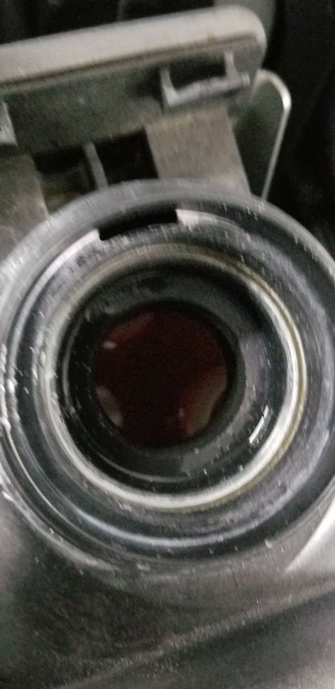

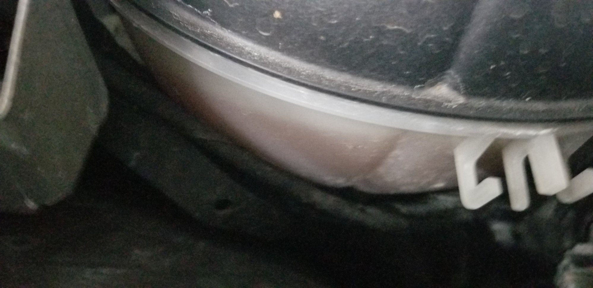

No. The SA had the tech waiting when I arrived so "gratifull" to both. No mention if any coolant was removed or added.
When I opened the cap that morning it as I remember was half full or so.
Today (see photos) the outside tank see relatively clean but a small amount of residue on one side. Inside the cap seems to have some residue around the inside threads.
The inside tank appeared to just fall just below​​​ where the translucent section meets the dark tank. So not sure if that is where it should be when the engine is cold.
Also I am going to view my MB Service invoiceithst was done in April, 4 months early. I be looking to see if any coolant was added and possibly too much or just neglect to tighten the cap. Or is it time for a new cap.
So other feel free to comment on
the condition of these photos. Do I need a new cap or is this somewhat normal

Looks like the O-ring seal might be leaking a bit. I would recommend replacing it. Mine failed at 14k on my 21.
Definitely will do. Could that o-ring leak really cause it to lose like 2 cups of coolant in a few days? I didn't see 2 cups worth of residue on the top but maybe it didn't dry out or something.

Our cars have a big skid plate where the coolant can be pooling up. If you’re hesitant have the dealer do a pressure test on the high and low temp circuits to verify no external leaks. You might have another leak somewhere but hard to verify without a pressure test. When I had a leak mine was the cap. Make sure you tell them you want a coolant pressure test. Show them the photos for proof. As far as it being a head gasket leak it’s not likely at all since your car is not overheating. It takes some serious aluminum warpage/deformation of the head sealing services to cause an external leak from the head gaskets. If it also helps my thermostat was replaced under warranty at 18k for a mechanical failure not a leak. They have extended the warranty for the T-stat up to 150k miles or 10-15 years via letter in the mail for owners that get an engine light for code p0128.
