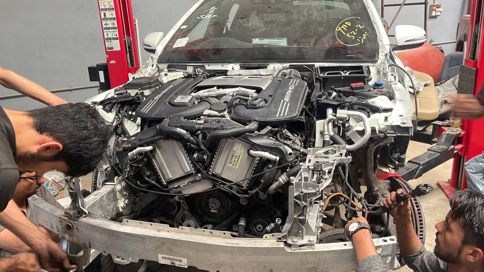

In Pakistan I bought a 2015 C180, stripped the car to the bare Chassis. After the c63s parts arrived from Dubai we pretty much took all the parts of C63s and bolted it onto the c180 chassis. Took us about 3-4 days to assemble the entire car. The entire project ( From importing the car from japan and sending to dubai to get stripped out and sending to pakistan) Took about 6 months time.

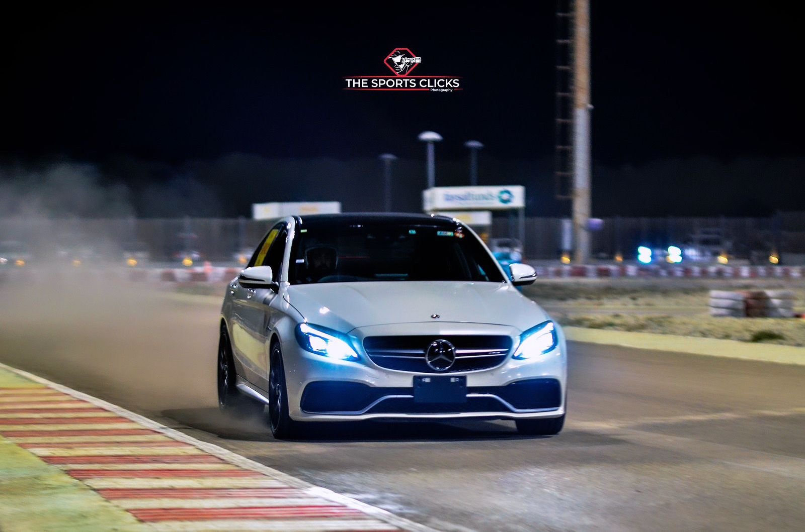

Hello everyone, apologies for the the delayed response, was getting the w205 ready for a local autocross event, surprisingly for such a heavy car she did surprisingly well. Came first in my category, was up against a couple of w204s, a few m5's and a 911. Slapped on some Nankang AR1 on the rear and turned down Boost a bit, im guessing I should be around the 600whp mark now, the car was not getting enough fuel on the map i was making 645whp, still running OEM HPFP.
No issues were faced during the conversion process, everything went smoothly. Faced more issues I guess while converting my w204 but I guess I learned a few things during that conversion that I implemented while converting the w205. The slight problems I did start facing was after getting her tuned, Went for PTG ECU/TCU and the car ran great for about a year, decided on going for the Modalworks Gen 2 intakes, and then the car started throwing crankcase codes on the PTG tune. Switched tuners, got a Custom tune now, car Runs much better now, E10+ 1/4 Bottle of Boostane pro per tank full tank mixed with pump 91. No knock what so ever, car still doing consistent 6-6.1 sec 100 to 200 in 80F ambient temps.
Mods : Catless dowpipes, Modalwork intakes, ECU/TCU tune.

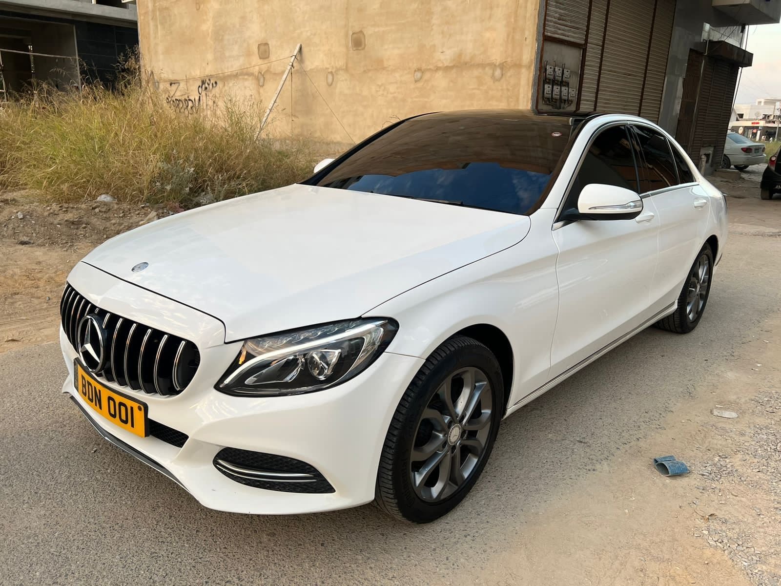

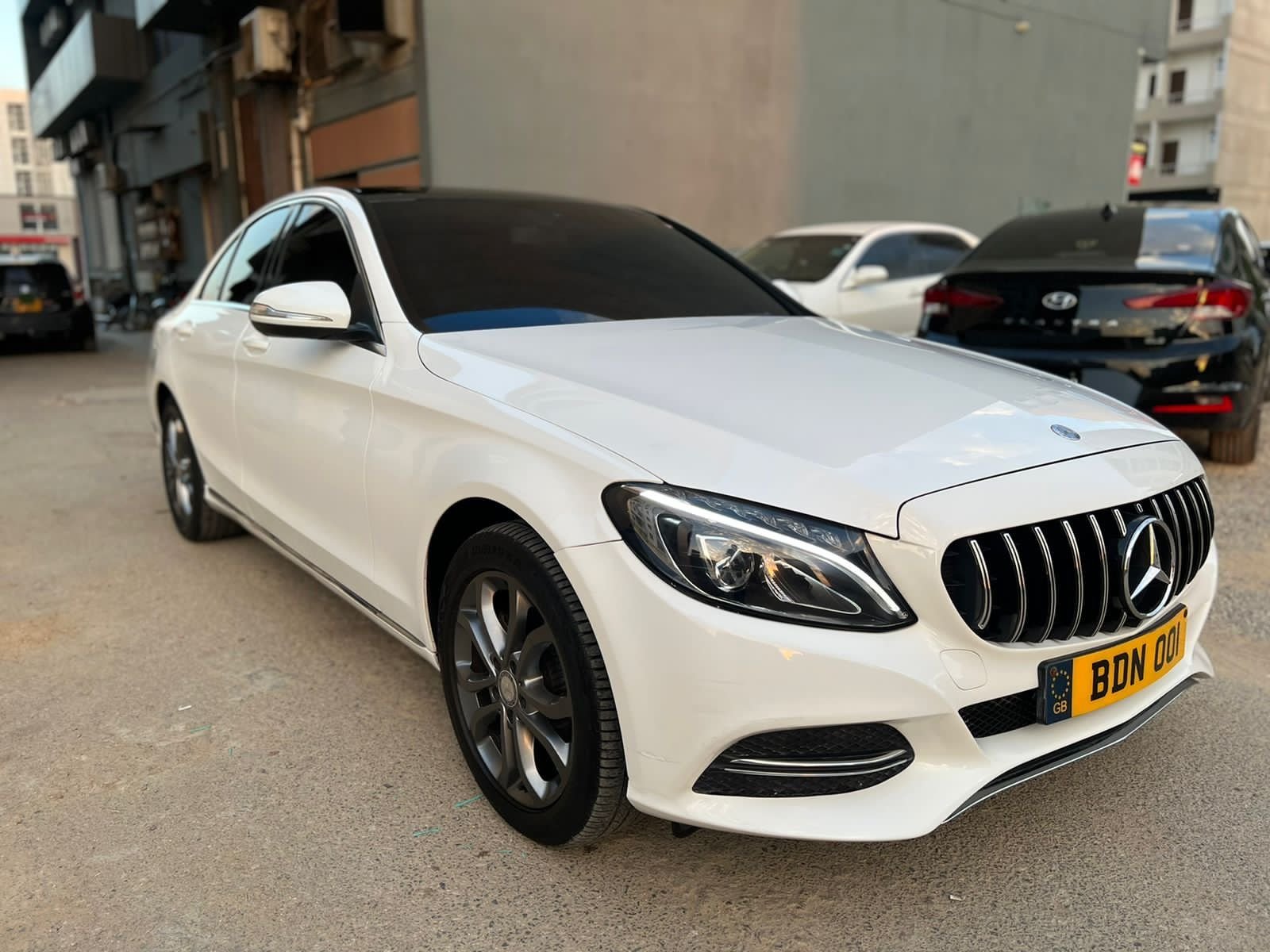

Base model I bought for the conversion c180
C180

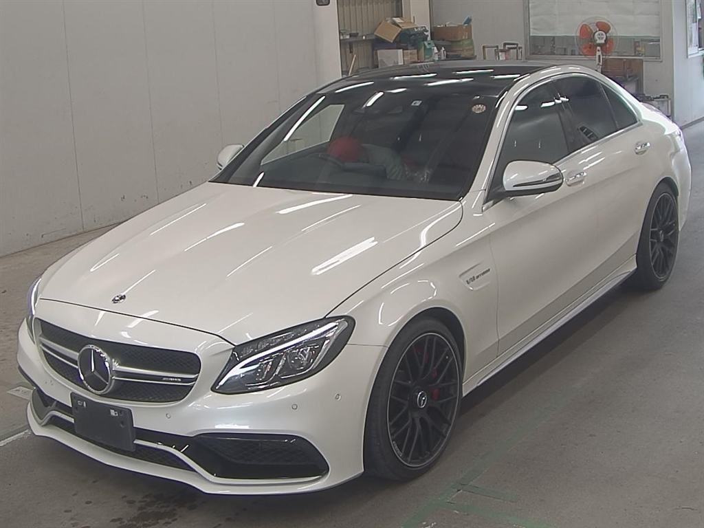

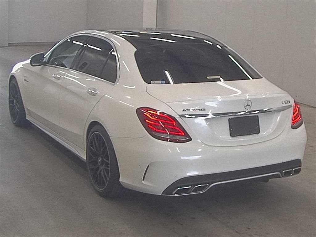

C63s Japan auction pics

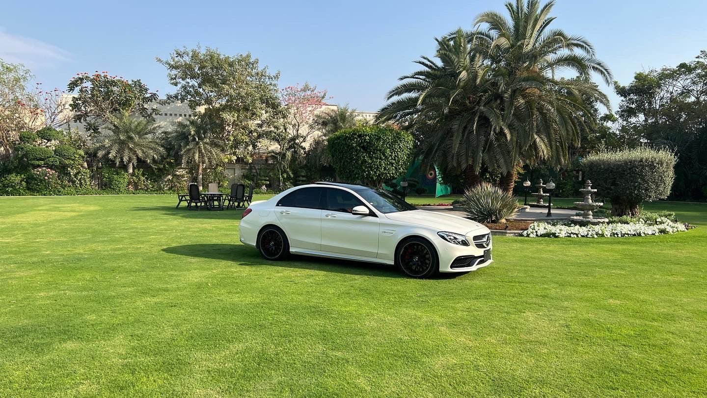

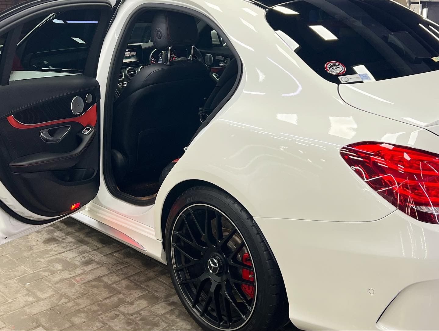

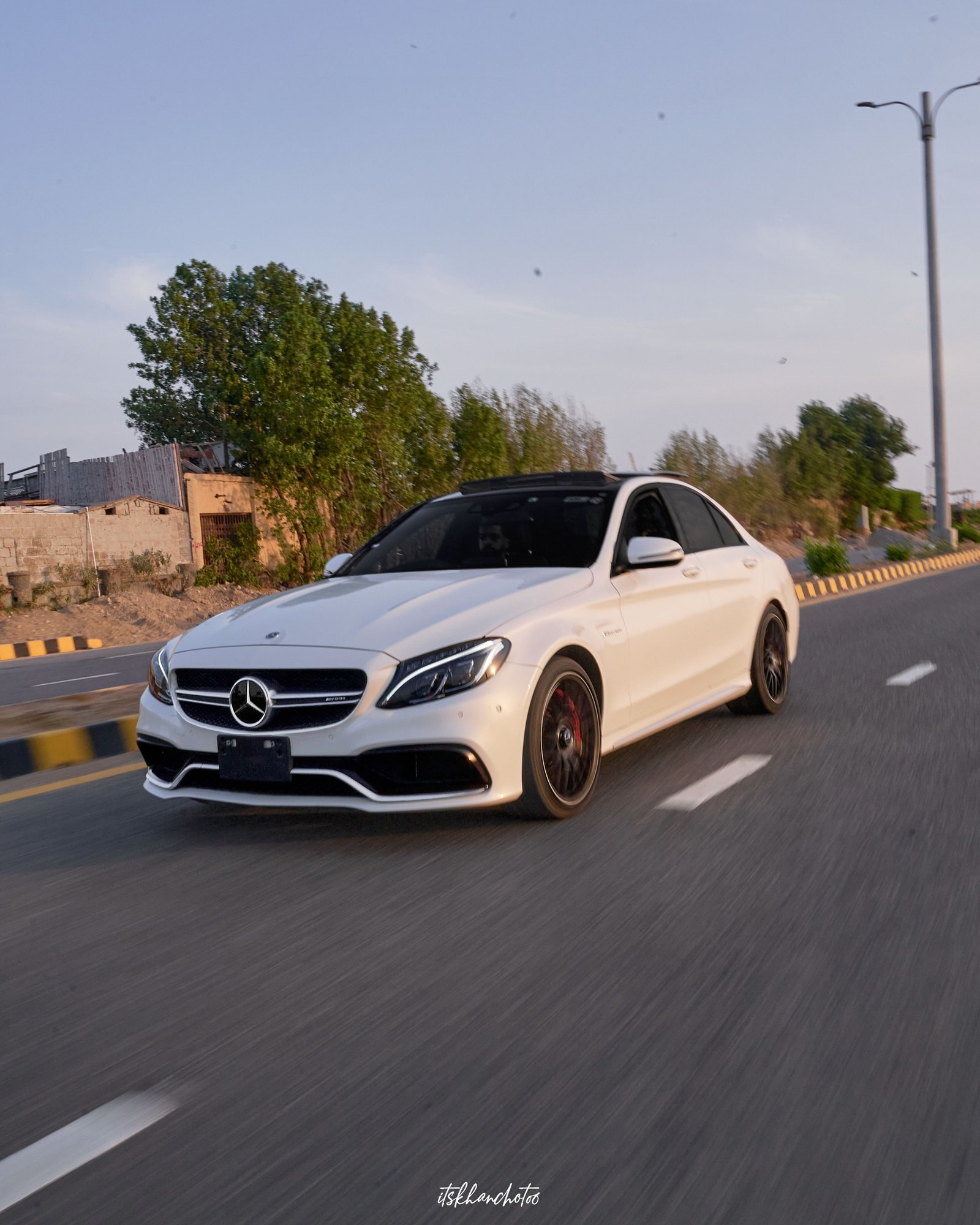

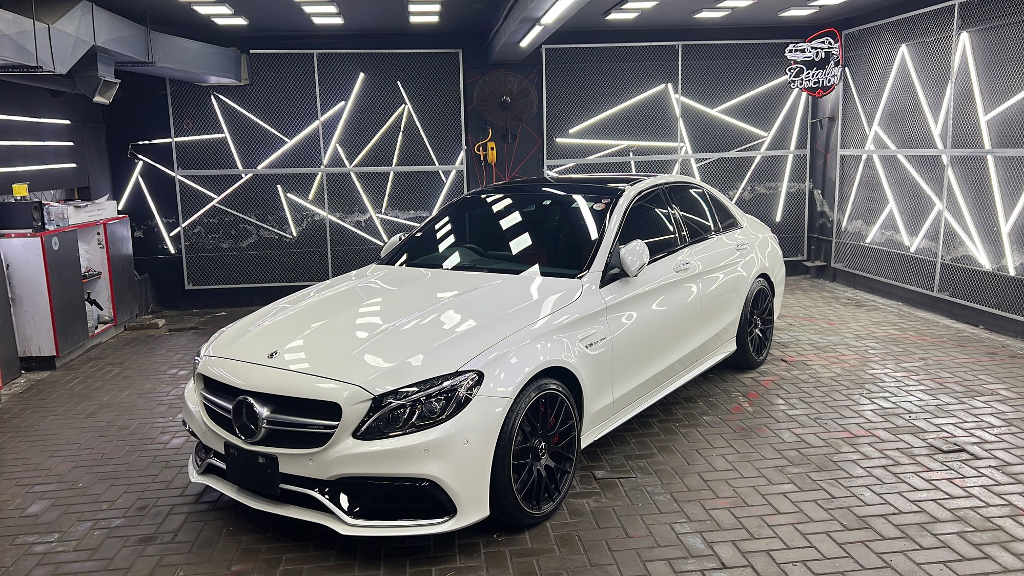

All the pictures attached are the final pics of the converted car. Tried posting some videos of how she runs but for some reason it isn’t uploading here.
Thanks
Alz
