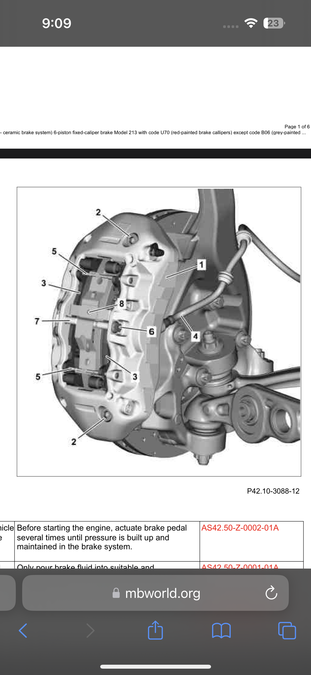

Hi, I was wondering what the torque spec was for bolt #6? It's the only one that doesn't have a torque spec in Wis. Additionally, I should use blue Loctite right? Let me know. Thanks.

They are M12 bolts in the torque chart. Don't use torque angle method. 120nm and you’re good to go

Isn't that for bolt #2? The one I am referring to is the bolt that is in the middle of the caliper #6.

mb lol. Can’t find the spec on wis weird. I looked up w204 c63 and the torque sec is 25 ft lb

I ended up going with 30nm as it was plenty tight along with blue loctite. Will update how it holds up.
