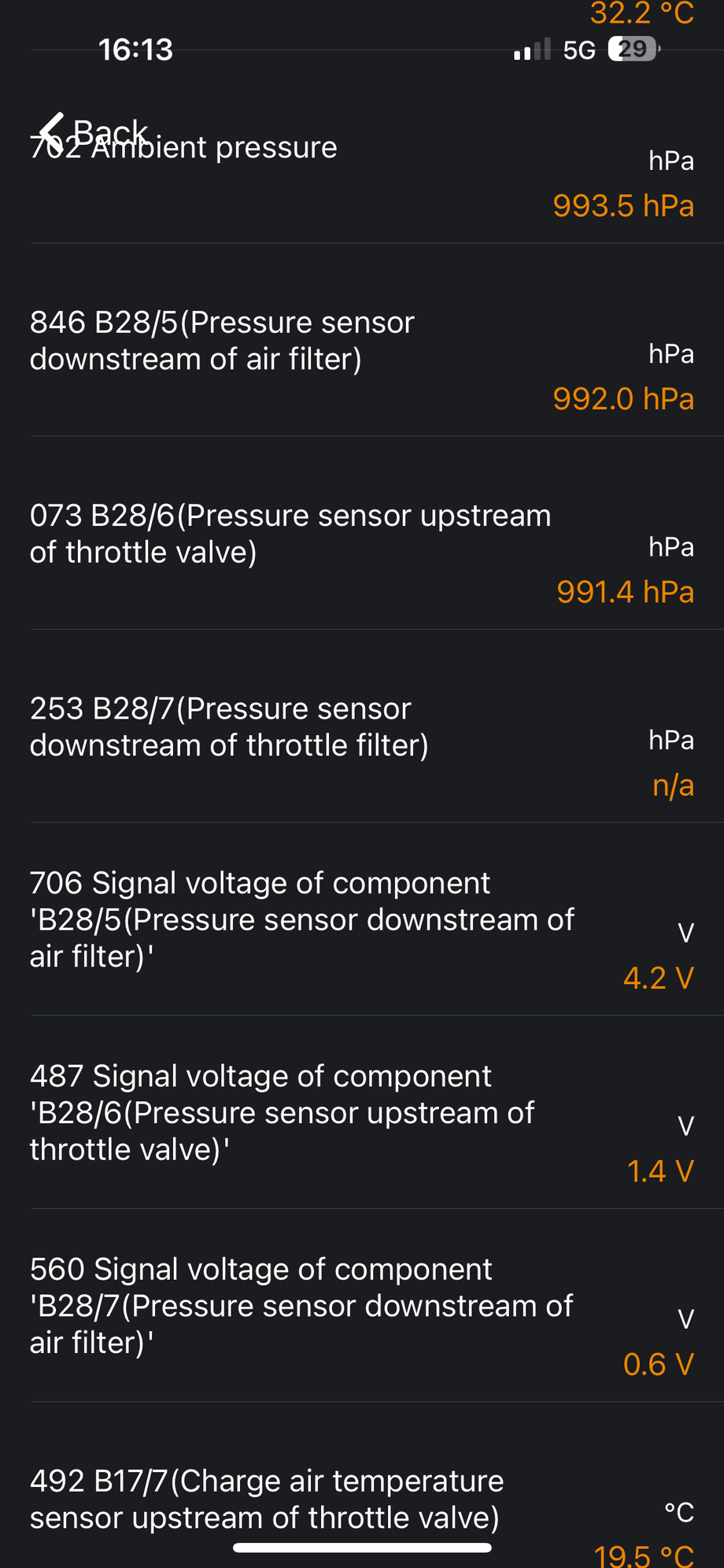

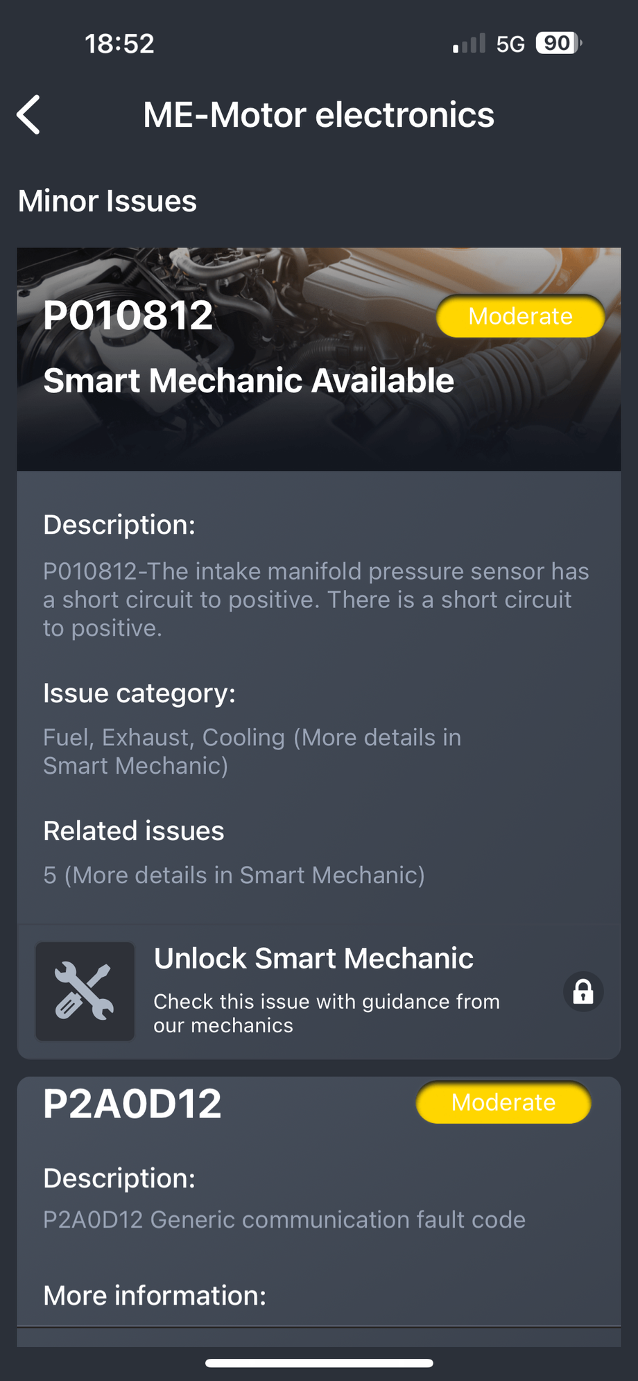

Hello I have 2 fault codes on my c63sP010812-The intake manifold pressure sensor has a short circuit to positive. There is a short circuit to positive.
and p2a0d12
I’ve have checked with live data and 253 B28/7 (Pressure sensor downstream of throttle filter)
reads no atmospheric pressure N/A
and
560 Signal voltage of component
'B28/7(Pressure sensor downstream of air filter) Reads 0.6 Volt
My car has no power above 5000rpm it has a flat power curve and 560hp stage 2 in the bench
it had 620hp before in the same bench

Originally Posted by Smail13
Helo.you fix problem? i have the same isue
hello yes it needed a retune. The car was overboosting and now I don’t have any fault codes and the car runs great
