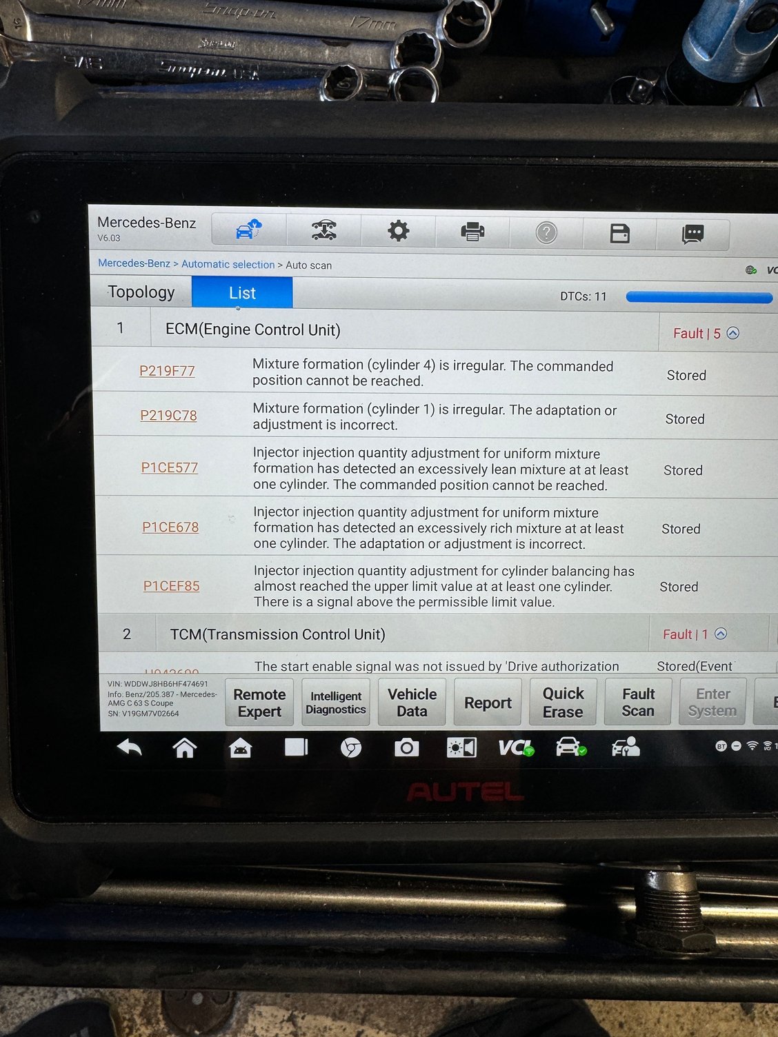

took it in the shop today, CEL finally popped up yesterday. We replaced the spark plugs and started it up, same issue kept happening. I drove it to the gas station and put fresh 93, started it up and no longer had rough idle. Parked it at the shop and left it idling for 30 minutes with no issue. Figured it was all good now, drove 15 miles home and as soon as I got home it happened again.
I attached a photo of the codes below, I think my next step is using the tuner handheld to upload the original stock file and seeing if that changes anything.
but would appreciate any thoughts on the codes
thanks
Old Jun 14, 2025 | 01:22 PM
superswiss's Avatar
Joined: Nov 2018
Posts: 11,463
Likes: 5,354
From: San Francisco Bay Area
2019 C63CS
Did a few quick Google searches on those codes, and I found several posts with similar codes saying it's commonly caused by worn out exhaust valves seats causing leaking in the affected cylinders. Fix is a new cylinder head. Here's an example.
Different engine, but some of the same codes. Some other off the cuff ideas are failing injectors or fuel pump. Lean conditions basically mean not enough fuel is making it into the combustion chamber, so that could mean air is measured improperly and too much air is getting in, or not enough fuel or it's leaking out somewhere. I haven't seen this on the M177 engine TBH. Misfires on our engines are usually coils or fouled spark plugs in tuned cars, but then again, anything can go wrong in a tuned car that shouldn't under normal operation conditions.

Old Jun 14, 2025 | 01:36 PM
BenzAMG99's Avatar
Joined: May 2016
Posts: 210
C63s
yeah I had seen that same post, it’s just that it’s complete different motors. Like what you said, I haven’t heard of anything like this on m177. Also wouldn’t worn out valve cause it to give persistent issue? Mine has been coming and going, I would hope it’s just injectors needing to be replaced.
Old Jun 14, 2025 | 02:03 PM
superswiss's Avatar
Joined: Nov 2018
Posts: 11,463
Likes: 5,354
2019 C63CS
I guess it depends. If they are just slowly starting to leak then it could be intermittent. Metal expands and such. Might wanna do a compression test.

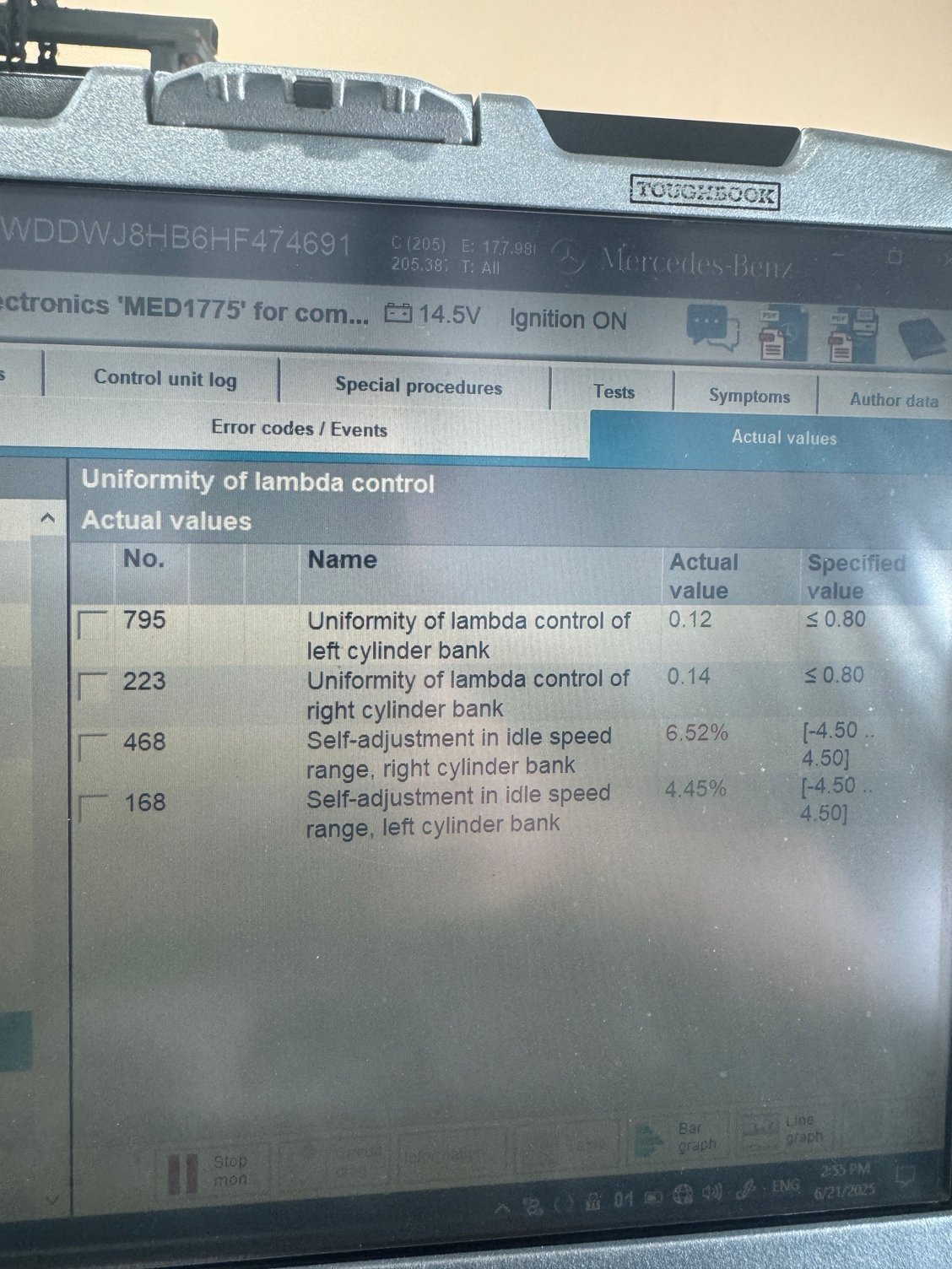

So far what I’ve done was replace plugs, replaced cyl 1-4 with new injectors which were also coded, flipped around coil packs and flipping around o2 censors, aswell as did a compression test which the results were excellent but all still showing Self-adjustment in idle speed range, right cylinder bank
Actual value : 6.52%
Specified value: [-4.50 - 4.50]
The car is tuned so I tried switching to the stock file, which made it completely worse. Threw misfire codes on cyl 3,4 and 5.
So decided to put back the tune file, car vibrates hard on idle and I know that the issue is the right side of engine. When putting it in Drive or Reverse the misfire/hesitation gets terrible. But in P or N , car is reacts different.
I’ve attached what xentry has shown, it would be amazing if anyone has any experience or sharing your thoughts. I’m really upset about this and bummed out I can figure it out.
Old Jun 21, 2025 | 06:01 PM
CaliBenzDriver's Avatar
Joined: Apr 2019
Posts: 12,001
Likes: 6,827
From: Silicon Valley
W212 MY'14 M276-3.5NA @75kMi
lean mixture penalties
It's not easy to get these machines to run precisely. Many things can throw in a wrench that detunes performance.
You want optimal:
engine setup + fuel delivery + ECU timings
The engine vibrations and misfires are a catch-22: one causes the other.
-- What are your idle LTFT ?
-- What are your compression individual numbers ??
You know these ECU are super precise. They quickly pull back fuel on individual cylinders or hand it out when satisfied by combustions.
The best outcome is with all cyl nearly equal.
You'll want to help your engine run predictably to meet ECU expectations else it enforces fuel penalties resulting in lean misfires.
