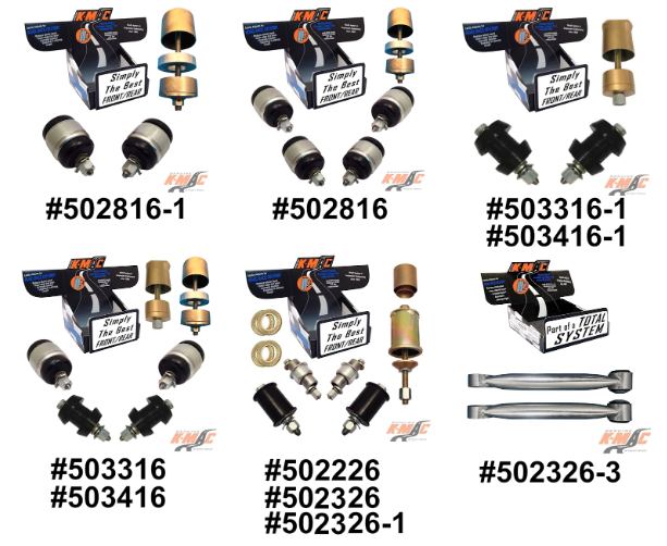

C63/S Sedan / Wagon versus Coupes.
While front suspension are all the same - rear do not have both the “uprated” bushings or Toe arms (as on the Coupes).
At K-MAC we have the experience of manufacturing uprated suspension bushings (and Camber Caster kits) longer than anyone else (since 1964).
For the C63/S Sedan and Wagon - We therefore manufacture Uprated bushes for the ‘6’ rear multi link arms. Significantly eliminating rear end flex. Excess inner edge tire wear both sides. Providing tauter response, improved traction. Especially when applying power to long change / overtake.
Also like the Coupe - “uprated Toe arms” to reduce flex / Toe change when cornering.
Plus “Camber adjustment” for the rear including “all Coupe models” !
Not inaccurate one offset position shims - but replacing the large diameter soft rubber inner rear bushes at the same time. With the K-MAC Patented design providing single wrench “precise” and serious adjustment - up to 3 degrees extra Positive or Negative Camber (plus extra Toe adjustment to compensate).
K-MAC - Fit without special tools or need to removal control arms. Ultimate adjustment - direct on alignment rack - UNDER LOAD.
FRONT - Camber and Caster kits - also fit without arm removal Uprating at the same time the 4 major lower arm bushes !
