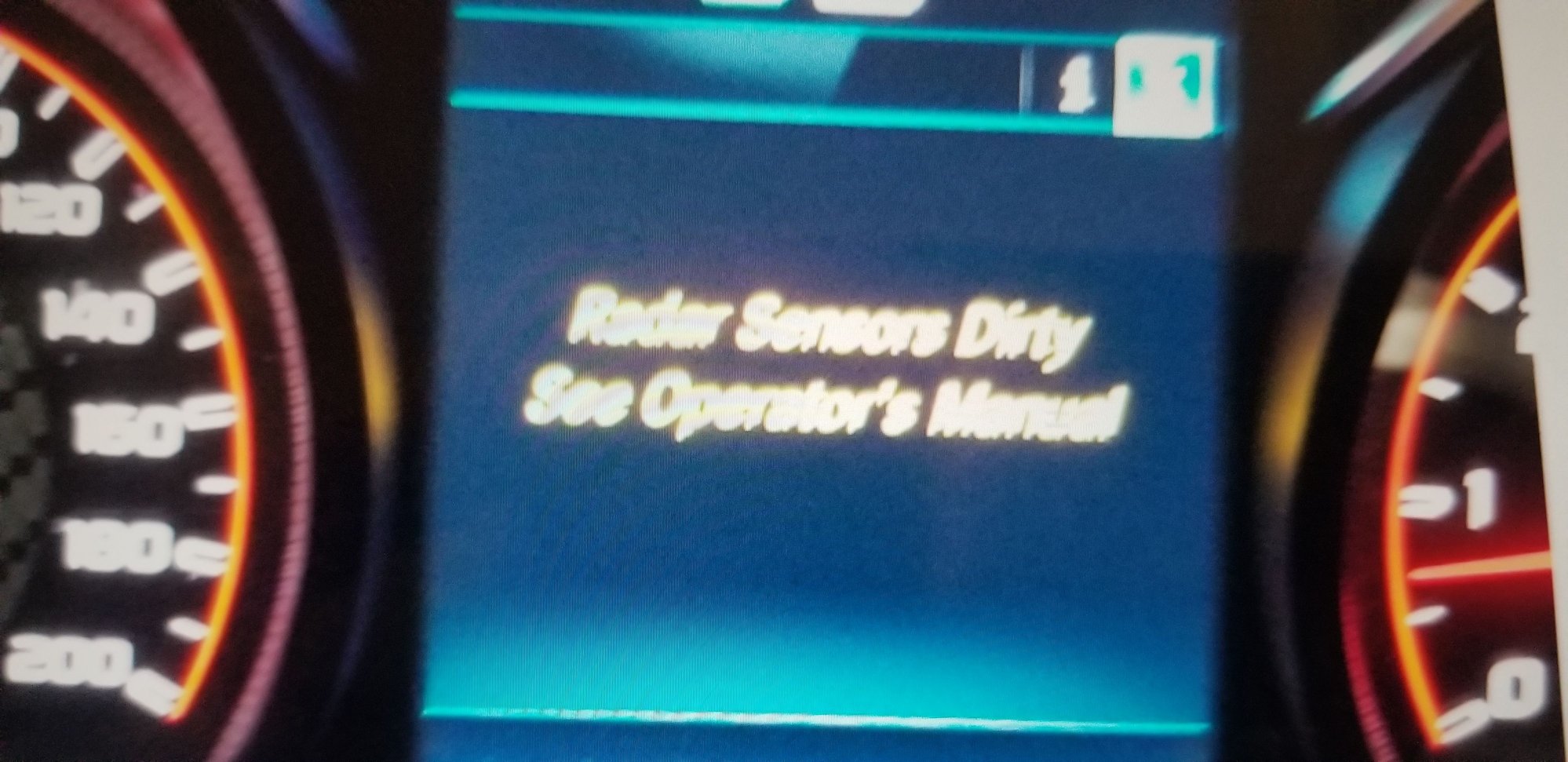

After completing a long rain soaked foggy night drive my car was filthy. The Rador Sensor Dirty came on and I cleared it both times. The next day the Radar Sensor Dirty warning appeared. See photo below. I checked the front Mercedes front plastic Star cover. Realized it had a few cracked and noticed a sensor behind it. After this I realized my safety warnings were also not working specifically Lane change warning and front end collision warning. Maybe just getting the car washed would have cleared up this issue but I did'nt. So I called the Dealership and they said bring it in. So on the drive to the Dealership another warning came on Radar Sensors Dirty: Driving safety systems are restricted, Clean all sensors. Photo below.
. The Dealership removed multifunction camera and the Hood lens was not functioning as it should. So they replaced the Hood lens and UPDATED it.
The cracked front MB Star was replaced at cost of just under $900.00 and lens and labor was covered under warrant which was expiring in 7 days.
Now the safety features that are on my car are working as it should.
