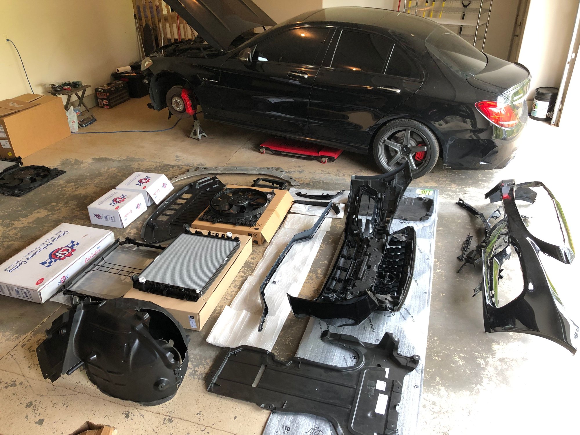

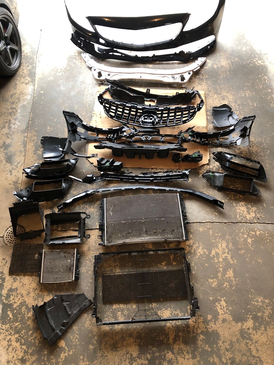

Here are the only pics I could find on my phone right now.
Old Jul 3, 2025 | 11:13 AM
RichZilla's Avatar
Joined: Jan 2024
Posts: 34
GLA45
In that first photo, you can see the new radiator boxes on the far left, along with the new Mercedes radiator and fan just to the right of that. Other new parts all there too.
The second photo is a bunch of the old stuff being replaced.
The third pic is after most of the damaged parts had been removed to determine what needs to be ordered.
I did document a little bit of it on my Instagram account @richzilla2.0 but not much. Again, more concerned about working on it during my very limited availability to do so, rather than the documentation of it. This has been a 4 month process for me so far.

Did you replace the fascia? Are you 100% certain all airflow is getting into the radiators which should be getting in? Did you change the grille? Is the grille more restrictive than the factory grille? Drifting, etc., is a low speed high rpm high power event, a train wreck from a cooling system point of view. Drifting is a great way to ruin a car imo but that is your choice.
What is the smallest round white orifice (plug?) in the largest radiator in the first photo?
The grill is all the same, just new parts replacing broken parts. The radiators are all very clearly visible and open to airflow. Again, the water temp is right on nominal. No issue with any temps except transmission. That's why I really need to learn how the transmission cooling circuit functions.
I know drifting is a completely ridiculous thing to do with a car like this, but it's the last thing on my bucket list, to see if I'm capable of learning how to drift this specific car in total street setup, no helpers. They have a Drift class at the AMG Academy that uses the C63 and that's how I got the bug up my butt to do it. It is 100% wrong, but also so damn fun it should be illegal. Something about sliding around a huge carousel at 60mph in 3rd gear on the rev limiter makes a guy feel alive.
The white spots on the factory radiator are plugs to keep out debris. I made sure every plug was removed and accounted for during assembly multiple times. Plus, it would not be possible to attach any of the coolant line fittings if the plugs were in place.

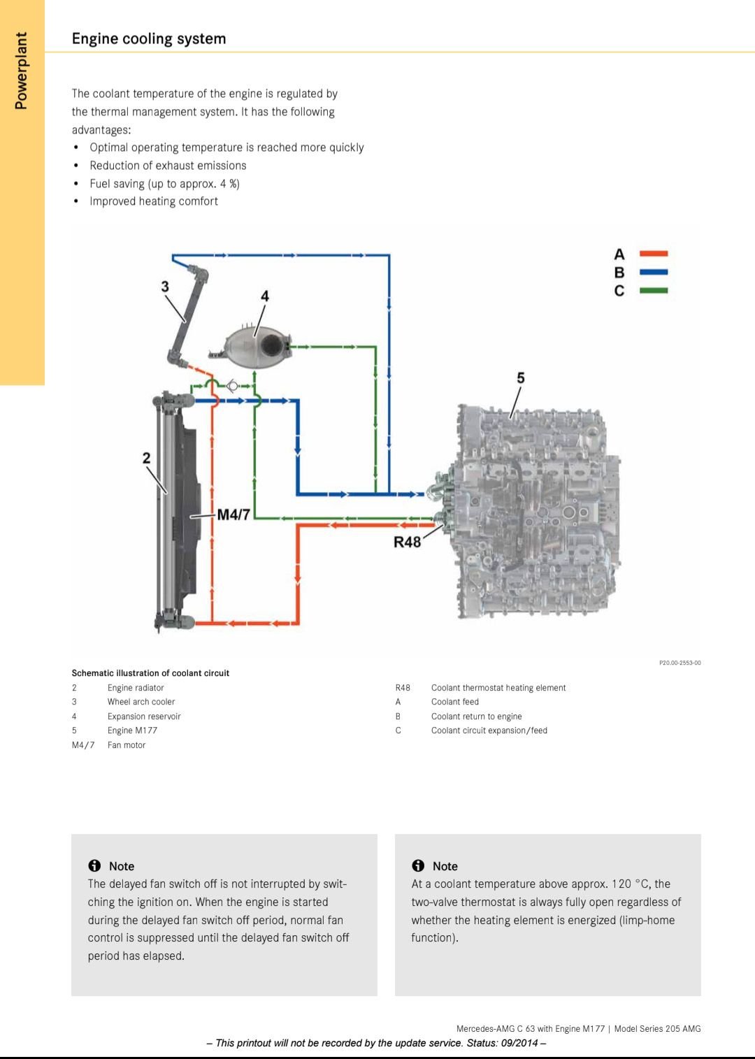

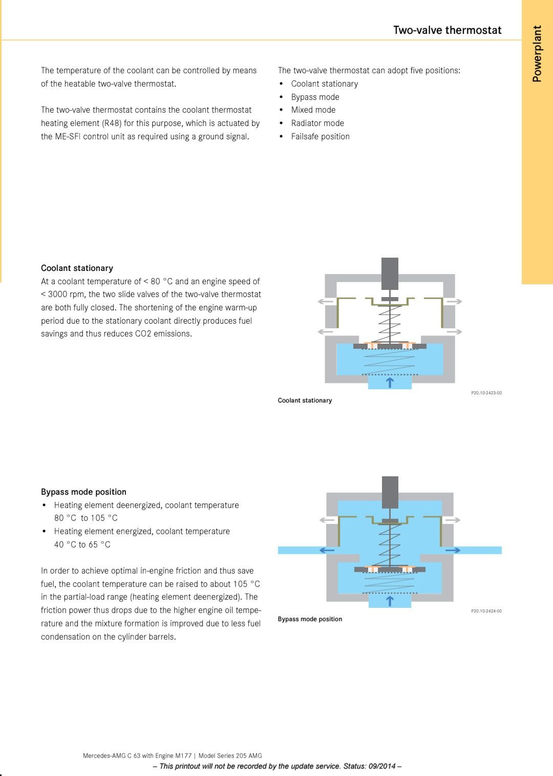

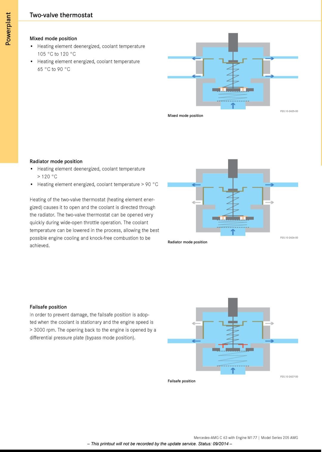

I still want to learn how the transmission cooling circuit functions. I might be able to call in a favor from a dealer employee who can ask a service pro to talk to me about it. They otherwise aren't too interested in helping you do things yourself.
This is cooling information from the Service Manual of the C63 S I'm hoping could help you.
Old Jul 5, 2025 | 07:40 PM
RichZilla's Avatar
Joined: Jan 2024
Posts: 34
GLA45
Thank you! I will review these documents and see how much I can learn about the system. This could be very helpful.
