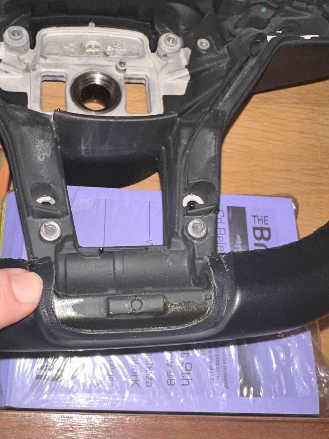

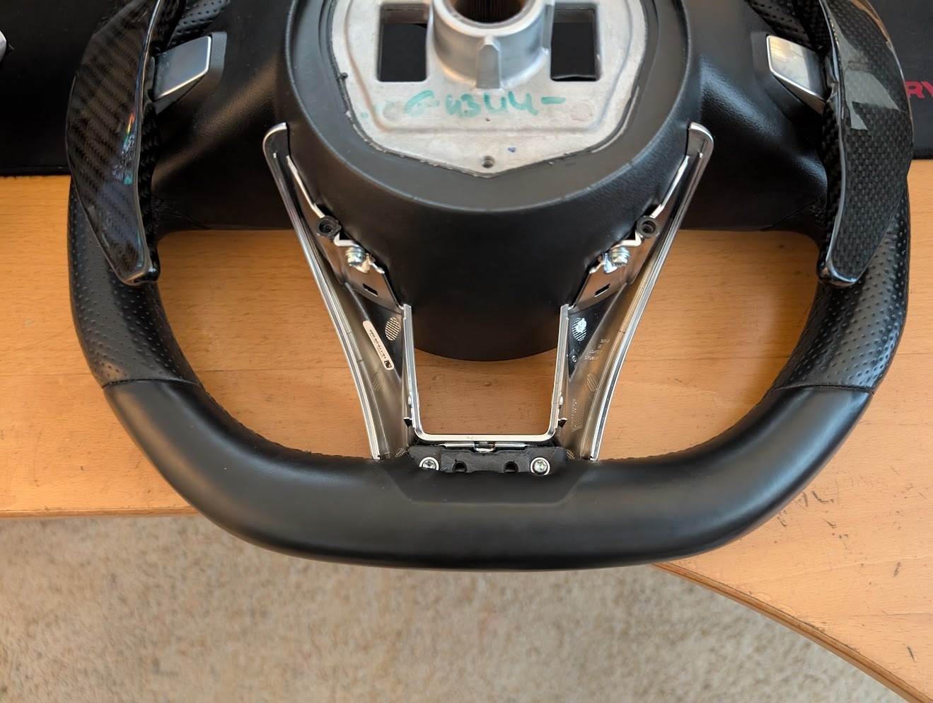

This is where it resides on my S212 AMG. I just swapped steering wheels and the control board in my steering wheel did have spaces for extra plugs such as heating, but I have all of the other features so there was only one spare socket. The little vibratory motor sits in the pocket in this picture and then the wire wraps around to the top where the control board would sit.
my steering wheel originally was a 2013 and I swapped on a 2012 steering wheel and it still had the same pocket and all screw holes for everything from my original steering wheel. I’m basically swapping back-and-forth between full leather and the alcantara leather mix.
Thanks for posting this - this looks the same as it is on my w204 steering wheel, but when I took apart the w205 wheel there's no space for me to put the motor. Can you please post a picture of the whole steering wheel?

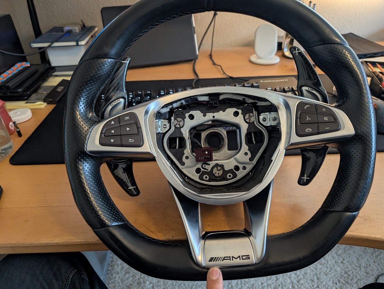

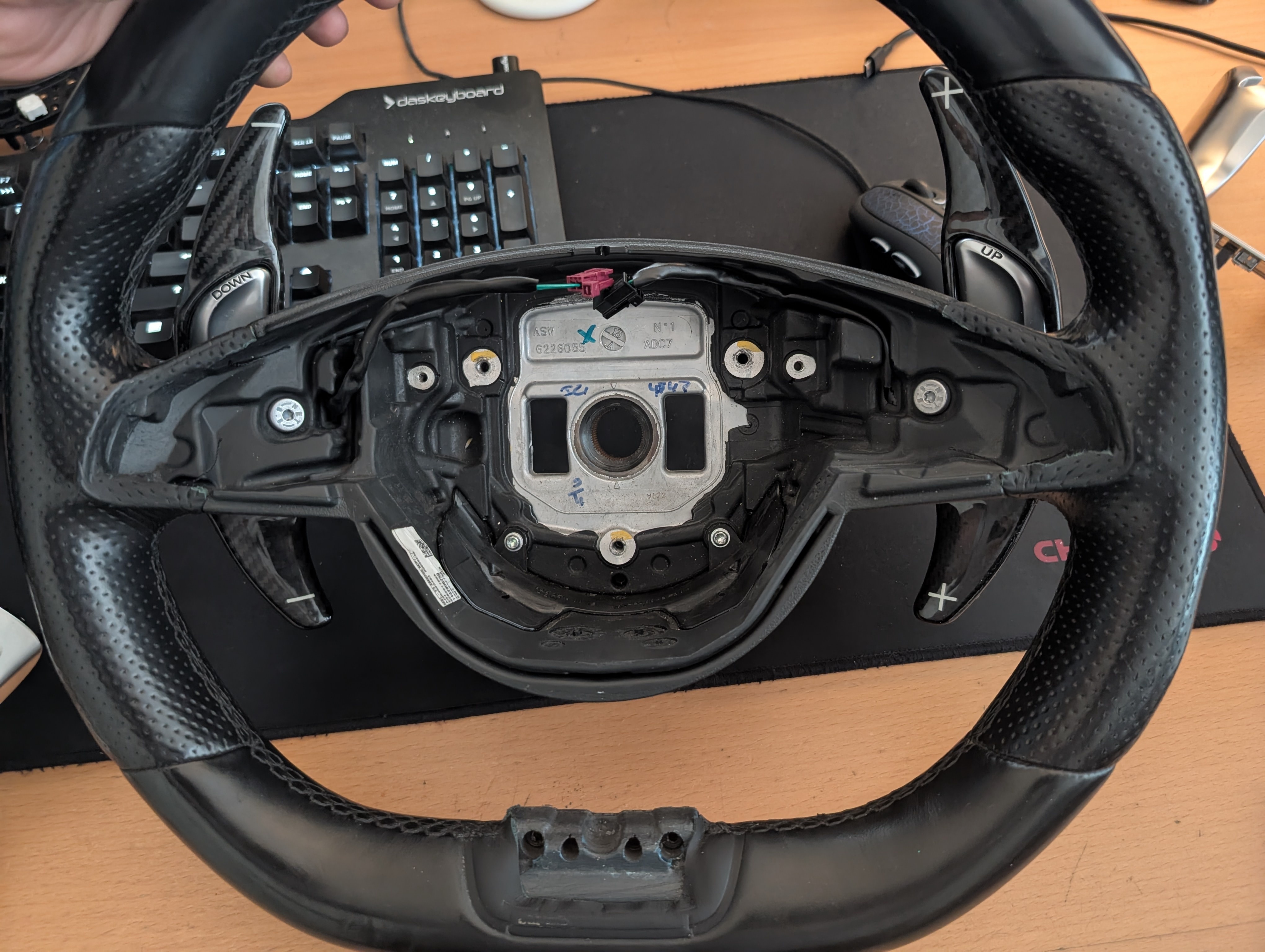

Here is what my W205 wheel looks like in the bottom area where the motor was installed on my W204 wheel, and also on your wheel:

212 and 204 are the the same.
are you sure it won’t fit in that little pocket underneath the AMG symbol? From the picture in the diagram posted you’re looking for a mounting point with one screw hole. Have you taken apart the whole steering wheel to look for one spare screw hole?

Gotcha, so my old 204 wheel and your 212 wheel should be the same.
There's definitely no room on the 205 wheel under the AMG symbol to put the motor, and even if there were none of the bolt holes line up, and there's also no openings from the plastic portion on the bottom near the AMG logo to the centre of the wheel where the interface board is.
