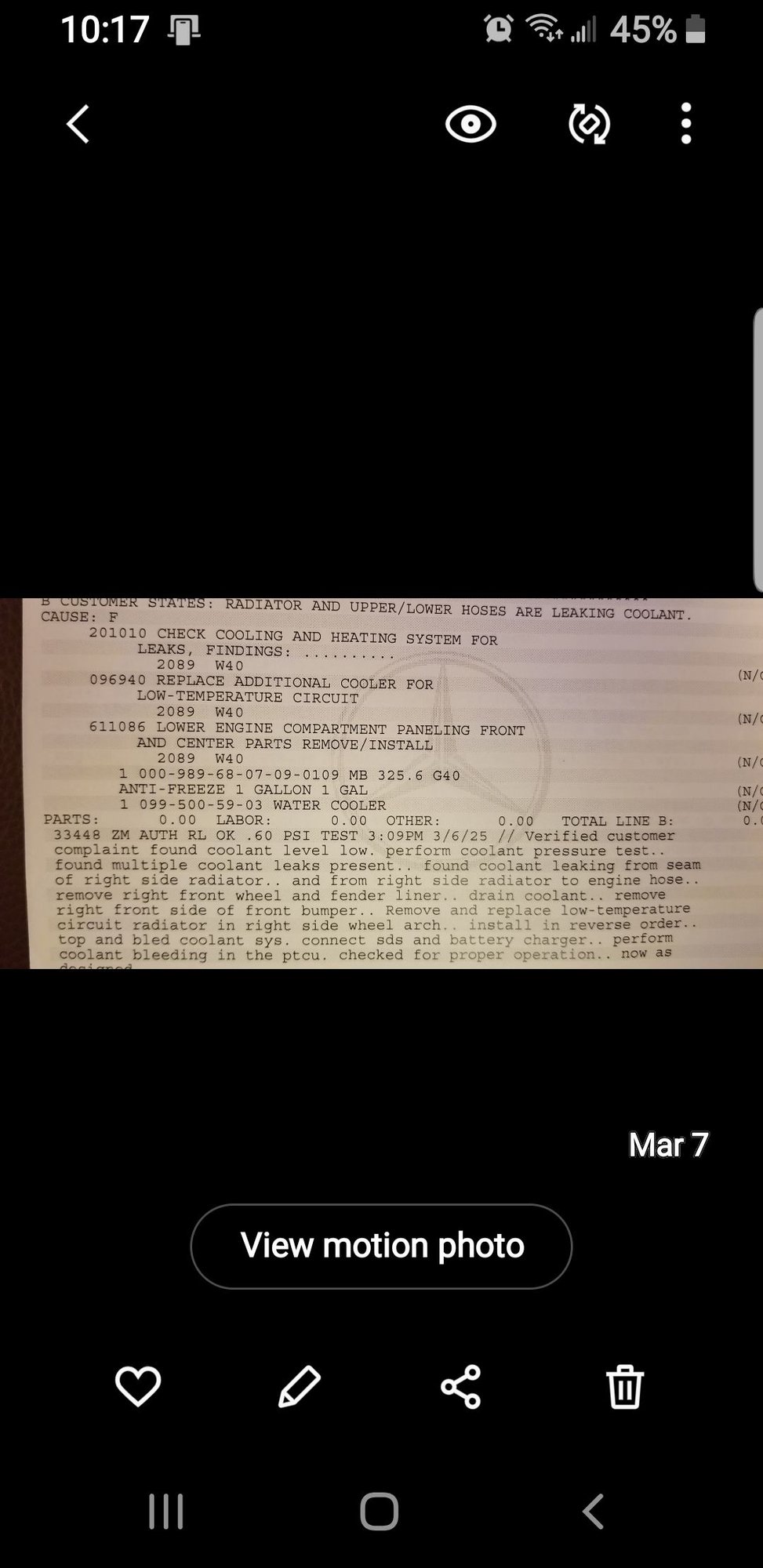

I also have a 2019 C63s coupe. This past February, 2 months before my MB Extended expired, I had an experienced Indy do an inspection on the car. He discovered and photographed the lower radiator hose was leaking and advised also that the radiator be replaced.
. The Dealership made the repairs as noted below.
As noted on the Invoice the Anti-Freeze used was MB 325.6.

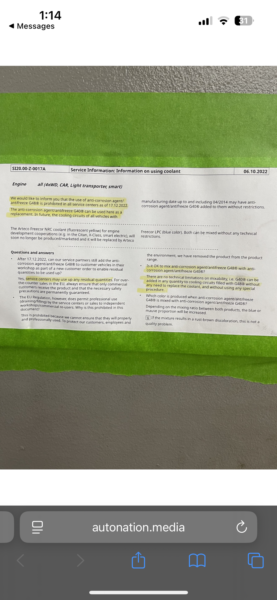

Just posted this when I had the same question.
Posted at my mb dealer.

Please read what I posted above. Mercedes states mixing is ok with the types they mention. They have superseded their recommendation to not mix. I was just at a dealer and went through this…I have a 2013 and always used blue and dealerships can no longer use “blue” due to regulatory issues.
