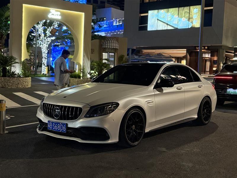

Hi! Just joined our forum! Here's a pic of her
I have a 2020 C63S 9 speed with hybrid turbos and ECU/CPC tune. And I am really on the edge of getting TCU tuned as well.
What is the stock torque limit of this transmission? Is it absolutely necessary to tune it when pushing 900-1000nm of torque?
Additionally, will there be benefits of better shift logic as well? (as in shift points related to rpm and throttle position)
Any thoughts will be appreciated! Been a long time M owner and just made the switch to this platform and it sure gets confusing! Guess that's just Mercedes Ay.
