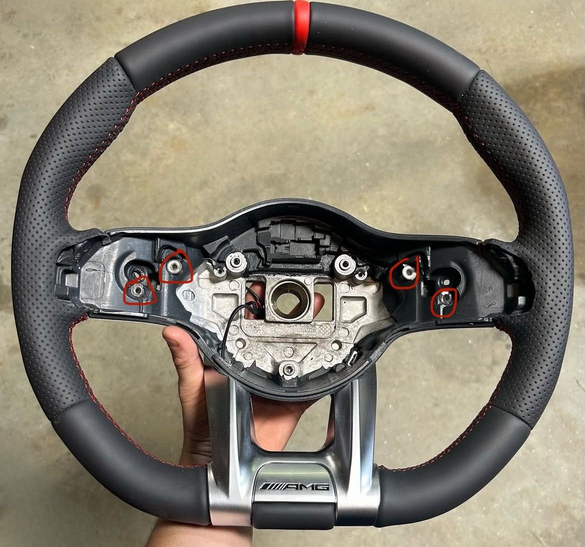

as long as you get a carbon wheel facelift 2019 you’ll have the screw holes for the drive unit. I’d say 99% of the carbon wheels out there use a core that can accept a drive unit so should be safe. All the core we use at least allow adding that option. I circular the holes so you can see where it attaches
perfect thanks very much. Ill check with seller.

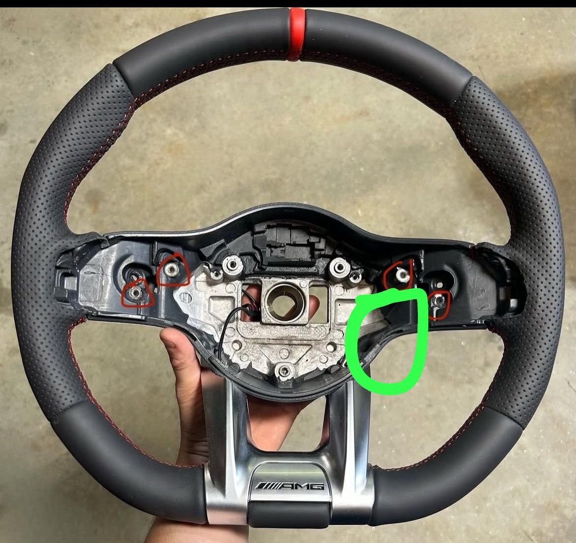

Most important thing you need to check is if you have this gap to fit the oled buttons
Cheers, ill reach out to seller and get him to check

there are different trims not cores. The trim will have a cutout to allow the mounting of the drive unit
