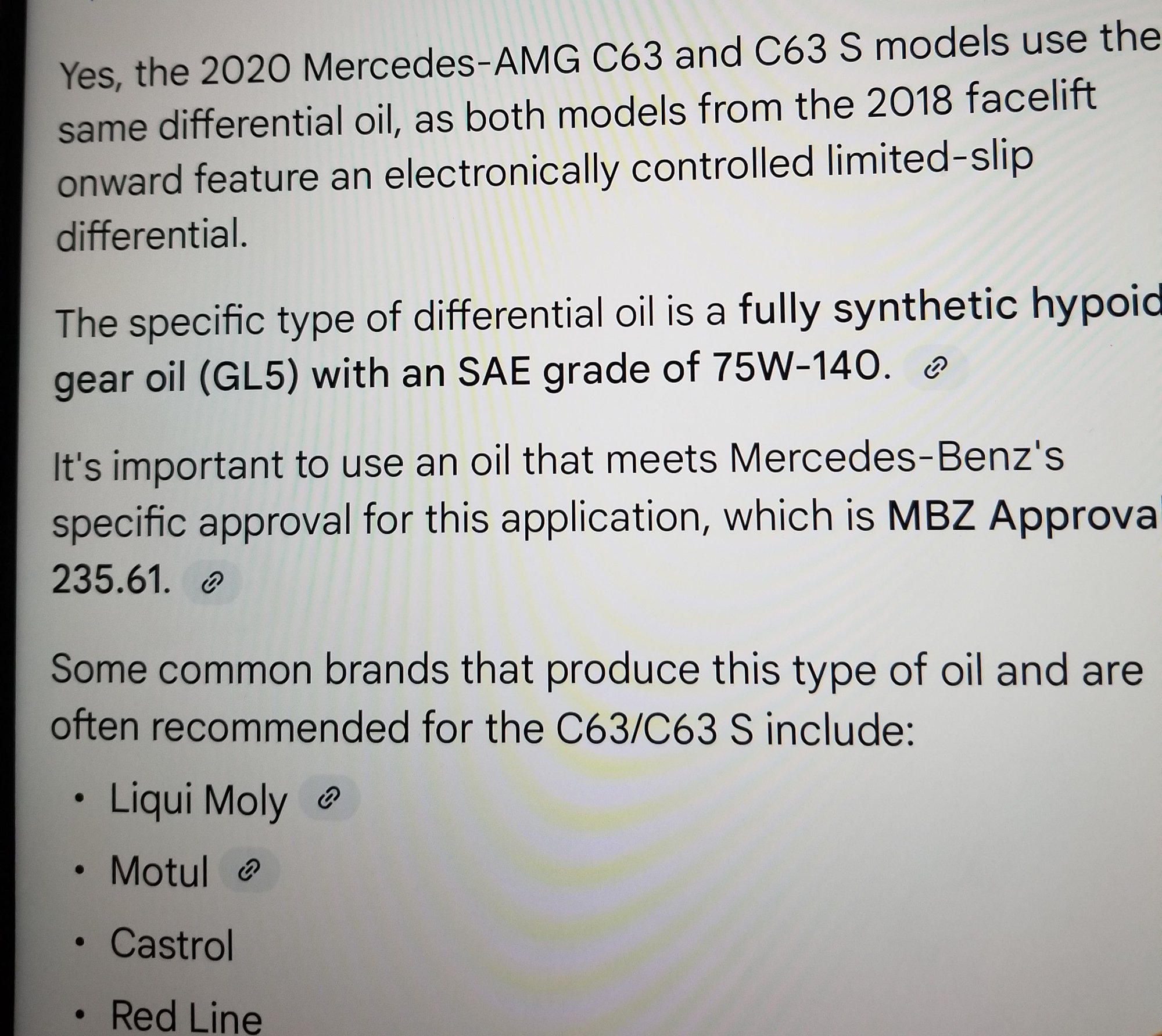

I have the 2019 C63 S coupe and had the differential fluid changed about 1,800 miles (required) and again about 2-3 years later. I have the MB invoices and will be home Sunday so I can see what oil was used and part number if you still need it.
Here is what AI says:

Yes I think you’re right. I dug a bit more and it seems that if it’s any Limited slip, then 75w140, if it’s not a limited slip, then 75w90 is the general rule with Mercedes.

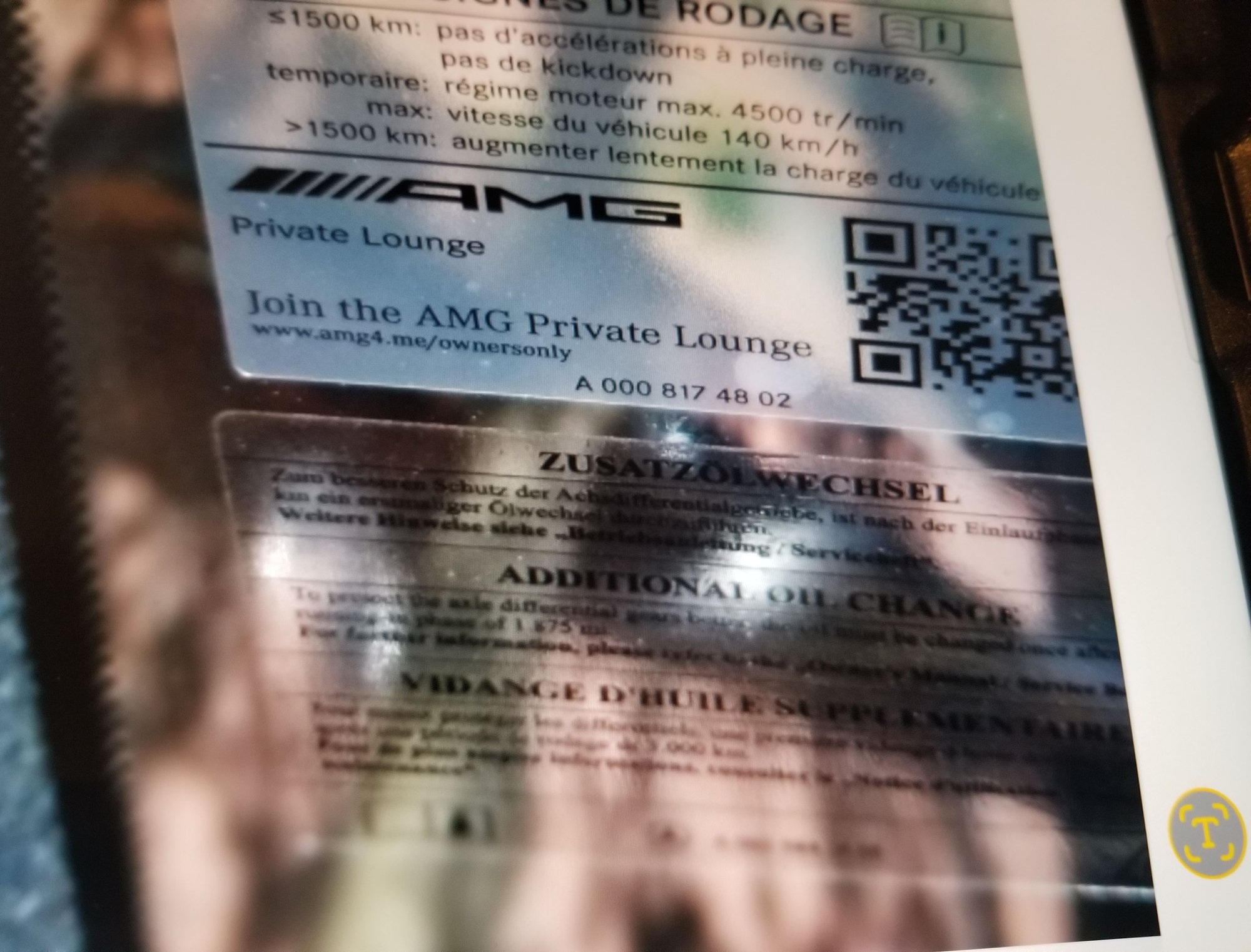

Photo below shows the MB timeline for rear differential oil change. Note this is an older Service schedule.
I am considering get this service done and this time with the new Drain and Fill plugs.

Originally Posted by jj18
It's been debated that this Service is no long required??
Only the change after the break-in period is no longer required as confirmed by AMG Germany itself. I still ended up doing it as a piece of mind, but I called AMG Germany and they confirmed that technically it wasn't needed anymore for my VIN.
