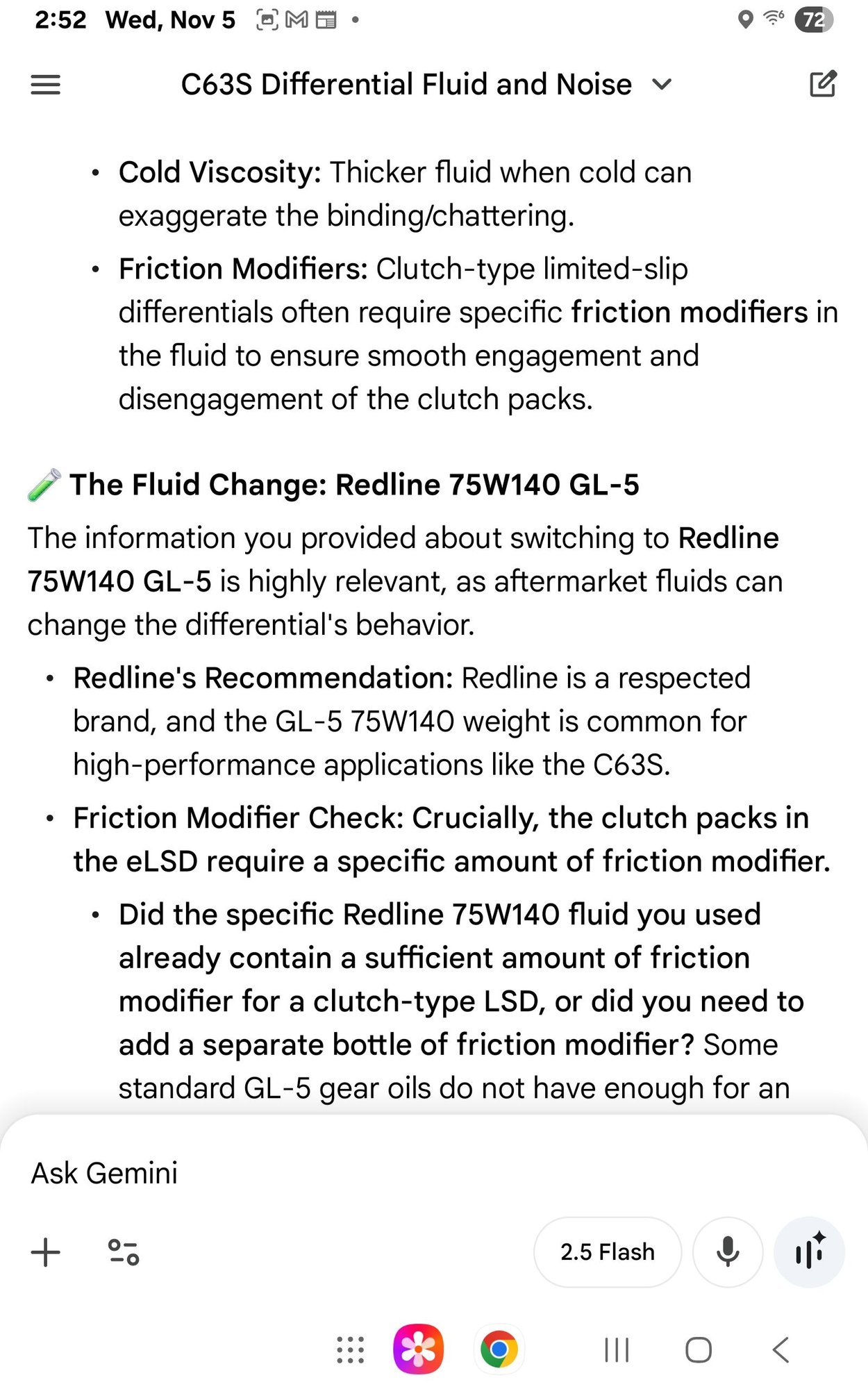

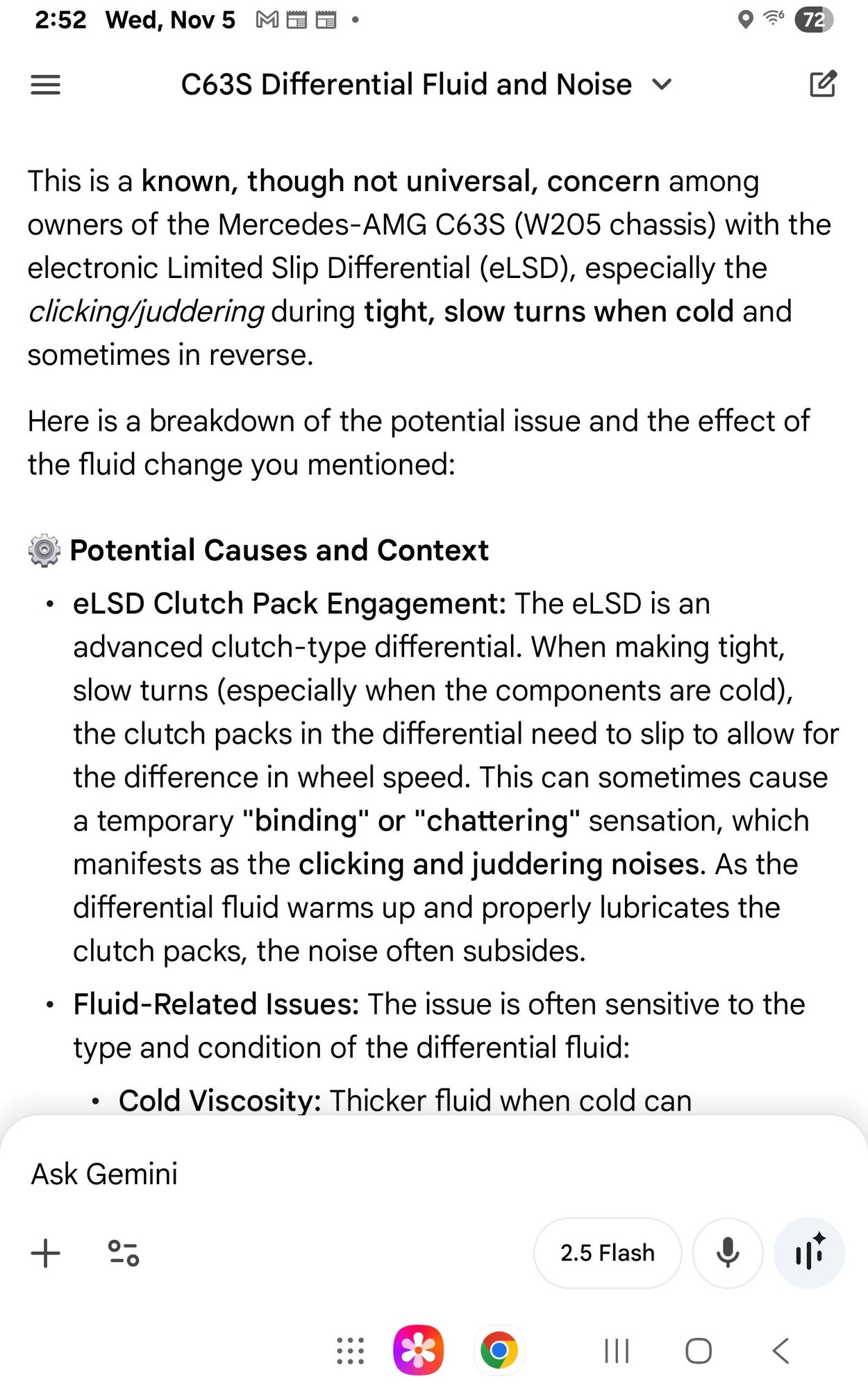

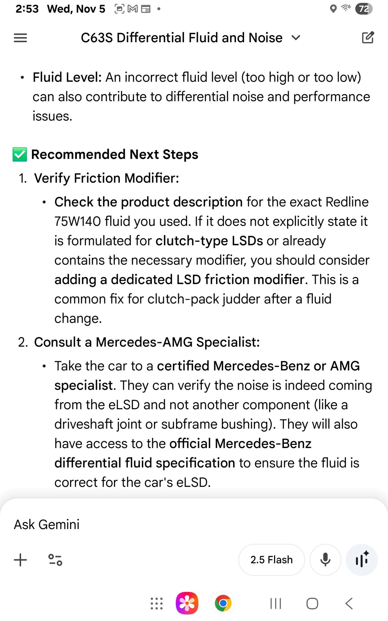

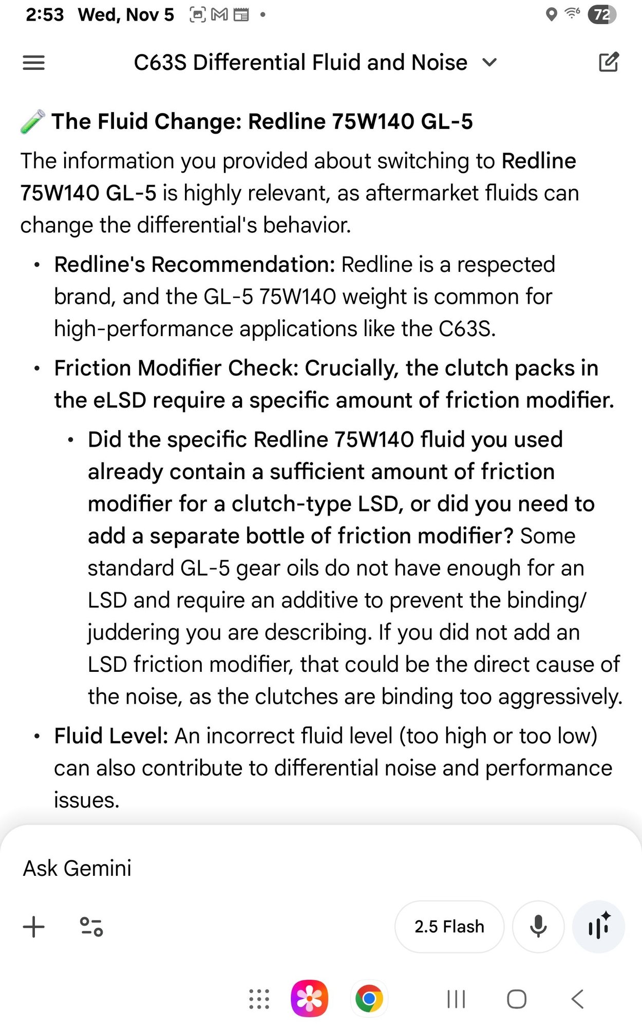

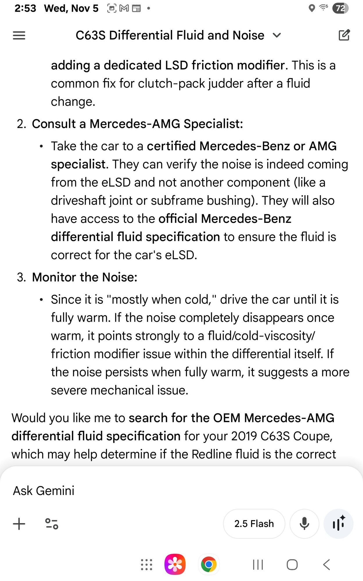

Posed your issues with AI and photos below gives some recommendations. Hope it helps.
