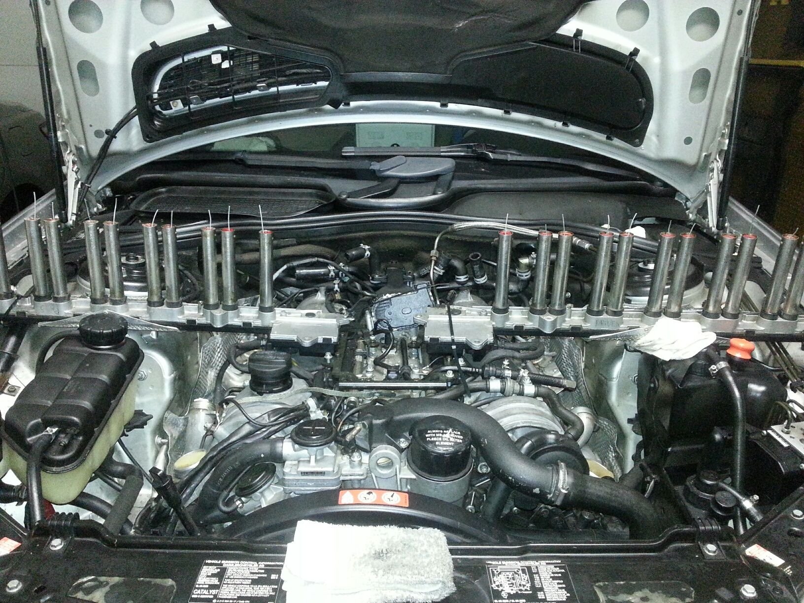

so I put the car back together, I did clean the plugs and test the coils for basic spark. Number 10 cylinder only produced spark from one coil. Installed a new radiator, replaced the ABC line to nowhere ( actuarially just caped it at the bend) .I was thinking about installing another Pulsator on that line ??? The car runs on all 12 and very well. I guess we know something, it will run on only one coil per cylinder. I suspect it will misfire at hard throttle but I haven't pressed it. I'm thinking about selling the car.
What wiring pinout did you use to test the coils off the car?
Static testing, Crank the engine and LOOK. Then I narrowed the gap on the bad looking tower to almost zero, in this case no spark was present. Dead coil or its control circuit. So I didn't go any further but surely one could. I don't have that data, good enough for now.

Aha makes sense!
We are trying to track down the pinout so we can test these coils off the car at some point.
