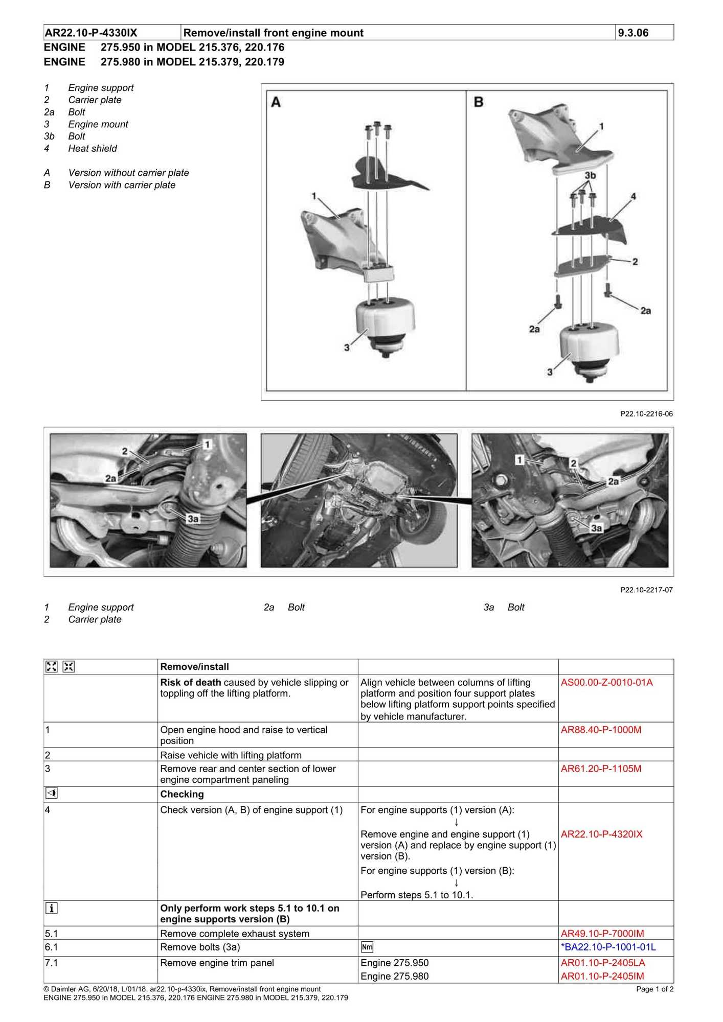

I wouldn't risk an unknown mount on a V12 IF you have the early style mount arms that require engine removal. If you have the later 2 piece arms and can take the mounts out in a couple hours, then it's not a big deal to change them again if needed.

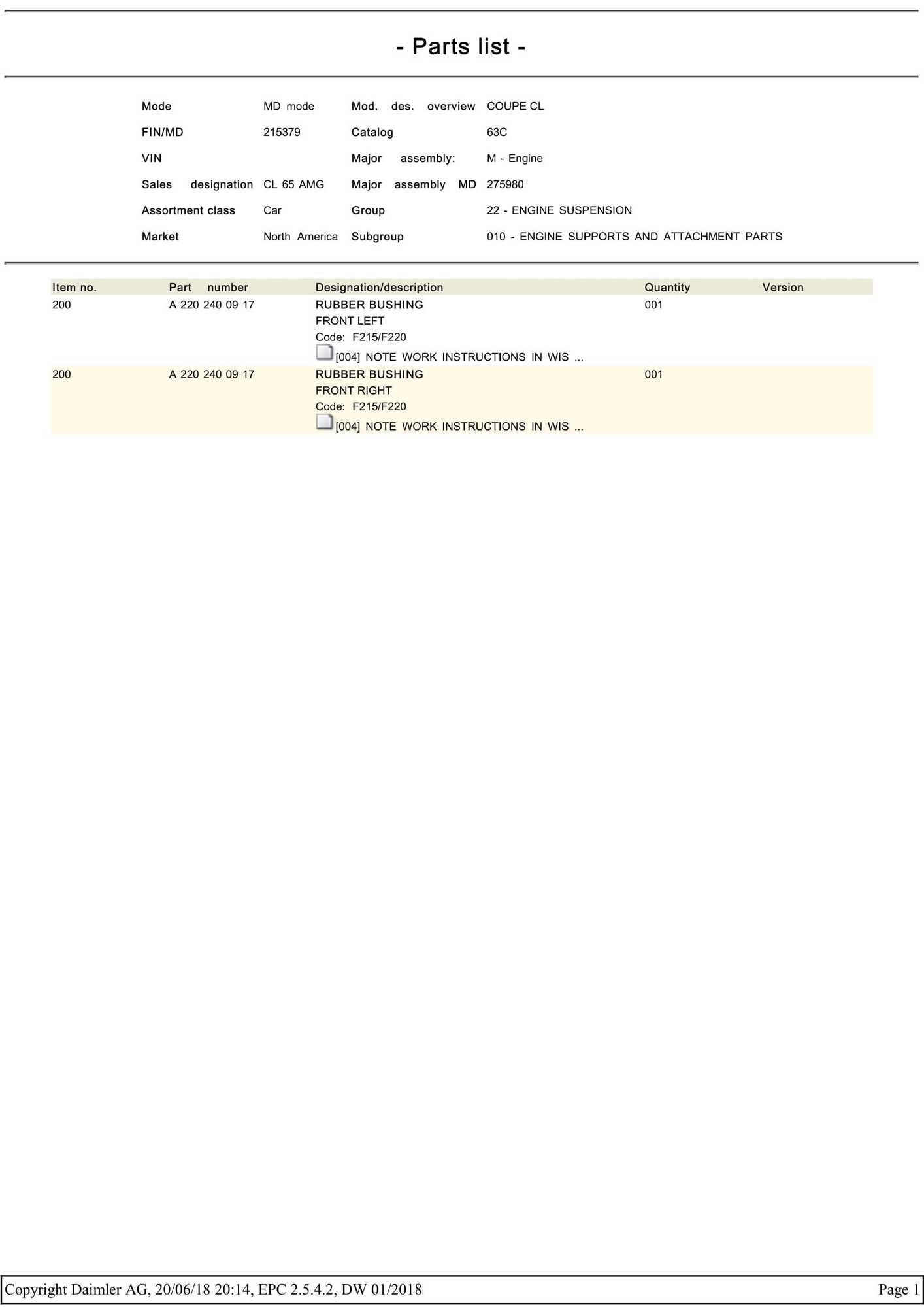

I was hoping someone here had confirmed they are correct stoc mounts. Not willing to take the chance to save $100. I'll be getting them from my local dealership.

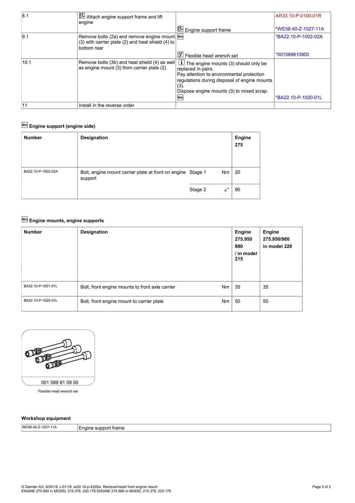

I just remembered something about this-I recommend that you order new bolts for mount. At least get the top 4 (2 on each side i.e. the ones that connect the aluminum bracket to the mount). When I was changing mine, the used bolts were stretched/worn in such a way that I could not achieve proper torque per WIS specifications. I thought that my new mount had stripped. I ordered new bolts and they torque to spec without issue. The bolts are cheap so better to have new then get in there and have an issue.
