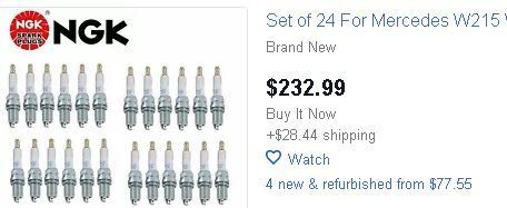

coil packs are easy to change
I use
NGK Part # 5648 {#IFR6QG} Laser Iridium
on my super tune
coil packs are much stronger repaired by
http://www.v12icpack.com
bottom line, you have wasted your cash, you could have got all spark plugs and both coil packs better then OEM for 1430
and yes, do not change one side sparks only. this is my personal opinion, not a fact
