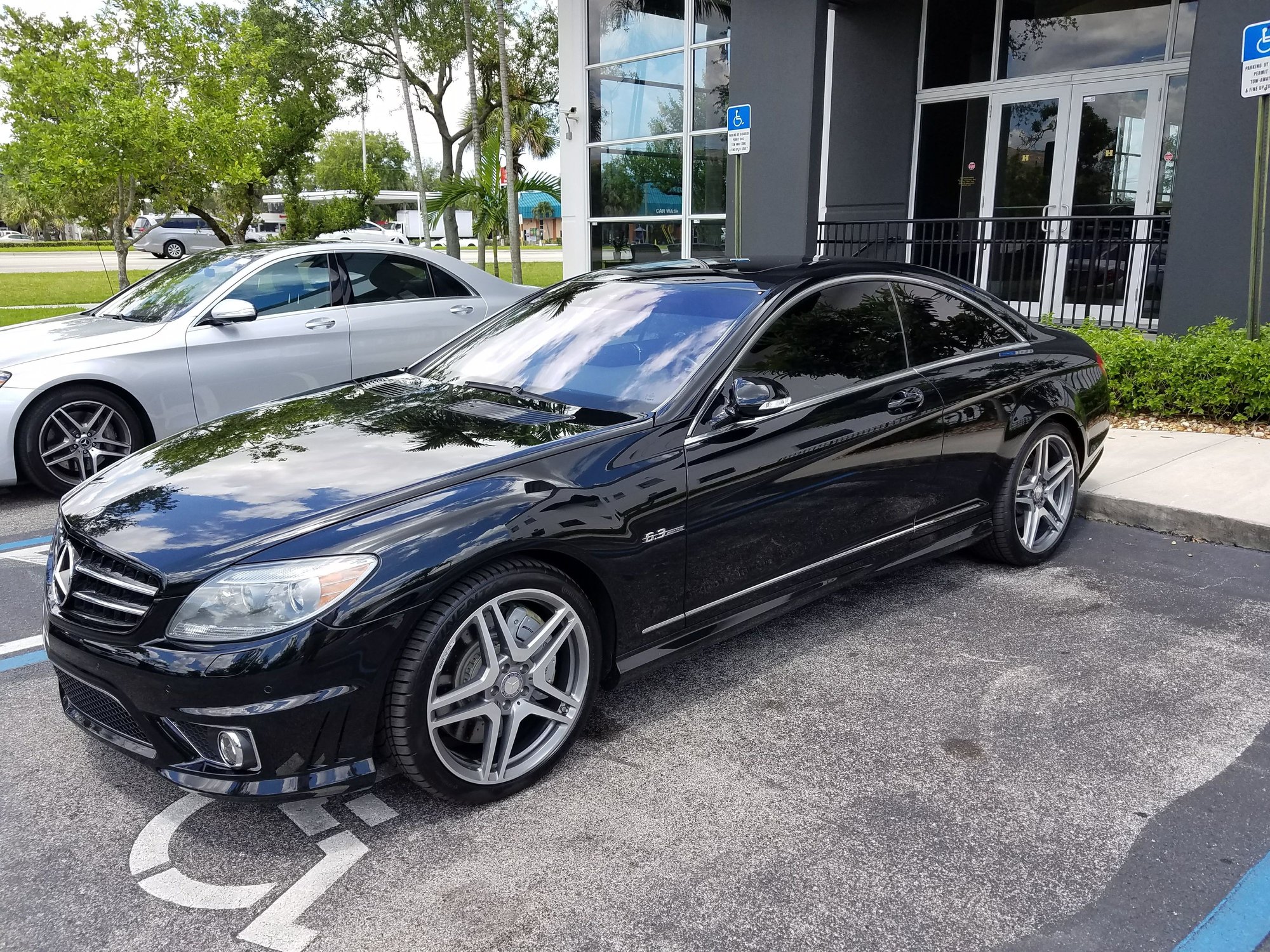

Changing the ABC fluid is not a bad idea especially if the CL is not driven regularly. My 2008 CL63 has 35k miles and I never let it sit too long just to avoid sedentary issues like ABC line & pump failure.
2008 CL63 P30 Performance Package

What an EYETREAT !!!!!
