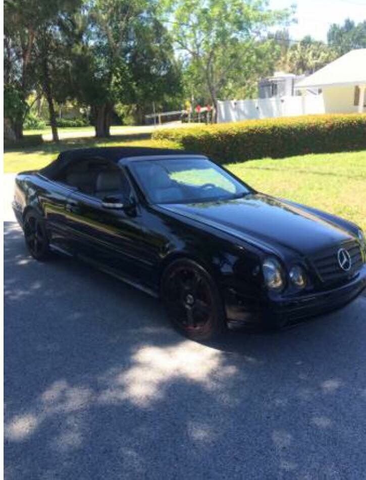

Clk430 w208 I was wondering whats the easiest thing to do to make the car faster? With parts and labor I want to push around 300hp let me know please!
