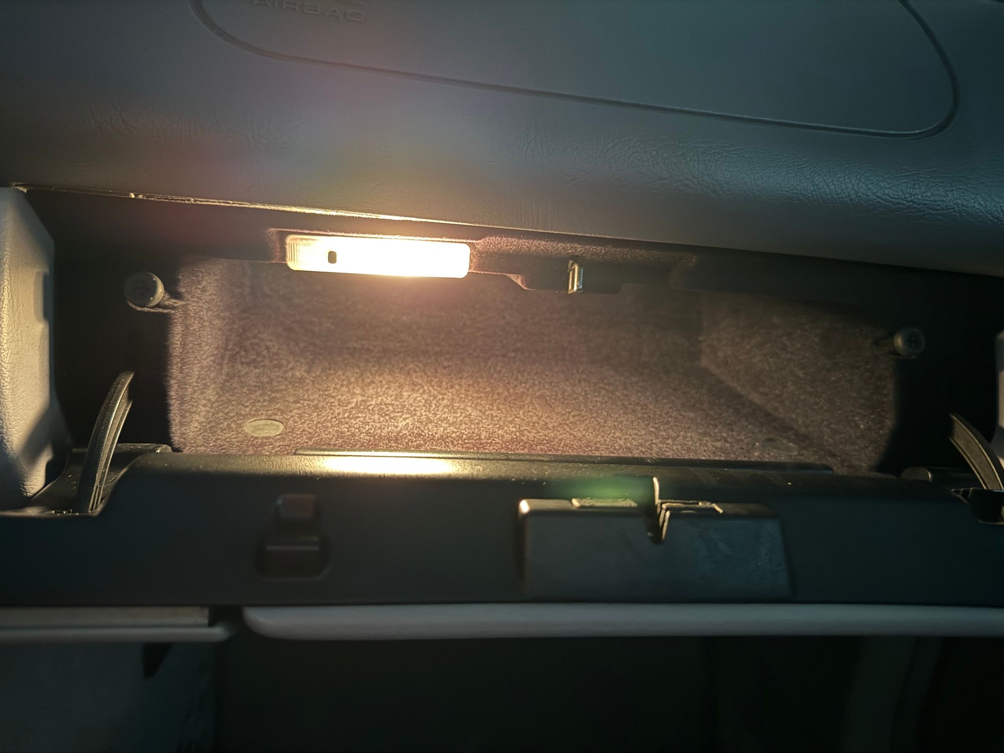

Just added an extremely well kept Cali/AZ life 2002 CLK430 Convertible to my mini fleet.

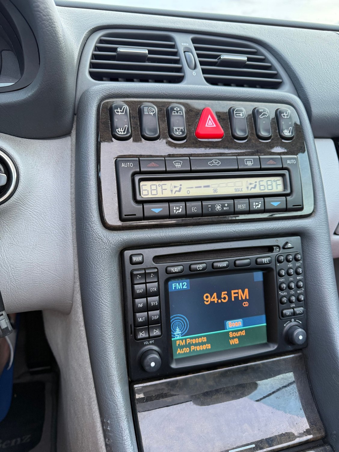

Every single thing works perfectly, and I have the Bose + Command Navigation + Trunk mounted Benz CD changer. All works.

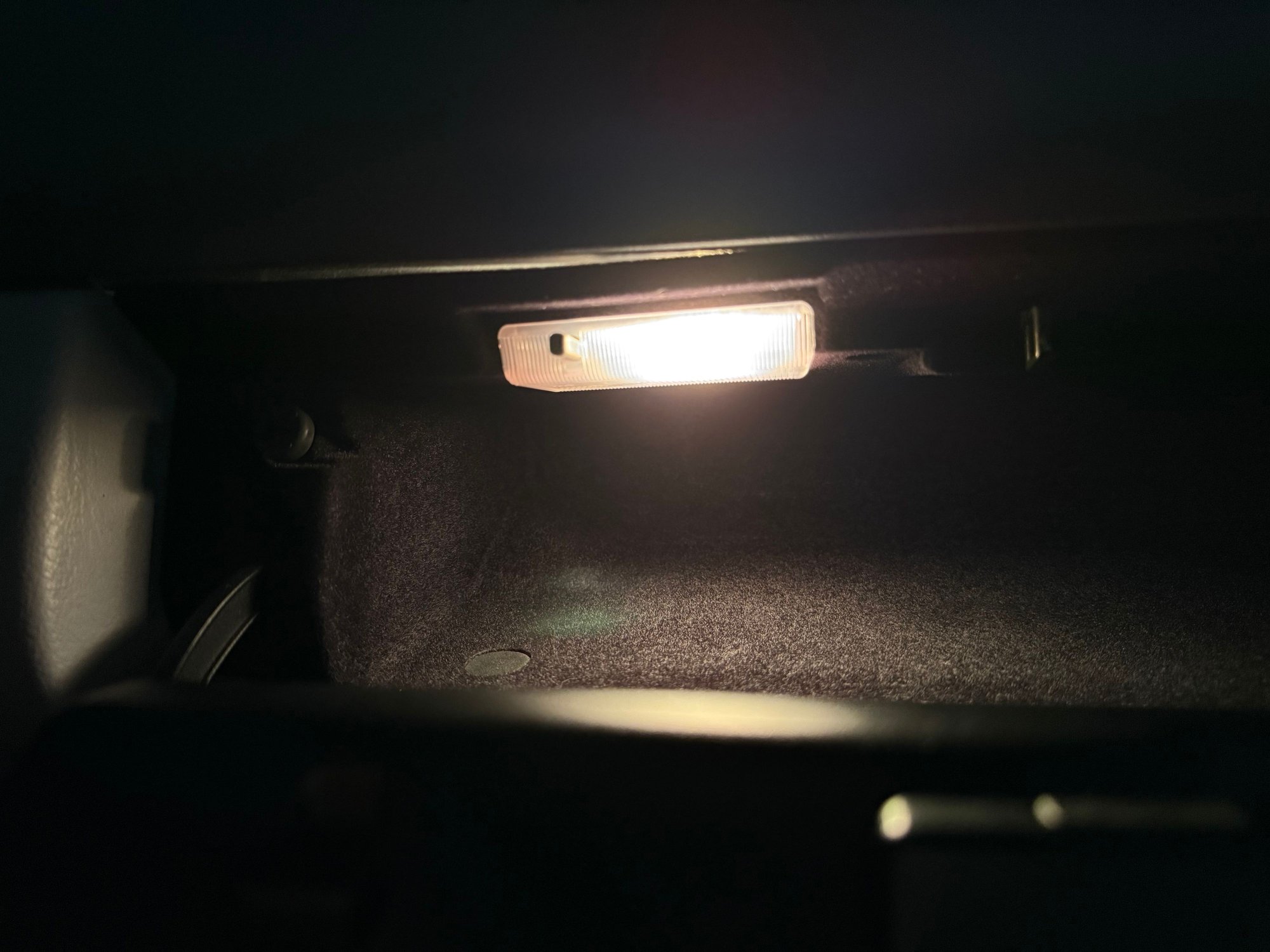

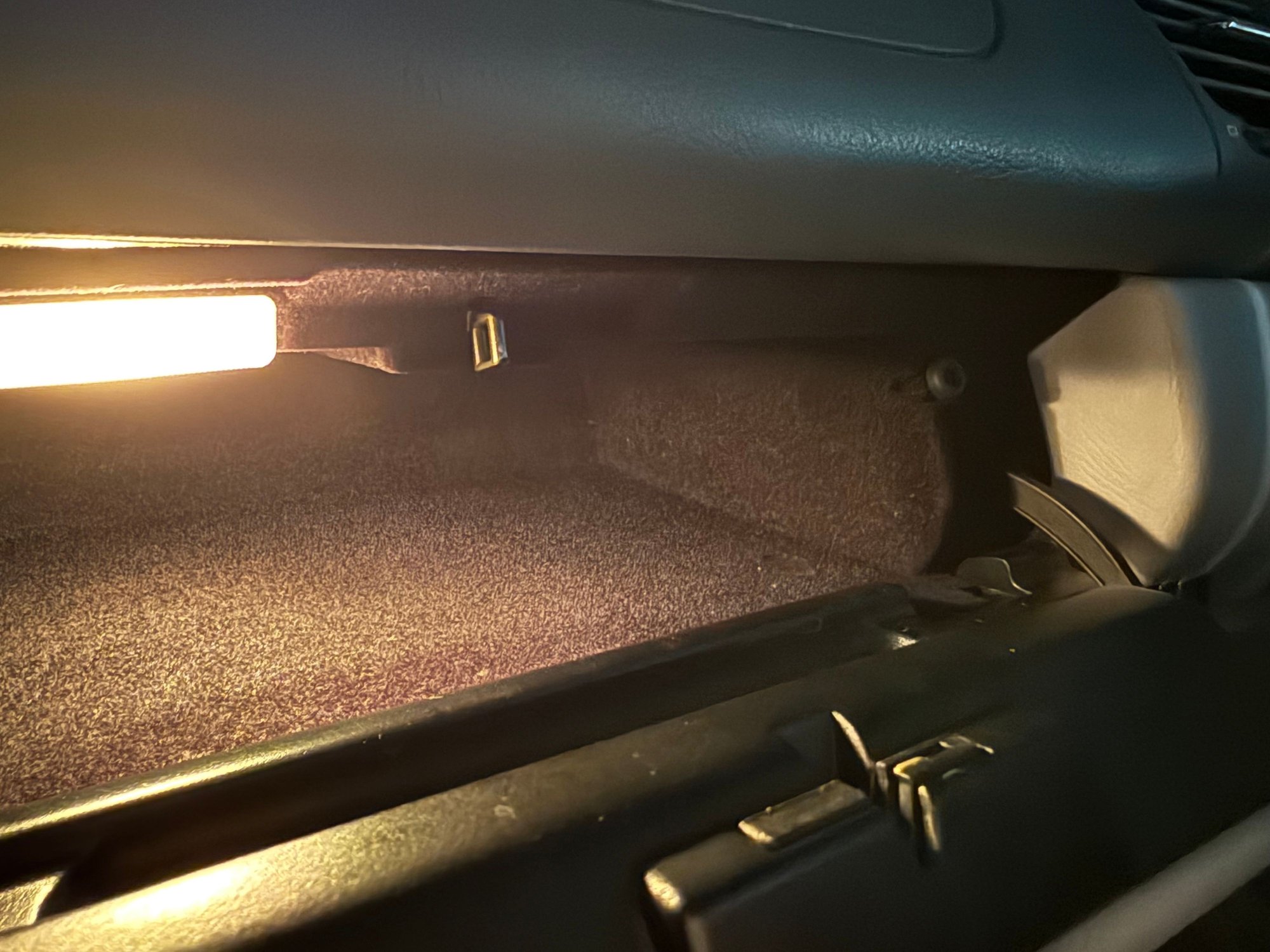

But, unlike all the posts here, and elsewhere stating if you have Command Nav, there’s also an auxiliary jack in the glove box, I’ve searched and can’t find anything.
Yet, too, can easily switch to Aux on the screen, active and ready. And my CD button flips to “CD or CD changer.”
Since I clearly have Aux function, where might the port be if I can’t find it?

Thanks. I absolutely have Command screen, Navigation and the CD changer, too, and Aux on the screen, but simply cannot find the port.

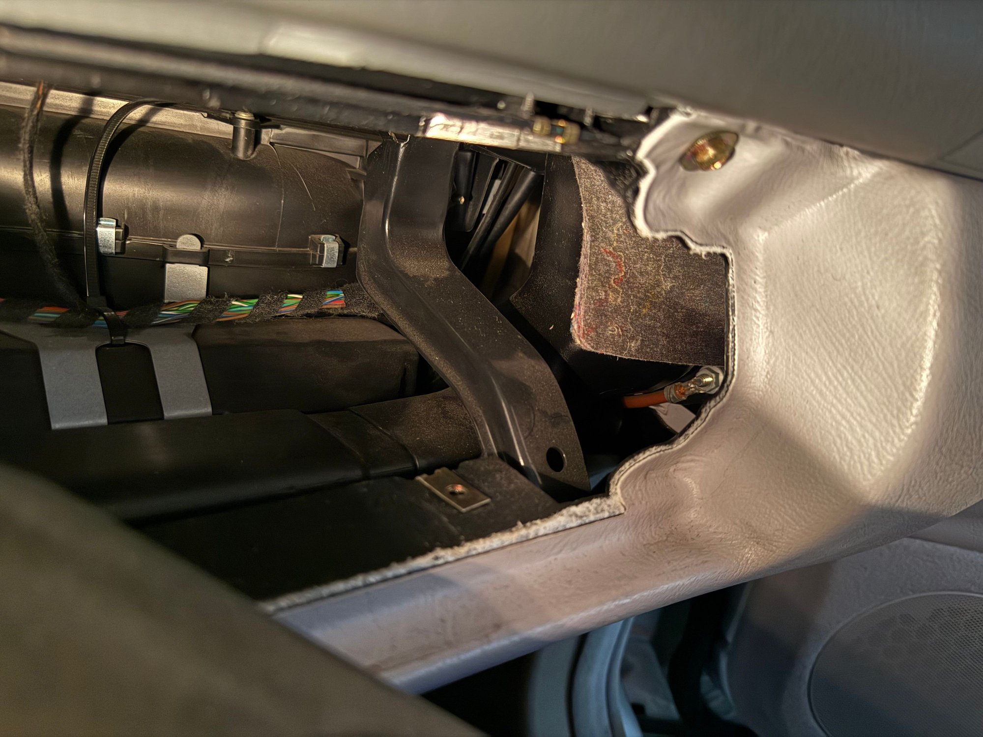

Not visible like everyone else’s seems to be. Will try to take the glove box apart, and dig deeper.

Verdict is in. Fully loaded Command Nav, Bose, CD changer 2002 CLK430. No port or extra wiring anywhere. Finally got the glovebox apart.
Aux is on the Command screen but there is none, in my car. Guess there’s no way, unless there’s a missing plug in spot somewhere else, for an add on hardness, like in the next gen?
